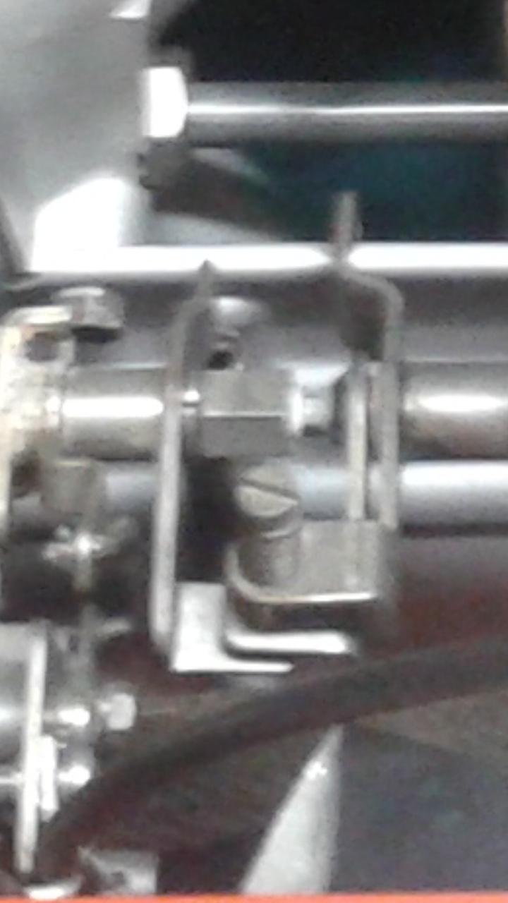

  The engine has to be drawing more air to increase revs. Have you checked for vacuum leaks? The pistons should be difficult to lift, They will rise slowly with constant pressure and drop much faster with an audible tap when they hit bottom. Heavier oil delays the piston rise during acceleration which acts the same as an accelerator  pump. The nozzles must return to the top when the choke knob is in the off position. Misadjusted cables are often the cause but frequently the flat bar linkage that pulls the nozzles down needs a bit of twist to precisely align it's mating surfaces. Lube the pivot points and the exterior of the nozzles with lithium grease.
Those "flats" on the linkage next to the carbs have a certain way they stack together. I rebuilt my engine and on first start up it shot up close to 2,ooo rpms with the throttle rod unhooked. Really scary. After I got those right it was fine. Hope you find the problem.
I haven't taken the linkage off before, so maybe the previous owner assembled something incorrectly. Thanks, I'll take a look.

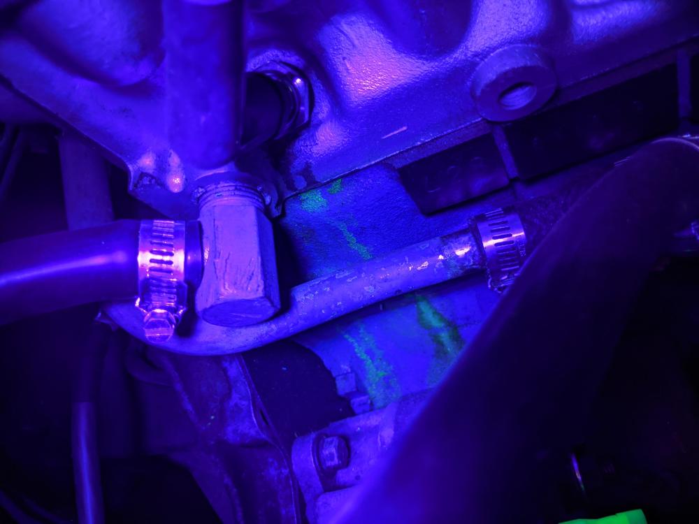

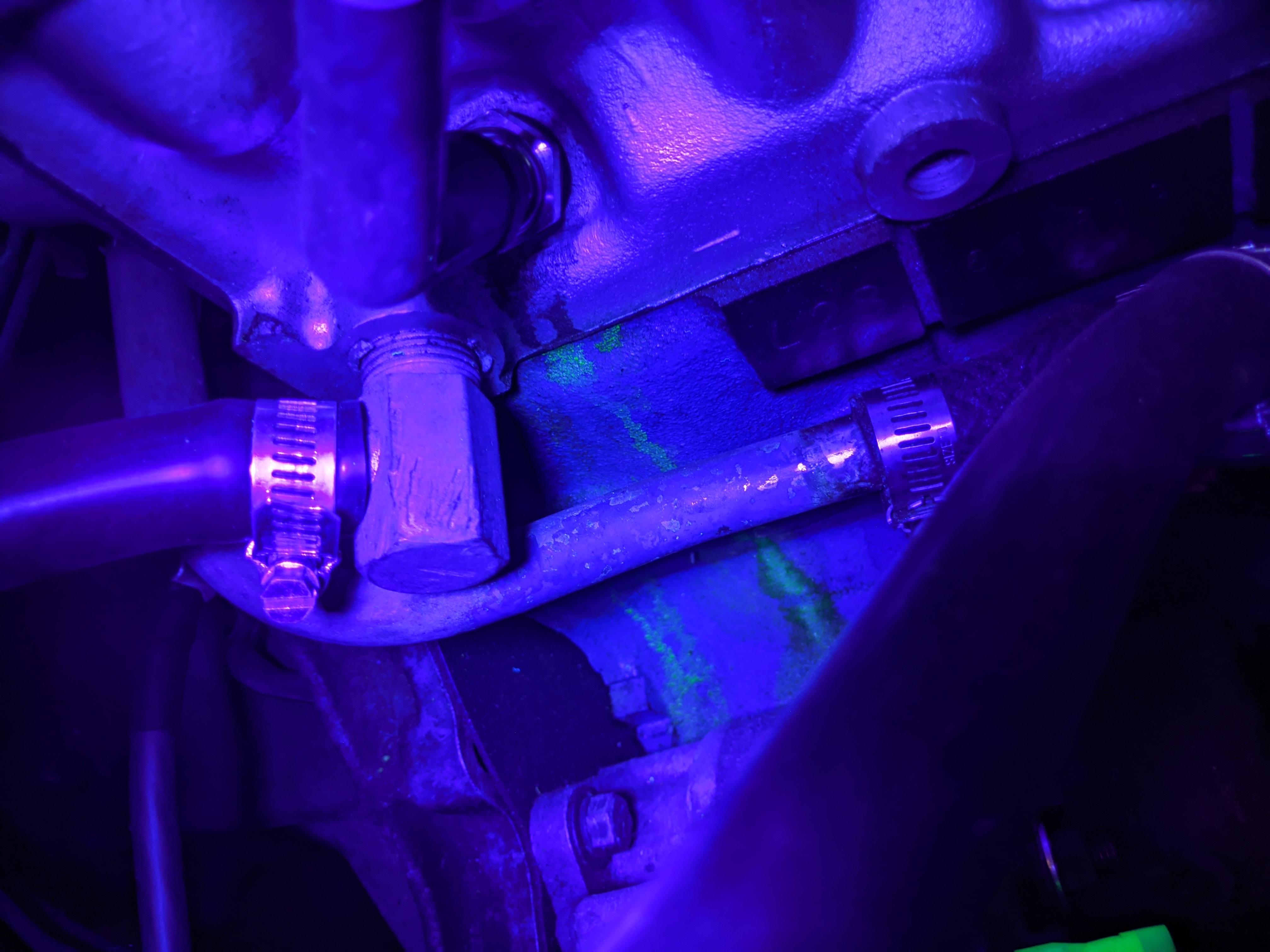

Are you using florescent blue coolant?  Maybe your camera took some Viagra.
That is a common area for a coolant leak.
