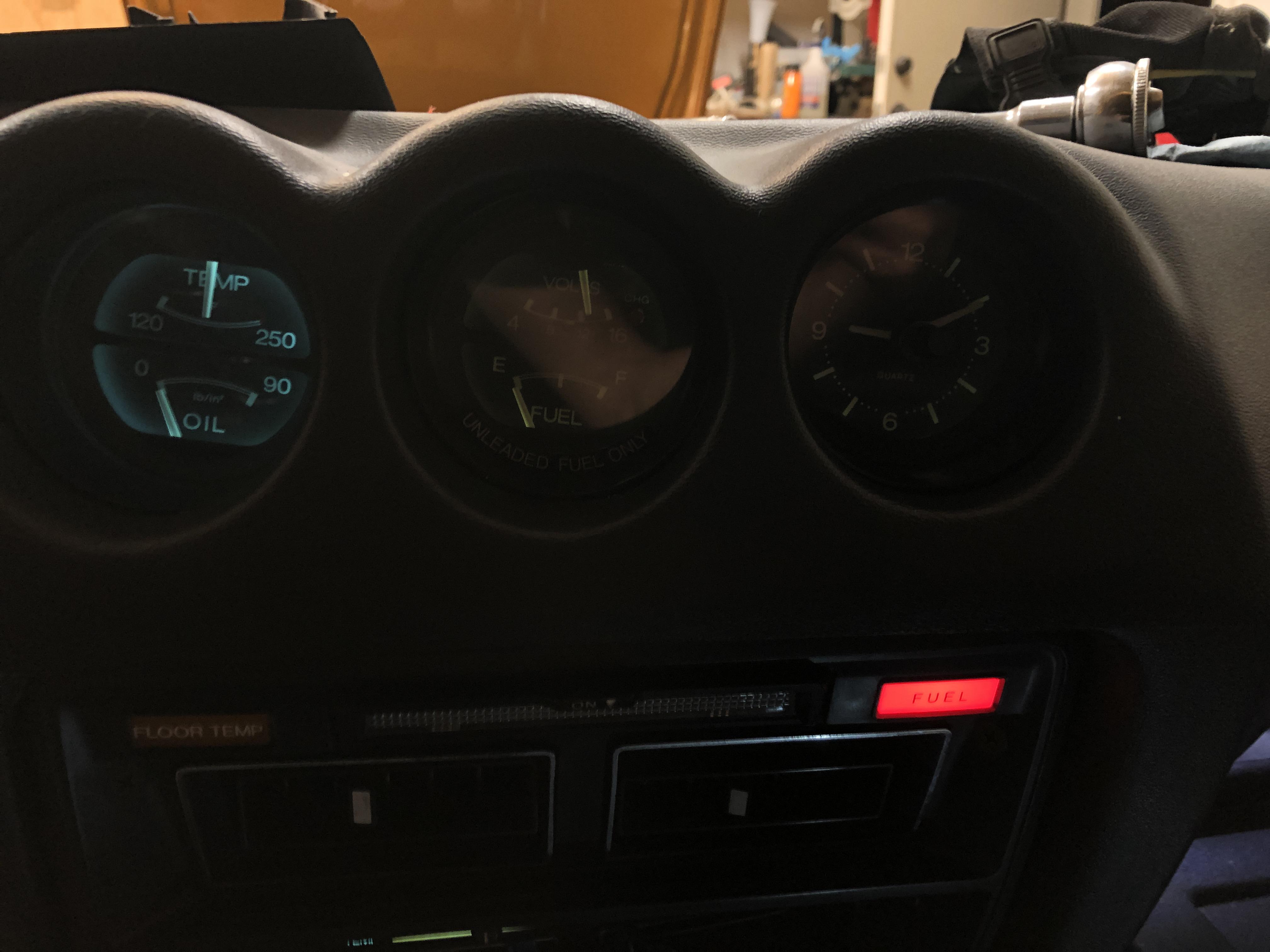

1977 280z "Fuel" warning light always on

when you work alone all by yourself... the car is simple but there are just so many little things.  It’s overwhelming and overlooked stuff.  Part ignorance, part just rushing through and omit stuff.   As you’ve notice on the brake issue, I’m so bless having such folk with a wealth of knowledge.  A second pair of eyes/ears/hands definitely a good thing.
regards
Thought to share the fuel light on when fuel is near empty.  It works beautifully. I’ve been chasing the running rich/powder/sooty on first 3 cylinder and kept an eye on th fuel light to see if it works inside the fuel tank. As the gauge dropped a bit to the left of near empty, light gradually brighten.  So cool.  Rushed to gas station to get another 2 gallons and fuel light is off. So nice when things work the way you expected.  Wonder how many gallons/mileages when the light is on?

geez this keeps coming up.
I would recommend you pull the unit out of the tank and bench test it with a 12v source and the light used in the car. could be you just have the wrong light, pulling too much current causing the thermistor to run away.
