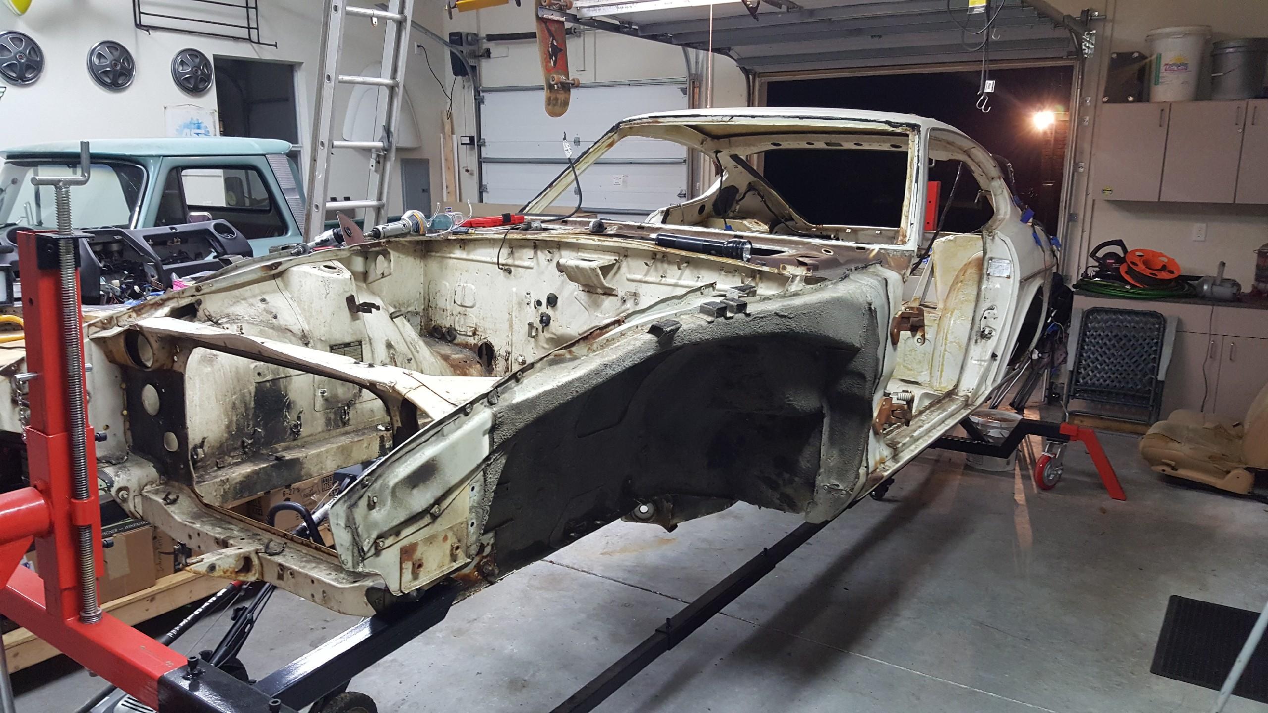

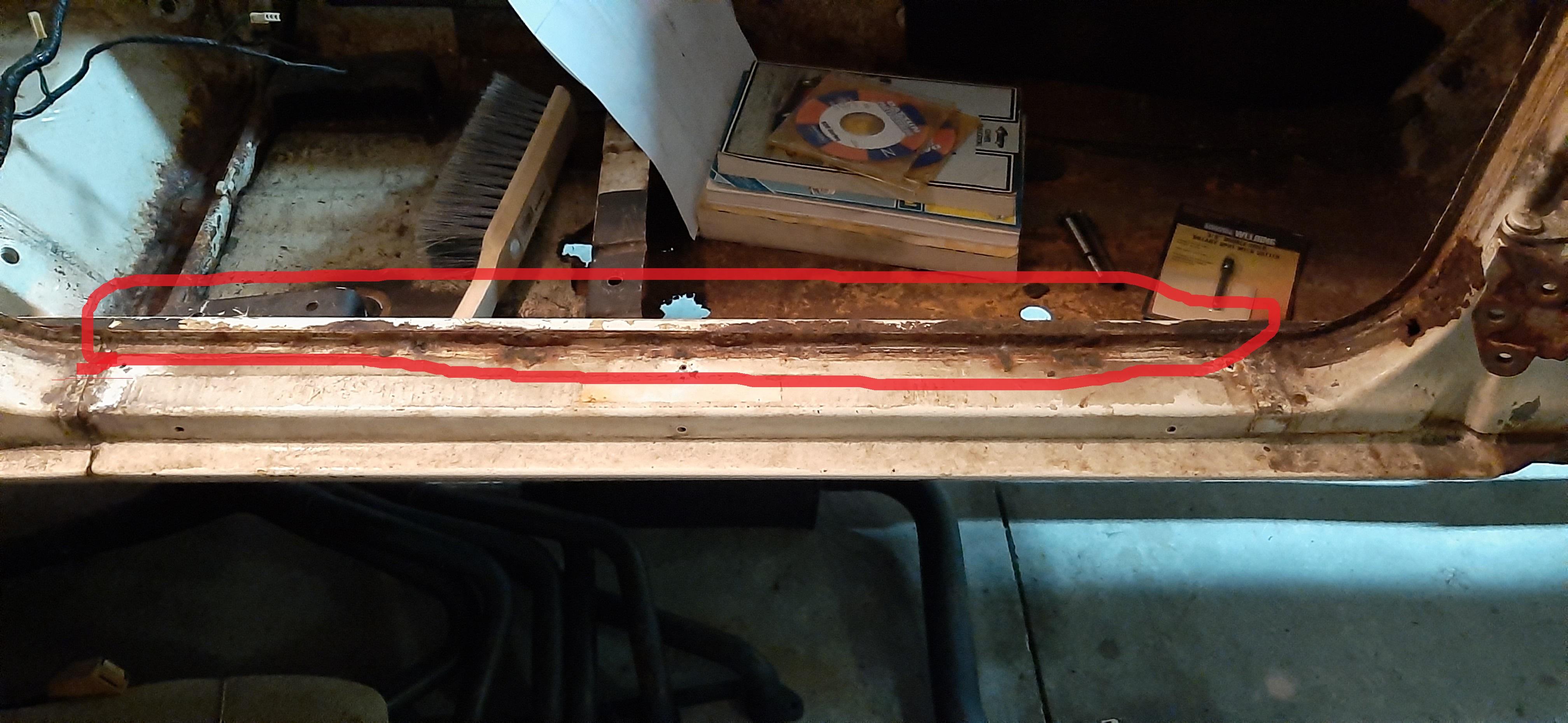

Posted August 15, 20204 yr comment_604221 Hi all, Is there an upper door sill repop available? I have significant rust on both driver and passenger side where the thin vertical piece where the door closes. It looks like a gnarly repair if you were to start cutting it out and fabricating it. The car is on a rotisserie. It looks like there are a few joints there from the inner door sill and outer. THanks all. Edited August 15, 20204 yr by DC871F Link to comment https://www.classiczcars.com/forums/topic/64342-73-240z-upper-door-sill-repair/ Share on other sites More sharing options...

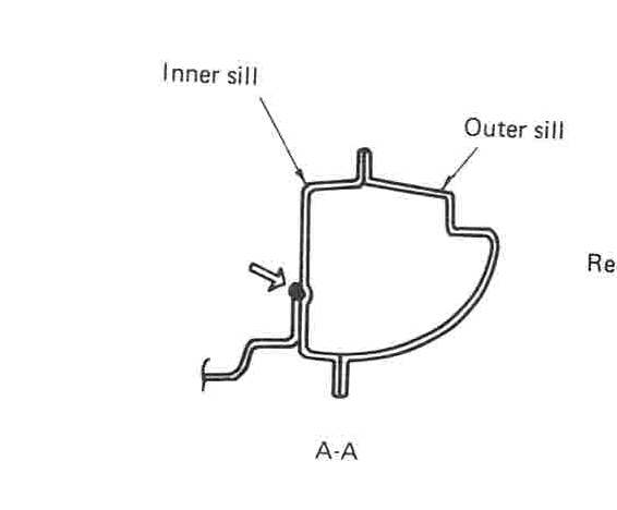

August 15, 20204 yr comment_604248 As Dutchzcarguy mentioned, the 'Body' chapter of the FSM contains sectional drawings for most of the Z's key sheet metal assemblies. Here's the one for the rocker/floor assembly: Link to comment https://www.classiczcars.com/forums/topic/64342-73-240z-upper-door-sill-repair/#findComment-604248 Share on other sites More sharing options...
August 15, 20204 yr Author comment_604249 3 minutes ago, Namerow said: As Dutchzcarguy mentioned, the 'Body' chapter of the FSM contains sectional drawings for most of the Z's key sheet metal assemblies. Here's the one for the rocker/floor assembly: Perfect, thank you. Just visited Klassic Fab, they have the sills. Link to comment https://www.classiczcars.com/forums/topic/64342-73-240z-upper-door-sill-repair/#findComment-604249 Share on other sites More sharing options...
