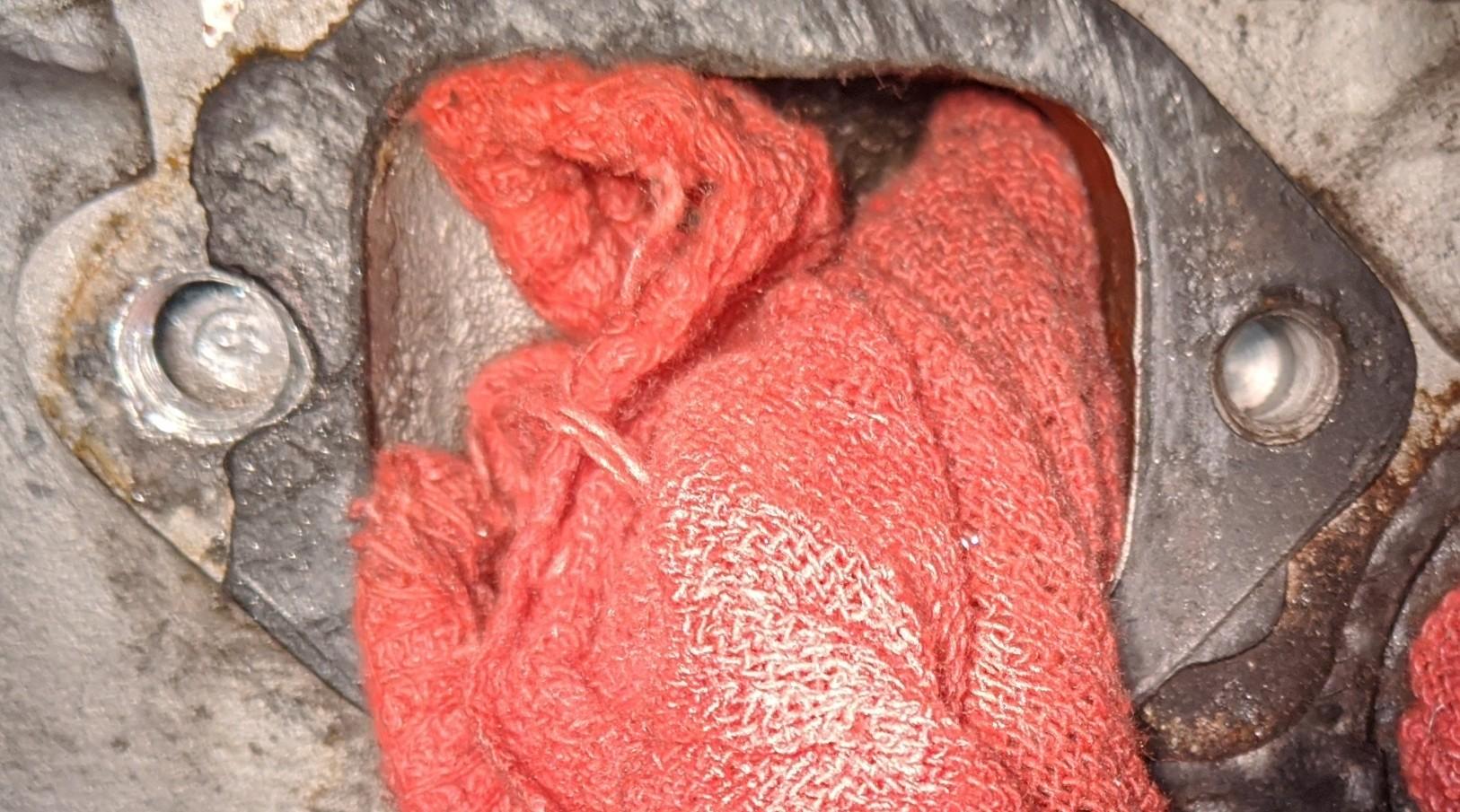

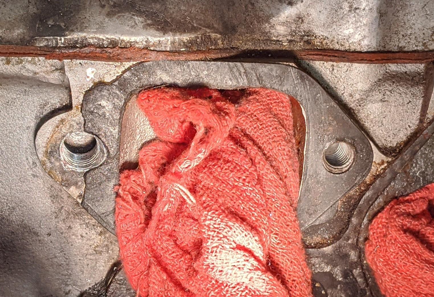

Wound up having to drill out the broken bolt. It has probably been in there decades and was fused in.  Had to tap a 3/8" fine thread into the old hole. Key there is to get the same angle so that the thermostat housing sits flush.  New thermostat housing should arrive today or Monday, so fingers crossed.
I was wondering what that was behind the left bolt hole. At first I thought it was a coolant jacket around the engine or something. Here is a pic. I went into it slightly when drilling, but not when tapping threads. Hopefully it's still in the right position.
