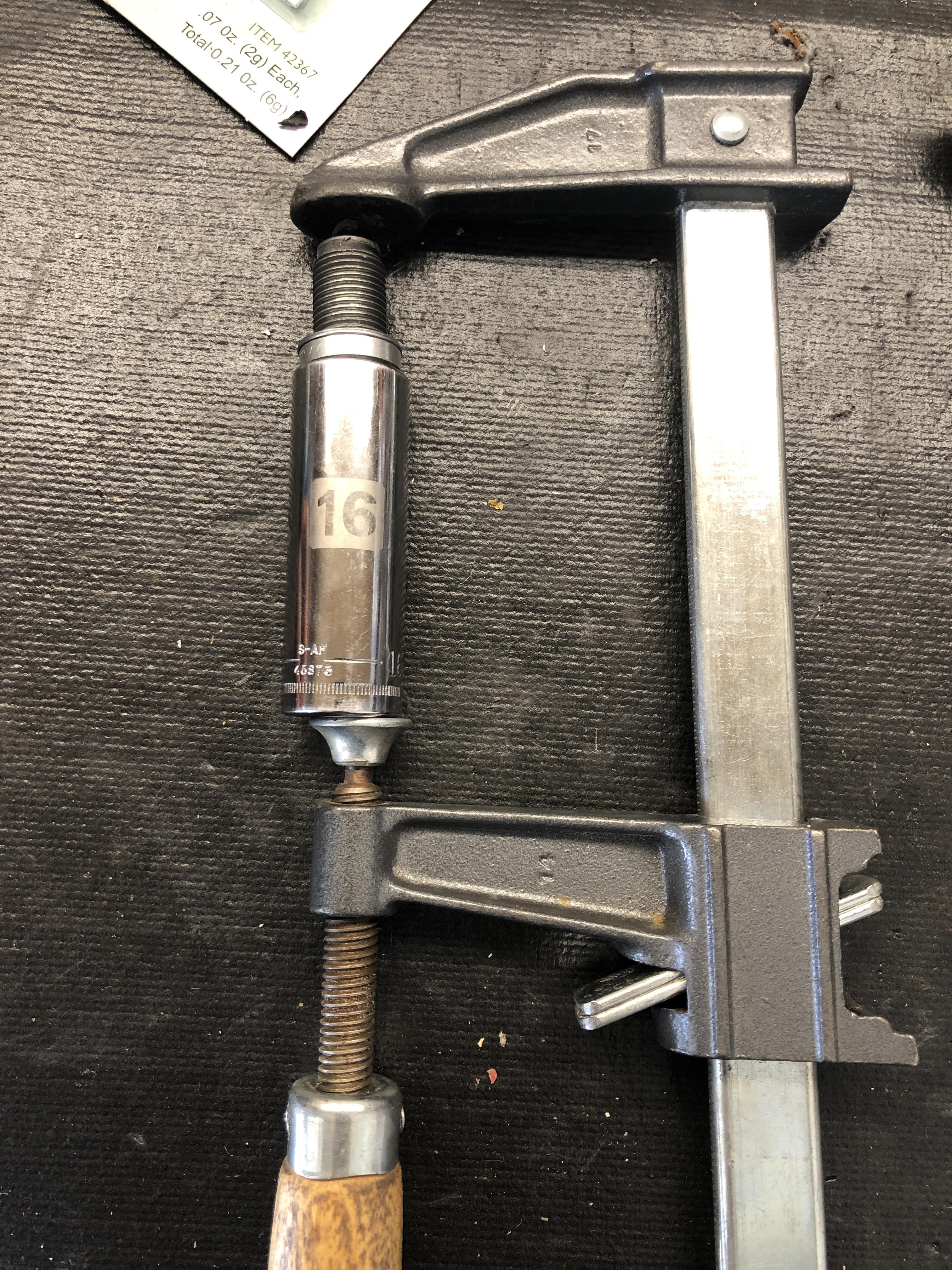

Adjust the spark plugs gap to 0.039.  Was about 0.045 or so.  Will get the proper gap gauge tomorrow.  Checked the resistance of each spark plug wire and approx 7k ohms. Well with in 30k ohms by FSM

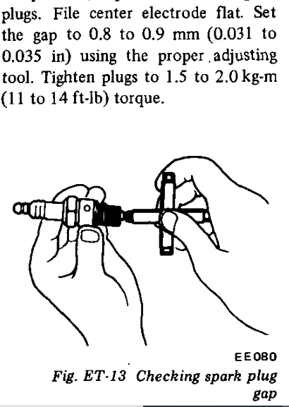

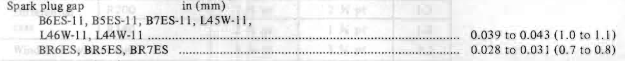

Here's some confusion, for me anyway.  I had always assumed that the ballast resistor was used because the ignition model did not use current-limiting control.  And without the ability to "fill" the coil the spark plug's  gap was smaller.  And that it was spec'ed larger in 1978 when the better ignition module was introduced.
But, here is the actual specification from the actual 1977 Owners' Manual, with 1977 on the cover.  I don't really know what to make of it.  It seems to imply that plugs without resistors will fire across a larger gap.
Also note that Nissan did not recommend the projected tip plugs although many of use use them.  Nissan recommended the P tips, then they didn't then, they did again for the ZX engines.

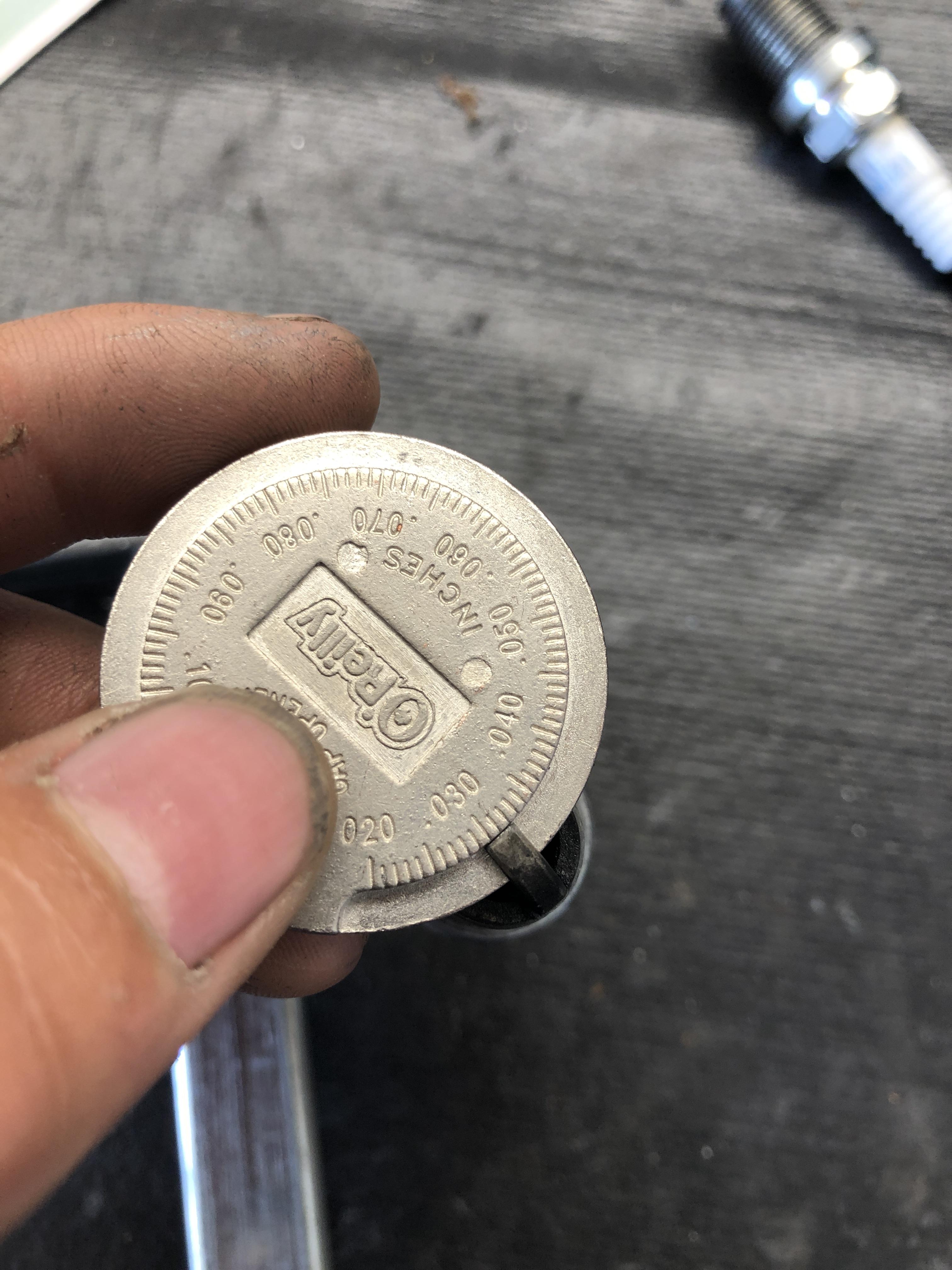

i don’t have the fancy tool like this one
Use a sled hammer probably over kill, although at time it is really satisfy and justified ... so I used a clamp and a sockeat to do the job.
gently turn the knob/handle and check the gauge.  Do it couple of times and you’ll master it.  I know it is not conventional and probably outright wrong. Got to do with what you have.

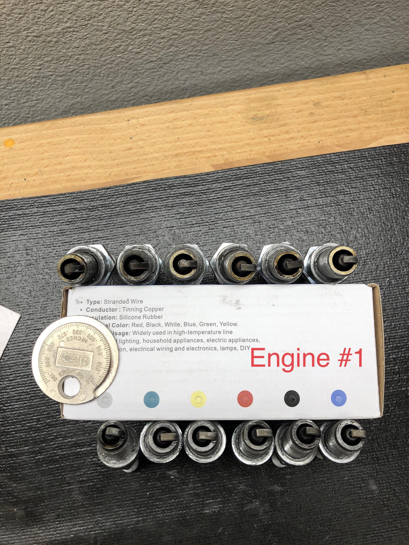

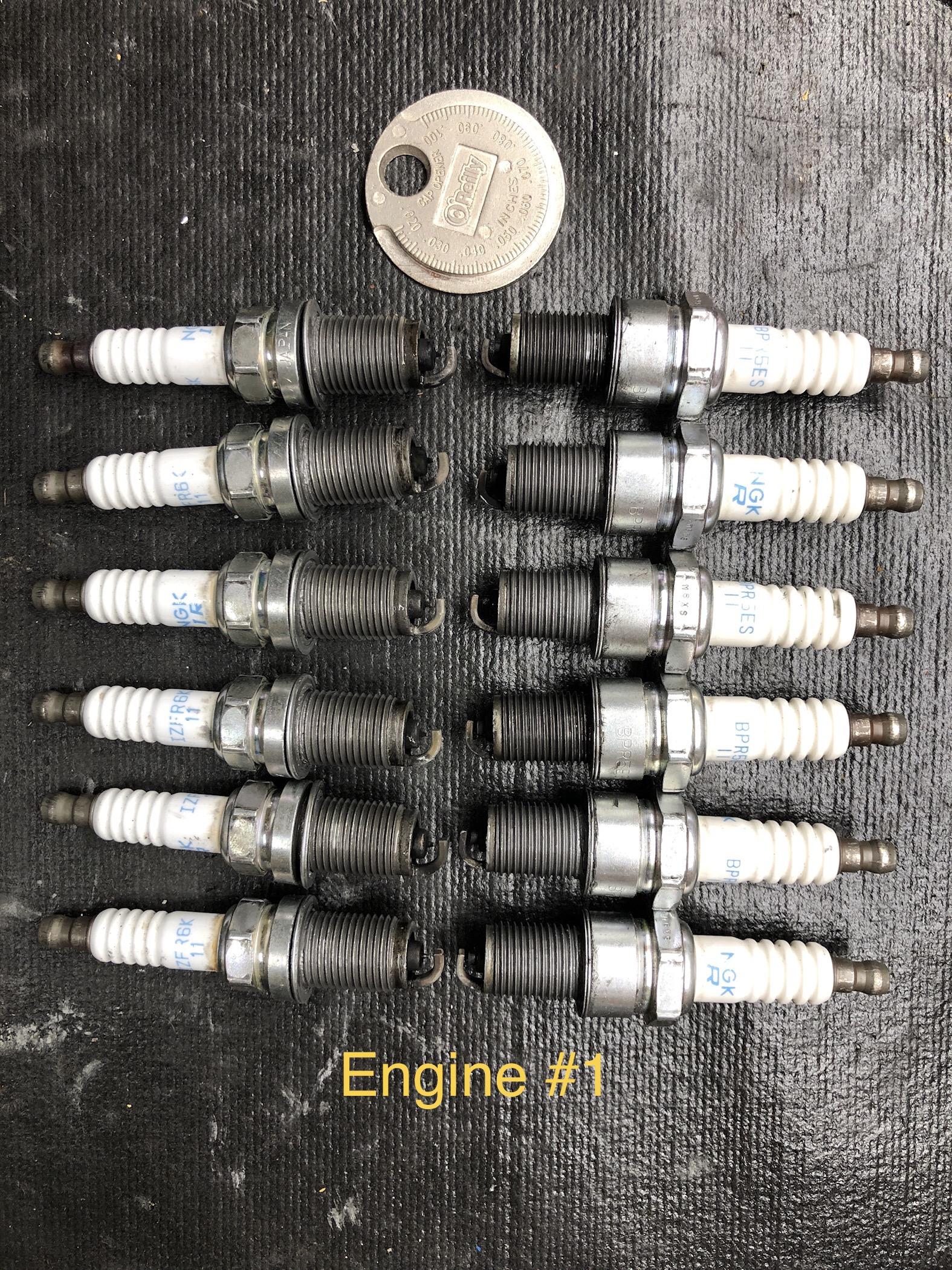

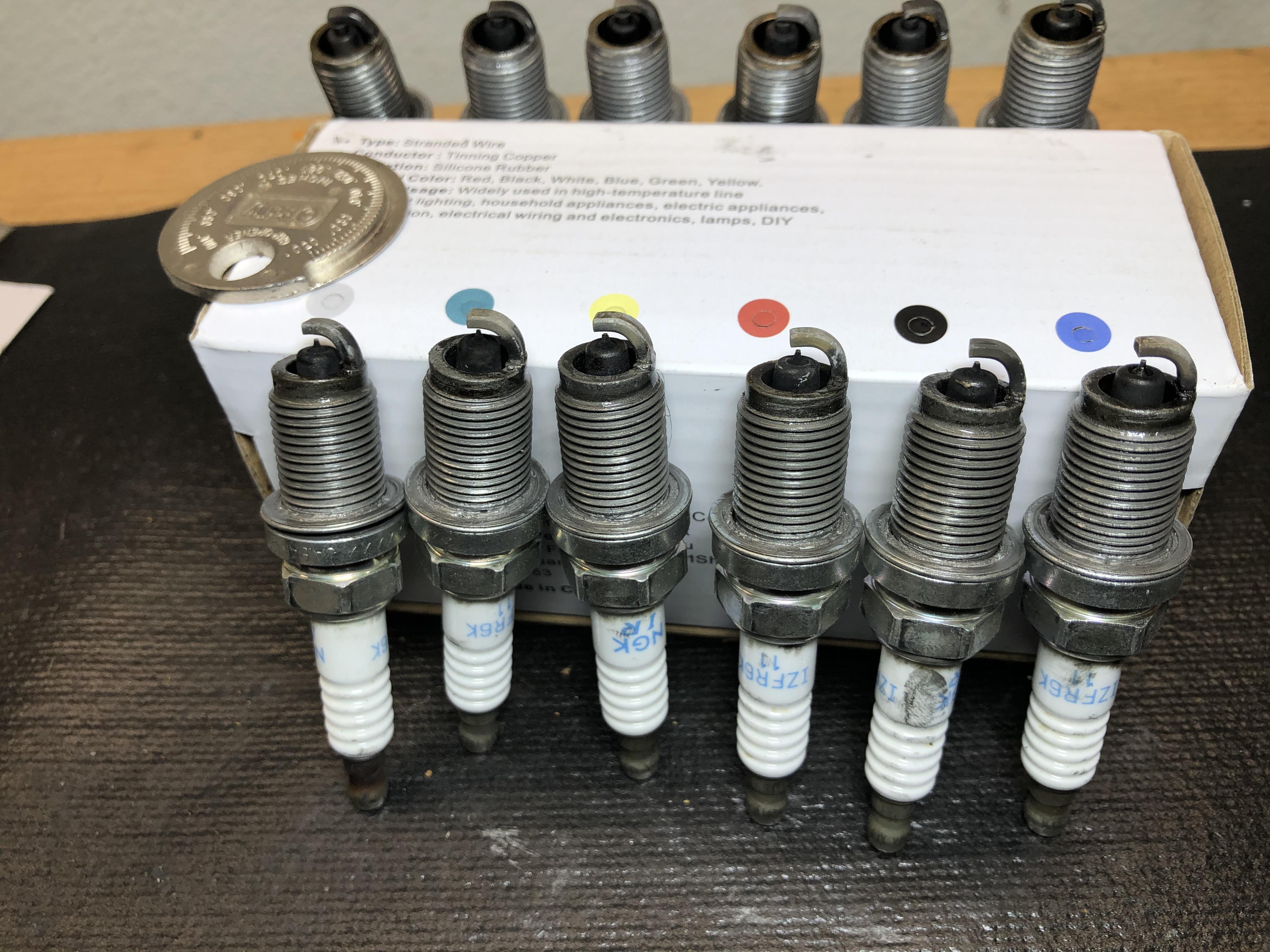

i did 2 experienced with Iridium and BPR5ES. Each ran idle and some rev here and there for 30 minutes.  All engines fired as I pulled the plug individually and RPM dropped as expected.  Retarded 10 degrees with idle approximately 850-900rpm.
no more sooty/powder smog on any spark plug. Please see the pictures.  I think it is still run a bit rich or just right.  When I replaced my sedan, the plugs much drier and whiter if that describe it. But again, the plugs in my other sedan ran for 80k miles. Can’t compare to this.
i think the BPR look cleaner than the Iridium.  I sniffed smog on both set of plugs (Use all senses, stupid me but got to find a way ...) and definitely not as strong as before.
