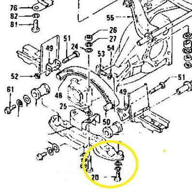

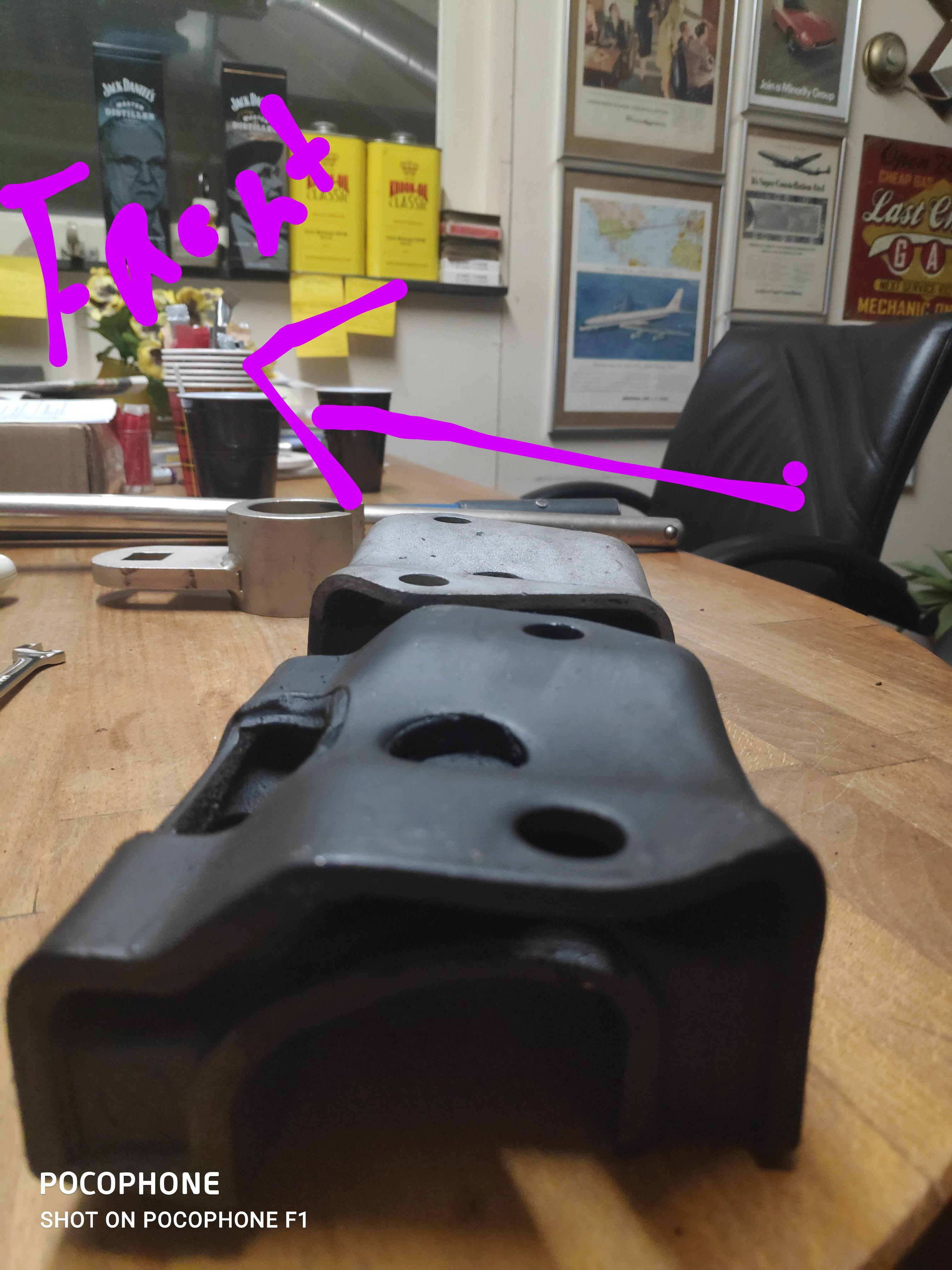

Are you sure, because my early one, the front of the car is as I pointed in my picture above with the arrow. This drawing also shows that.
So with the later one, which side is pointed towards the FRONT of the car ?

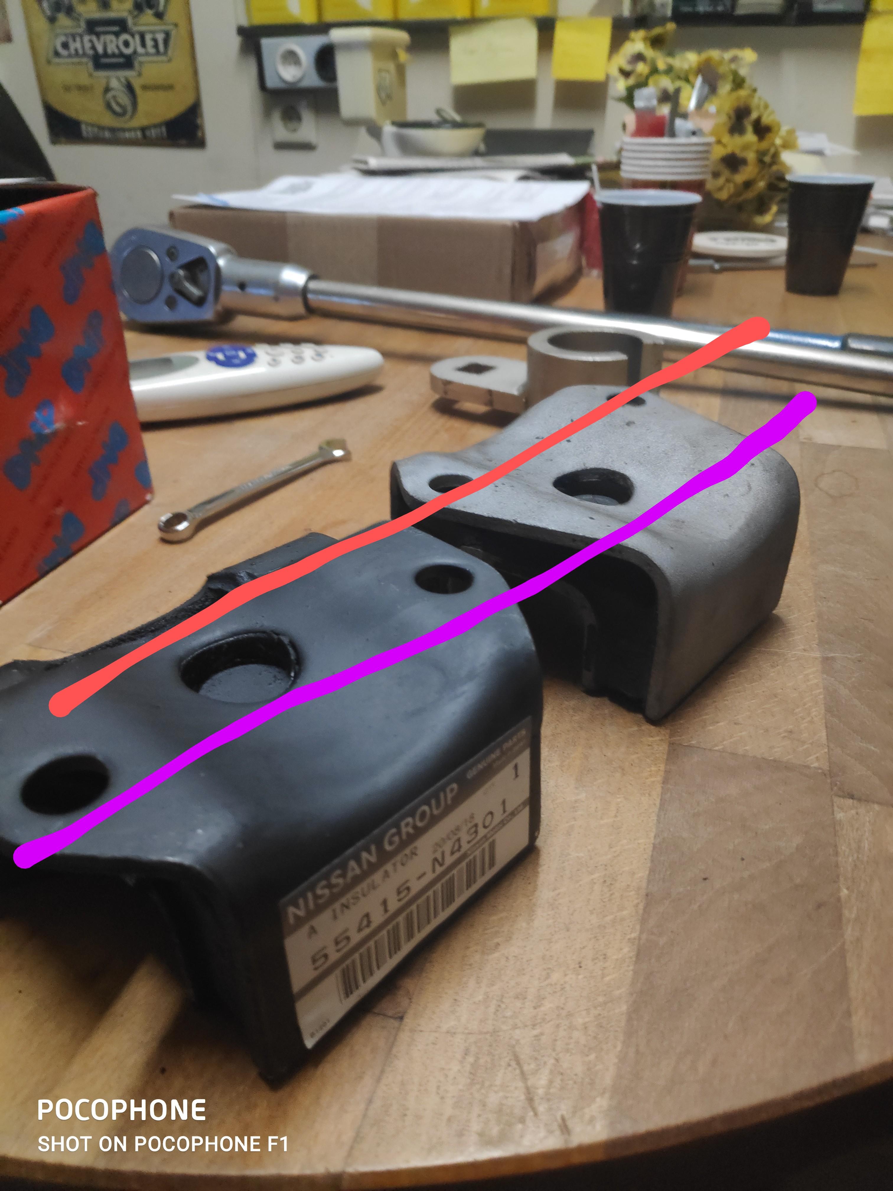

My later type is showing part no 55415-N4301 20/08/18

I remember trying to find an illustration for the diff mount and the transmission mount.  The best I could do was to assume that the mounts go in with the sloped side facing forward.  Like a snow plow or a wedge.  I only found one picture that showed that and had to rationalize that the diff mount would be the same.
It seemed to make sense when I was actually looking at the parts before installing.  Here is the only picture that seems to illustrate that, from 1976.  Nissan calls the transmission mount the rear insulator.

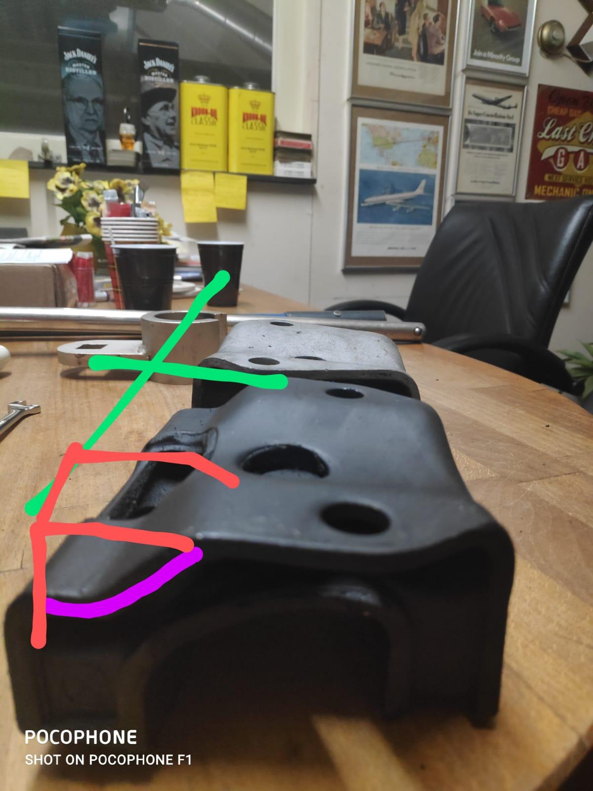

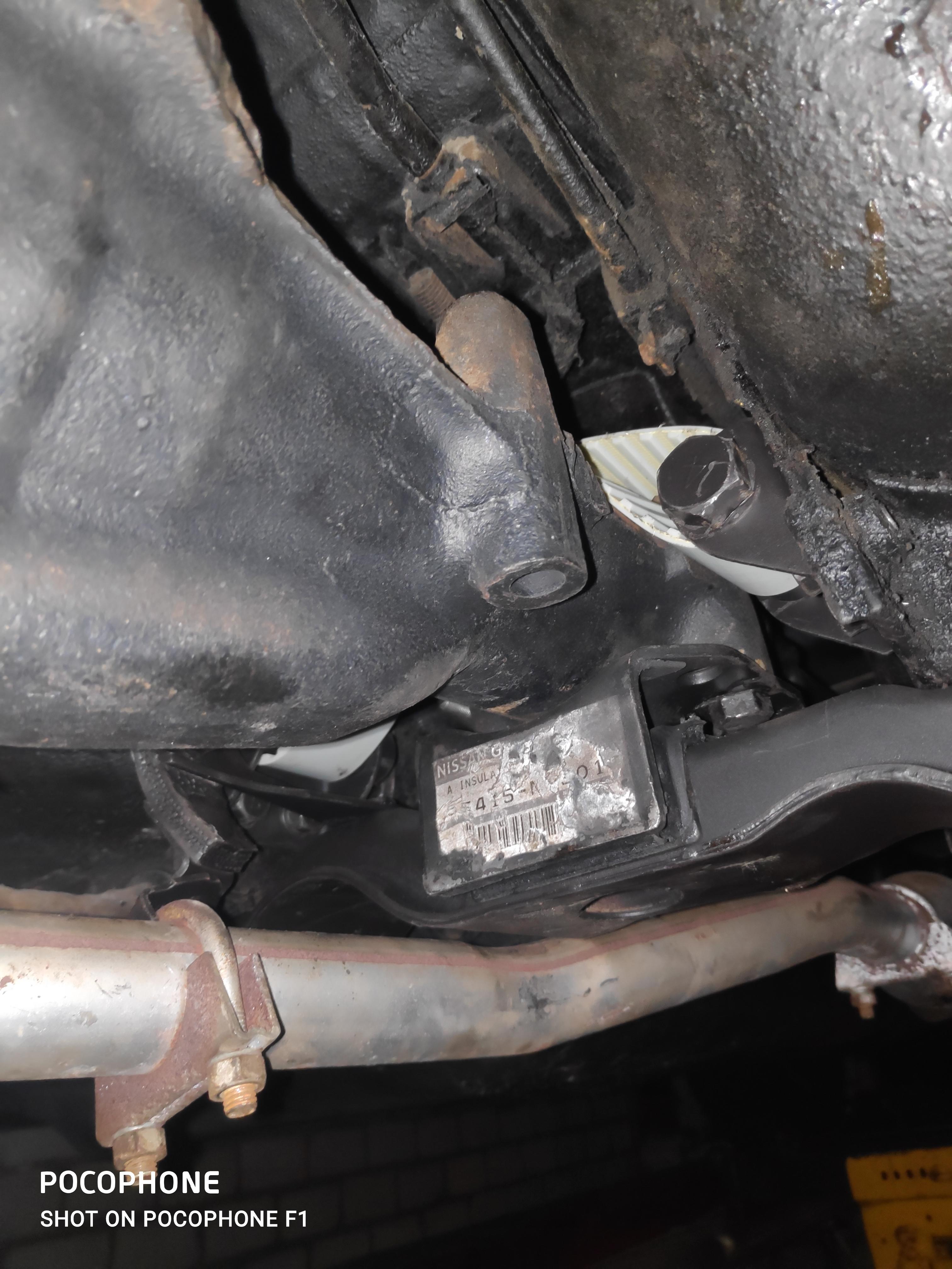

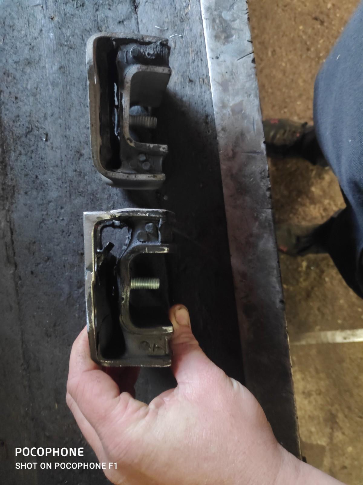

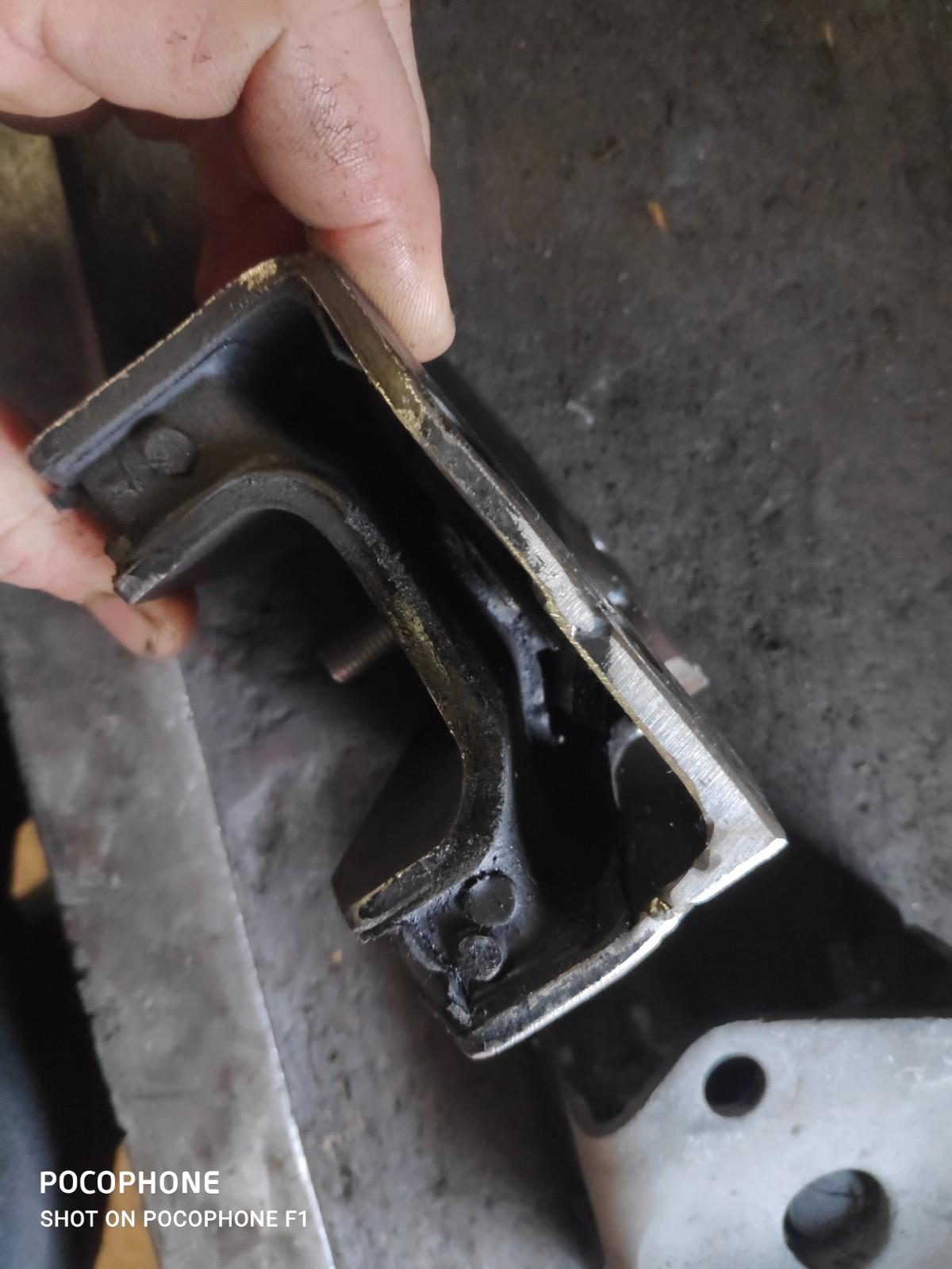

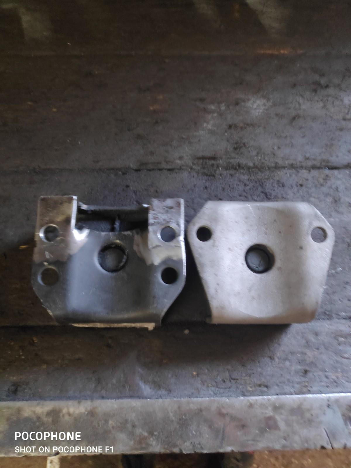

Yes..  The later diff was placed back due to vibrations problems, as I read. So if you look at below picture you can clearly see the later mount holes showing that, If I have them placed correctly now, which I assume. If not somebody correct me.

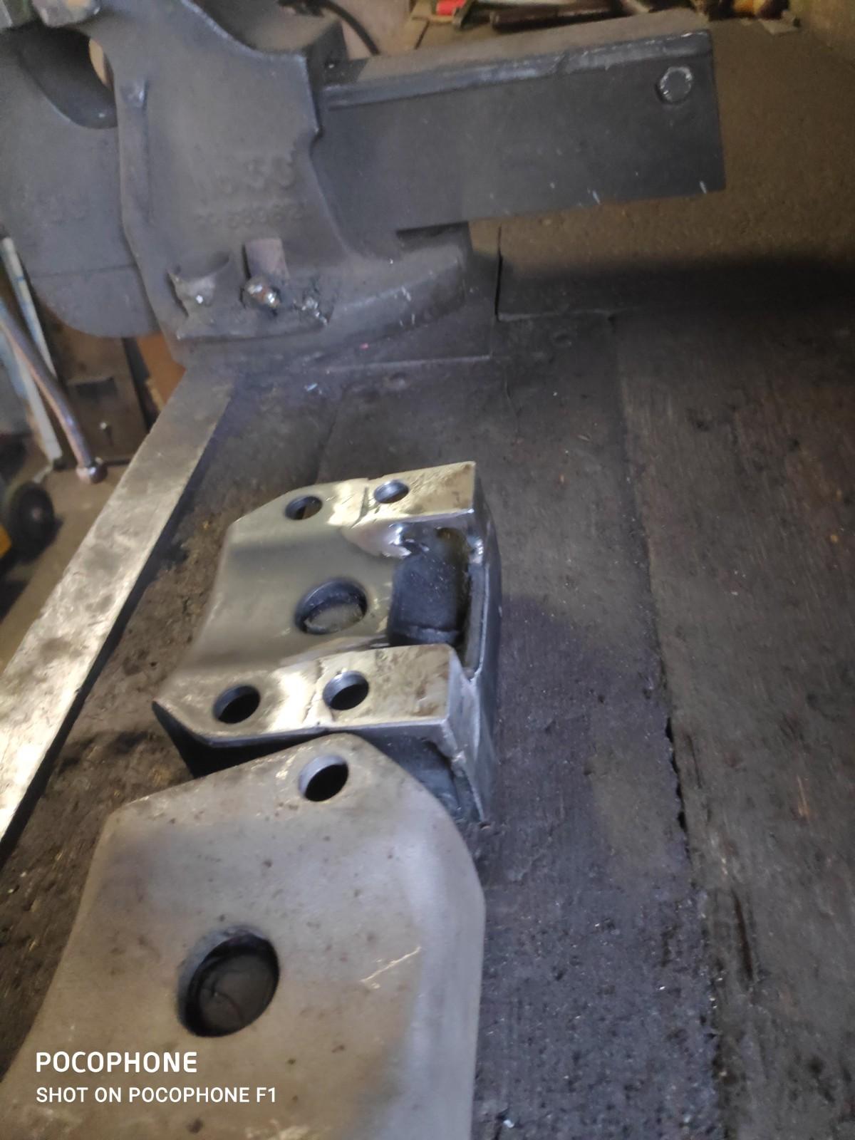

We did some brainstorming, including heaving the early one remolded, but that would be way to expensive, they will only do it from at least a 1000 pieces. So I decided to modify the later one, back to the early one. I think it worked out. I will test it to make sure, just waiting for the strap to come in first.
I cut the purple, and added to red, so the " slope " is the same, and the holes are on the same spot as the early one. With the purple cut out, you can now put the M12 nut under there.
I could not just simply twist the mount 180 because that would change the angle.. so this was the only way.
Welded the mount with the rubber part of it submerged in some water, so it wouldn't melt..

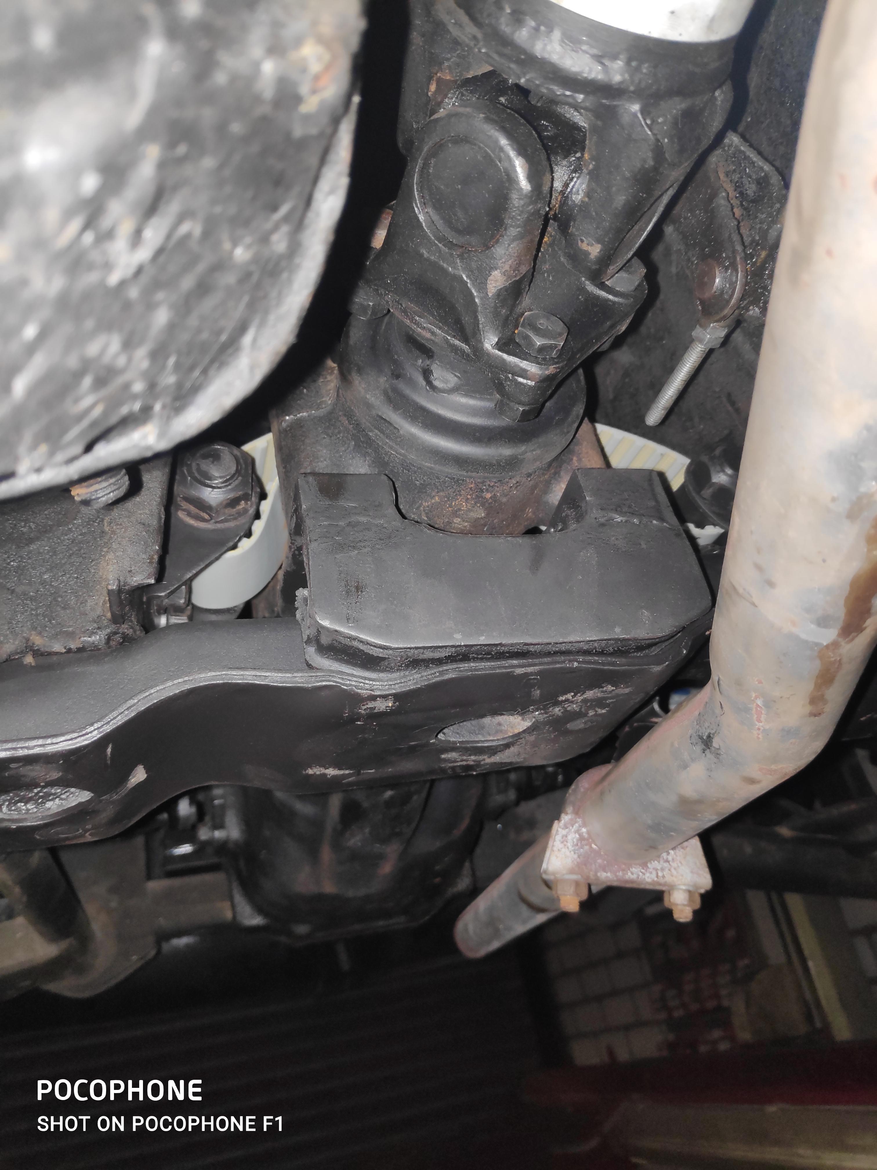

That diff belt looks like a toothed belt.. like a timing belt of a modern car..    The original belt is much  more robust and stiffer!
Someone sometime..  fell over that belt and thought: Hey lets use it as a diff arrester belt!   It has always been a bad solution to the problem and this is no improvement..
BTW my (Rest in peaces) 1972 240z had one and in good condition.) and my early 1971 does not have that at all!   Maybe someone has a better solution for this arrester belt as Nissan calls them?
That's a clever trick, I'll have to remember that one.  The mount looks like it will work perfectly.

See my pictures above. You cannot twist the later mount 180. Because it does not line up if you look closely at the picture. And it's also at an angle.

Thanks. Yeah it works fine now. Took some modifications.  So it can be done without going with all the hassle of changing the mustache bar etc etc to the later 72 spec

Well it's the same dimensions as the old one only a newer material and toothed So it should work Just fine ? I ordered it from the z store...
