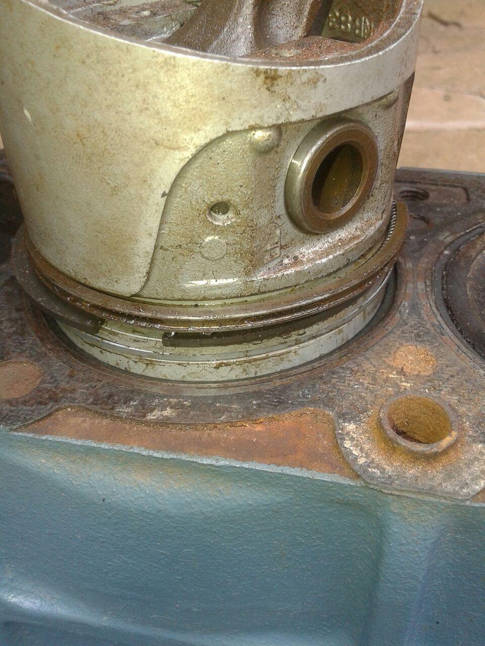

Wow!! That's awesome! . . . how can you tell they are oversized and not H2711? Are there advantages / disadvantages to this design change. Sounds like it was more emissions friendly. . . . Compression didn't change but a better burn?  Thanks again. . .
21 hours ago, HS30-H said:
AMPCO was/is a majority Nissan-owned affiliate company, making parts for use on Nissan vehicles.
Whilst the H2716 'Pop-up' pistons were not OEM on any S30-series Z, they were supplied by Nissan as a service replacement part on Nissan L-series engines. They are not 'aftermarket' or custom.
I’ve been trying to get info on these pistons for a while. I built an L24 engine with 1mm oversized Nissan pistons (with these valve reliefs) some time back and noticed these pistons were about .7mm above deck. I had installed the early E88 Head. They were no problem and worked fine, but my guess is with the stock gasket, they were close to being “too close” to the early head. They worked fine, no contact issues even at high rpm, but I see where 240260280 shows the service bulletin from Nissan saying they were “NOT interchangeable with the earlier cars”. I would imagine if too much metal was taken to “true” the block, there could be a contact issue. Any experience with these pistons being used with the early heads, and if someone was concerned with these pistons being too close, would having a machine shop shave the piston top say .5mm solve the problem? In other words, how much could you machine off of these pistons without affecting the piston?

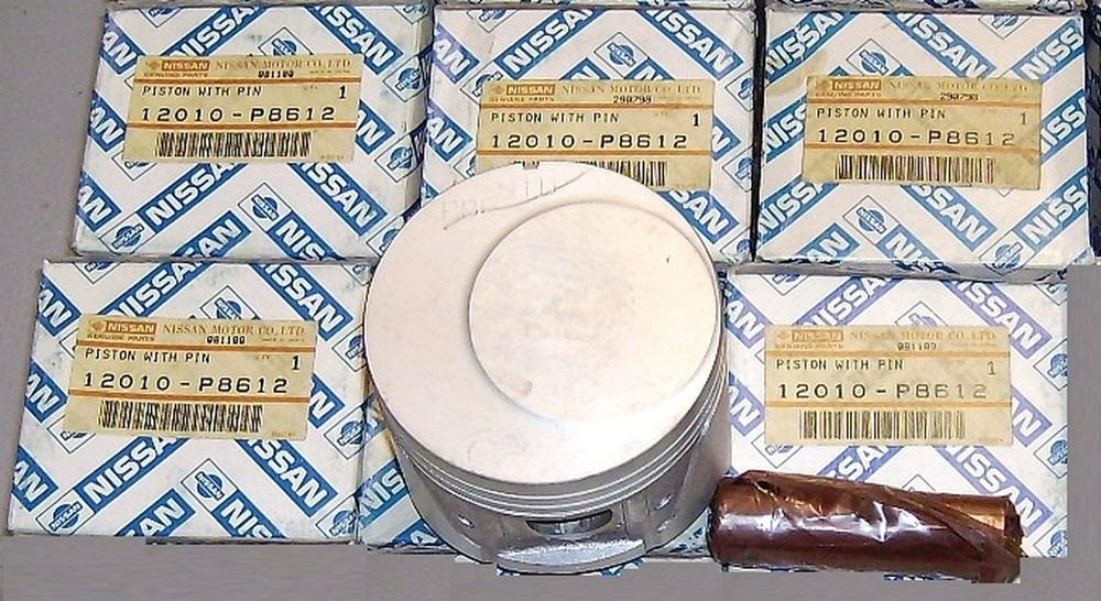

These are NOS (new old stock) 240z  original L24 pistons, they have no indents..    these are 1 mm oversize
Later on i red that they also fit L26 blocks..
(New pistonset.. in stock still. just 30+ years of dust and some lube on them..)  I also have a 1973 complete engine, so i could measure the diff. between those orig. and 1973 pistons, there should be a difference of 0.7 mm!
We posted at the same time.. both talking about the 0.7 mm diff..  haha..
No need to measure, 240260280’s post shows these pistons are .7mm taller, and I’ve seen that when I used these later pop up pistons. When you order replacement pistons from Nissan, this is what you get.....or got (not sure if still available). With allowable clearance varying from builder to builder ( most want 1 to 1.5 mm clearance), is .8mm clearance enough? It was in my build, but some may argue it’s not. My question is how much can be shaved off the top of the piston to reach a comfort zone of clearance in the early engines?
You'll have to measure, and make your own decision. Once you start modifying factory parts, that's the deal...
