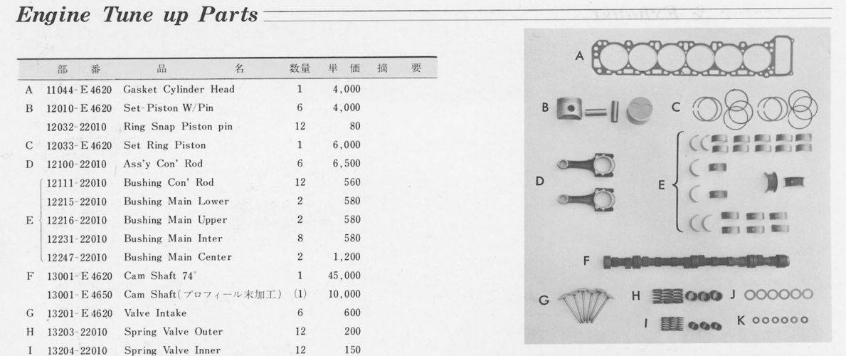

Here is Nov 1971 HS30 Sports Option Parts document excerpt showing fly cuts (B):

Hmmmm this is becoming circular.  In what markets were these pistons fitted?  I have not seen in the USA or CDN markets?

As I wrote before, this type of piston was supplied as a service replacement. I have not said anything about being fitted to stock L24 engines, in any market.
You seem to be hung up on the idea that piston relief cutouts = 'high performance'. But the 'Pop-Up' pistons were designed to intrude into the combustion chamber of particular types of cylinder head, and required the relief cutouts because this brought them closer to the valves. They are not high performance pistons per se.
