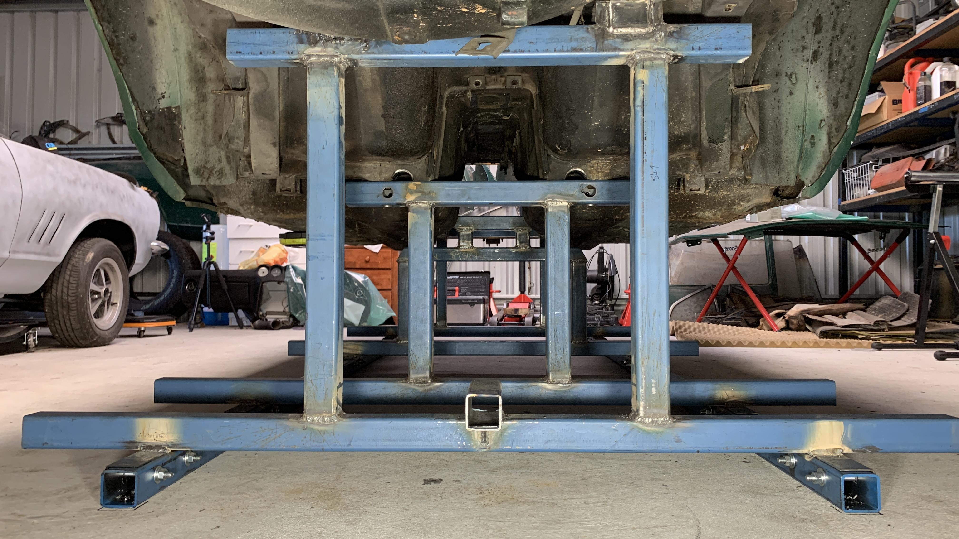

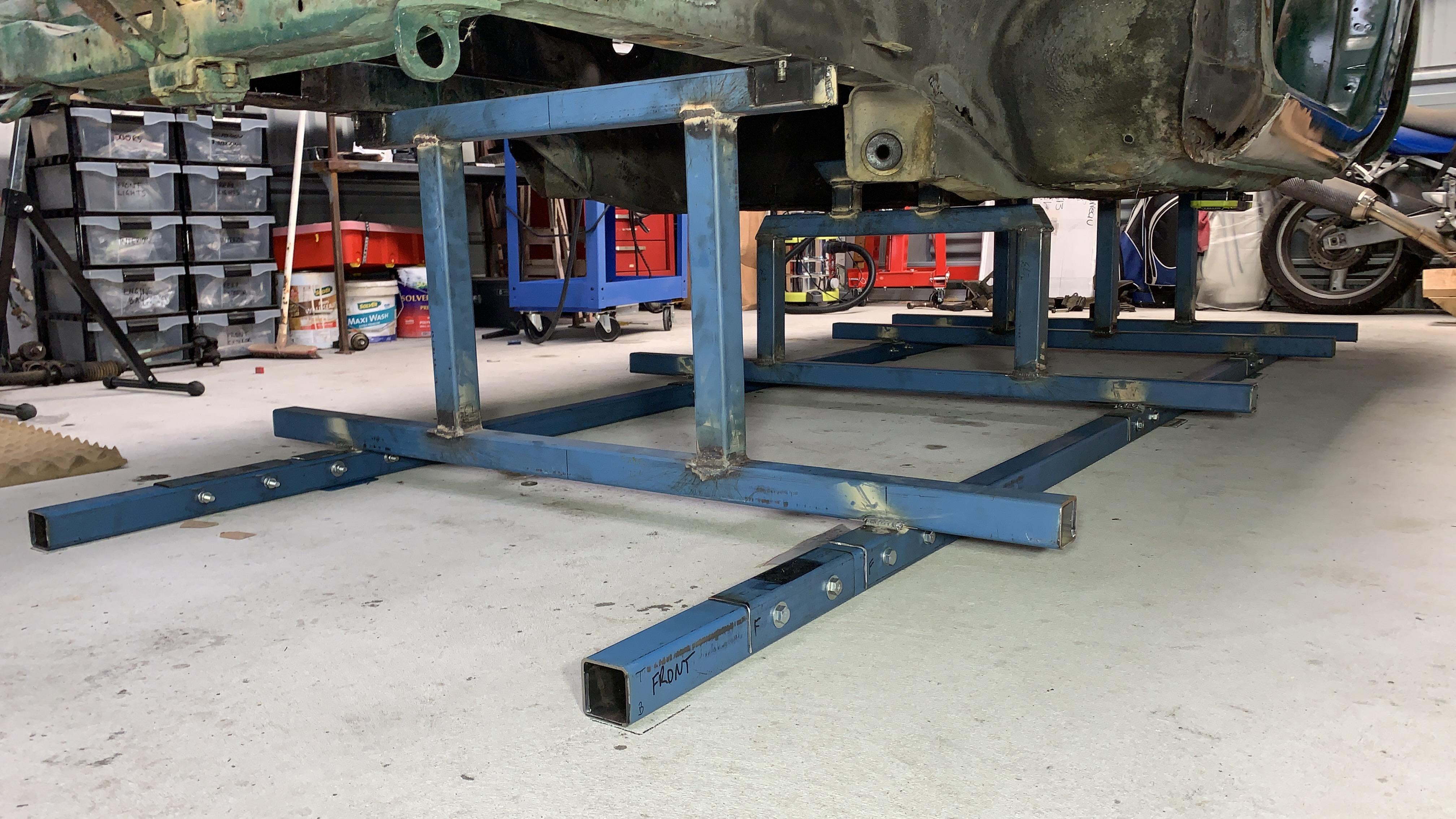

March 28, 20214 yr Author comment_618722 finally finished building the chassis jig after much toil. It was a journey in learning the basics of metal fabrication and has laid the ground works and basic skills I will need for my rust repairs. Pretty happy with the results considering I hadn’t touched a welder previously. Still much to learn though... As I will outline in the video I wanted to replace the backbone of the car, floors, chassis and frame rails prior to mounting on rotisserie for blasting. As you will see this will be impossible without extensive repairs to the rockers/doglegs and rears arches. So I have decided to get the whole thing blasted prior to starting any rust repairs. I will be bracing the shell extensively before mounting to the rotisserie. please excuse the cheesy thumbnail photo... Ryan Link to comment https://www.classiczcars.com/forums/topic/64416-240zbuiltbyme-1971-240z-hs-001063-project-georgia/?&page=12#findComment-618722 Share on other sites More sharing options...
March 28, 20214 yr comment_618734 Hey Ryan, Nice to see you do things in mm it's more accurate (Only my opinion!! Haha before i get half of the people here all over me! ;-)) But.... Take a look at vid on 7:54 min. you made yourself a lot of work.. Take out just the small part that is bad.. you also cut into the corners to far and also in the plate that is behind the piece you tried to take out.. You should also stay away from the door opening, if not very necessary! (Later on it will get you into trouble with the heat of welding.. all unnecessery!) Also if you take out a rotten piece, make the corners round you'll see that it's much easyer to weld a round corner than a 90 degree corner! (Use a big drill in corners) I did not see the whole video as i can't concentrate for a long time.. First blast the car to work on clean steal, then weld all corners and edges and stuff and then you can repair the bigger flat (read floor) pieces.. Maybe read a book on how to restore a car.. And the last thing i wanted to say.. you have to work much more precisely, again that part you took out of the dogleg, it's a biggy.. As the standing steel plate inside is completely rusted away you might think about it to take it completely out.. the dogleg.. But get it blasted clean first... i see a lot..lot...lot of work here.. (Ive done that myself once.. my car you can lift it on the doglegs (as it supposed to) it's strong inthere..) Link to comment https://www.classiczcars.com/forums/topic/64416-240zbuiltbyme-1971-240z-hs-001063-project-georgia/?&page=12#findComment-618734 Share on other sites More sharing options...
March 28, 20214 yr Author comment_618765 10 hours ago, dutchzcarguy said: Hey Ryan, Nice to see you do things in mm it's more accurate (Only my opinion!! Haha before i get half of the people here all over me! ;-)) But.... Take a look at vid on 7:54 min. you made yourself a lot of work.. Take out just the small part that is bad.. you also cut into the corners to far and also in the plate that is behind the piece you tried to take out.. You should also stay away from the door opening, if not very necessary! (Later on it will get you into trouble with the heat of welding.. all unnecessery!) Also if you take out a rotten piece, make the corners round you'll see that it's much easyer to weld a round corner than a 90 degree corner! (Use a big drill in corners) I did not see the whole video as i can't concentrate for a long time.. First blast the car to work on clean steal, then weld all corners and edges and stuff and then you can repair the bigger flat (read floor) pieces.. Maybe read a book on how to restore a car.. And the last thing i wanted to say.. you have to work much more precisely, again that part you took out of the dogleg, it's a biggy.. As the standing steel plate inside is completely rusted away you might think about it to take it completely out.. the dogleg.. But get it blasted clean first... i see a lot..lot...lot of work here.. (Ive done that myself once.. my car you can lift it on the doglegs (as it supposed to) it's strong inthere..) Hahaha thanks mm is much more accurate and you don’t have to work with fractions! I had no intention to patch the piece I cut out, (though I may just to practice!) it was to get a better look at the condition of the underlying skins, so yes I was a little nonchalant in my cut. if you have read my thread, that whole panel is getting replaced, I have the rear quarter tabco panel already and outer wheel arch. I’m not too worried. that dogleg panel I cut had been repaired previously so it may look like I cut layers underneath but it was the original skin that had not been cut out. Yes all the rust will be removed and patched do not worry. I have a very long road ahead of me and I will be an expert in rust repair by the end... next up for the car is build a rotisserie and send for blasting. Do appreciate all your advice! Ryan Link to comment https://www.classiczcars.com/forums/topic/64416-240zbuiltbyme-1971-240z-hs-001063-project-georgia/?&page=12#findComment-618765 Share on other sites More sharing options...
