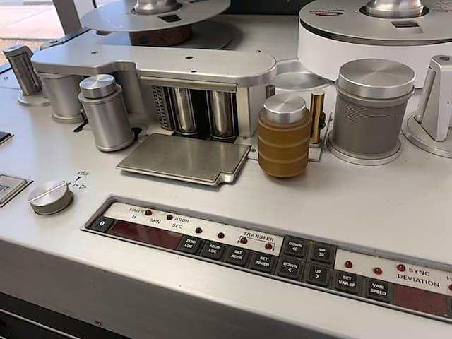

March 29, 20214 yr comment_618808 11 hours ago, Racer X said: You never measured out to 1/4 mm? Hahaha... thats 0.25 mm overhere! 😉 10 hours ago, Racer X said: At work we build airplanes to the nearest 1/1000th of an inch, but we express it as 0.001". I have to react to this haha... I once worked with studio equipment, still have some high quality stuff laying around and using some still after 34 years! (Look it up a revox b215 is one of those machines) I was once at the factory in switserland and they make capstanshafts on a machine that measures 1/1000 of a millimeter! (For big taperecorders like the ReVox PR99, Studer A800 etc.etc.) so 0,001 mm exact. They make the shaft and then have to let it rest for a year in storage. Then after about a year they put it in a machine that measures it and if it's out of tolerance ... it's scrap! Her you see a machine made in switserland (Possible also in Germany (Studer revox still in Germany activ.)) The capstan is a shaft that gives the speed to a tape, it's that dark shaft just peaking out on top of the beige pressureroller. A recorder like this is as big as a jukebox and costed a million swiss franks and thats about $600.000,- This was in the 1980's.. today they are much cheaper.. Edited March 29, 20214 yr by dutchzcarguy Link to comment https://www.classiczcars.com/forums/topic/64416-240zbuiltbyme-1971-240z-hs-001063-project-georgia/?&page=13#findComment-618808 Share on other sites More sharing options...
