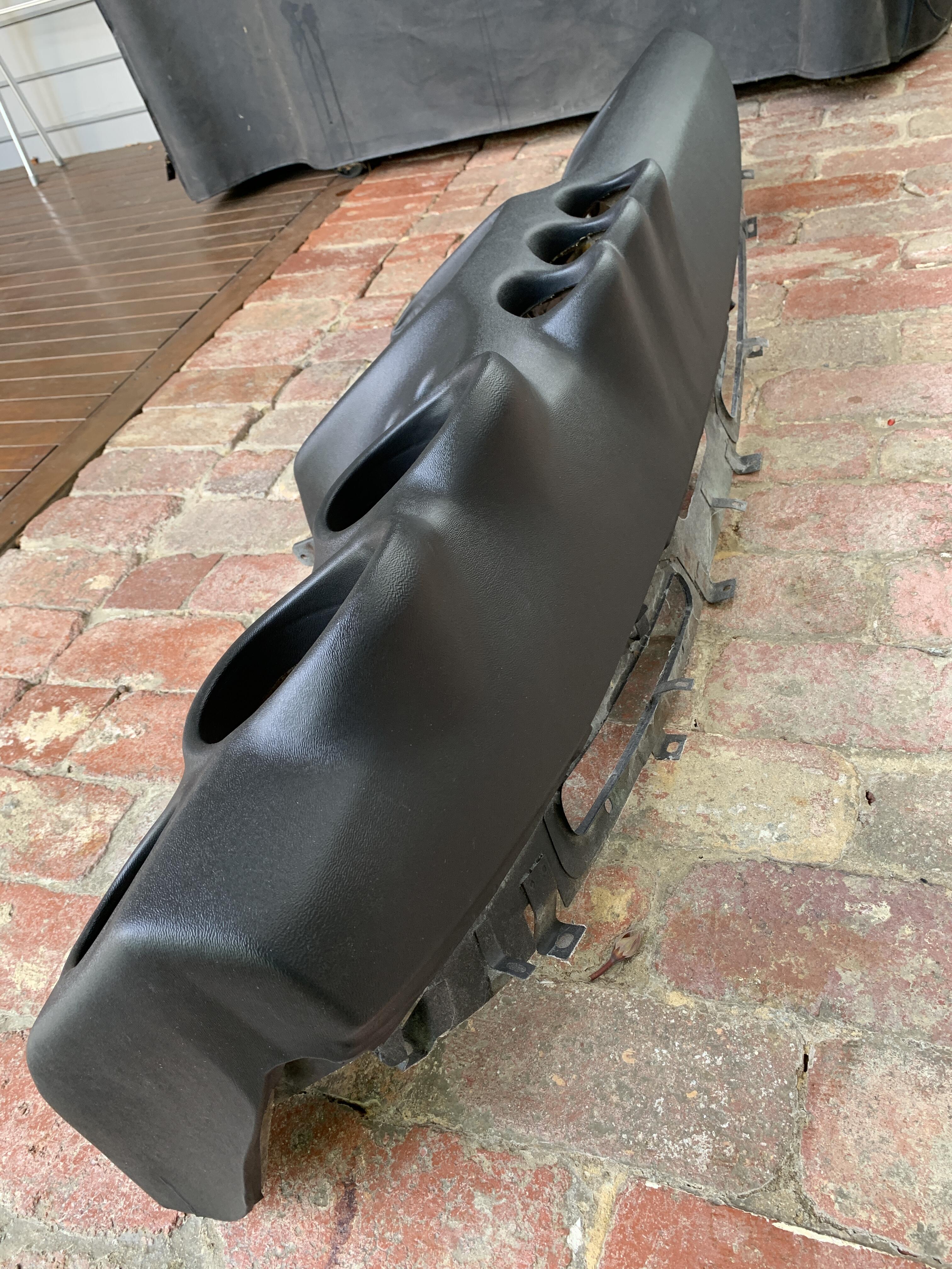

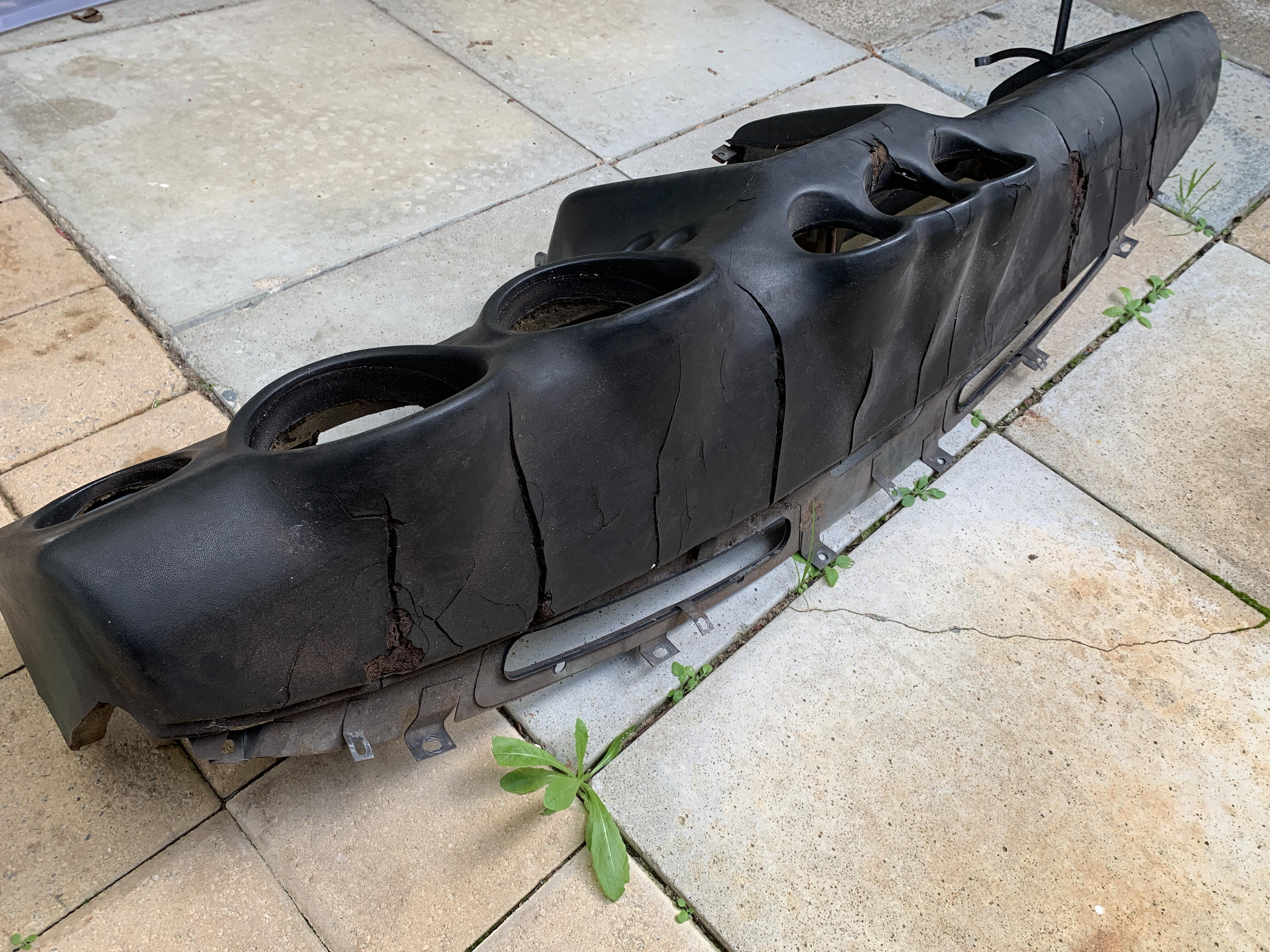

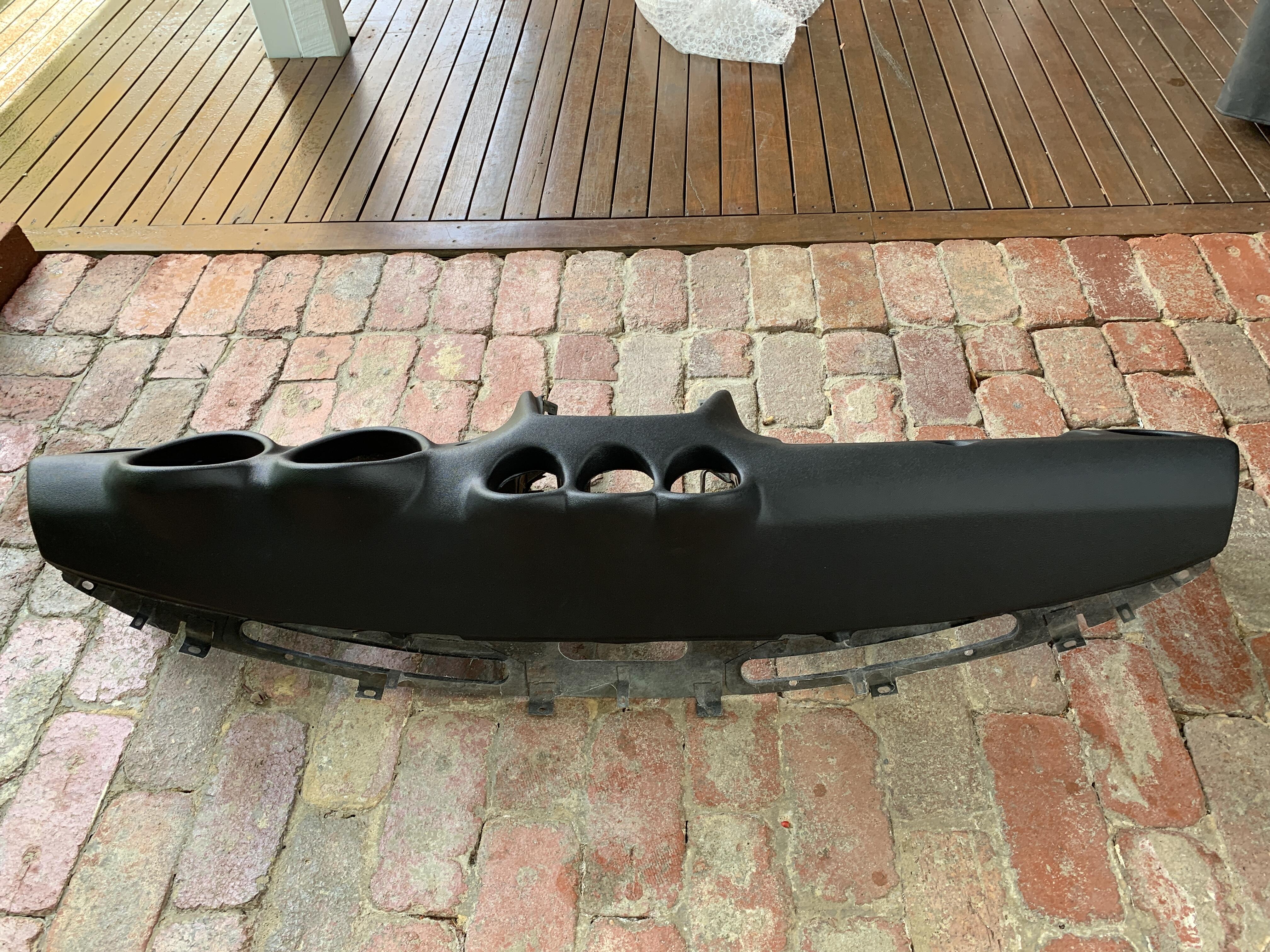

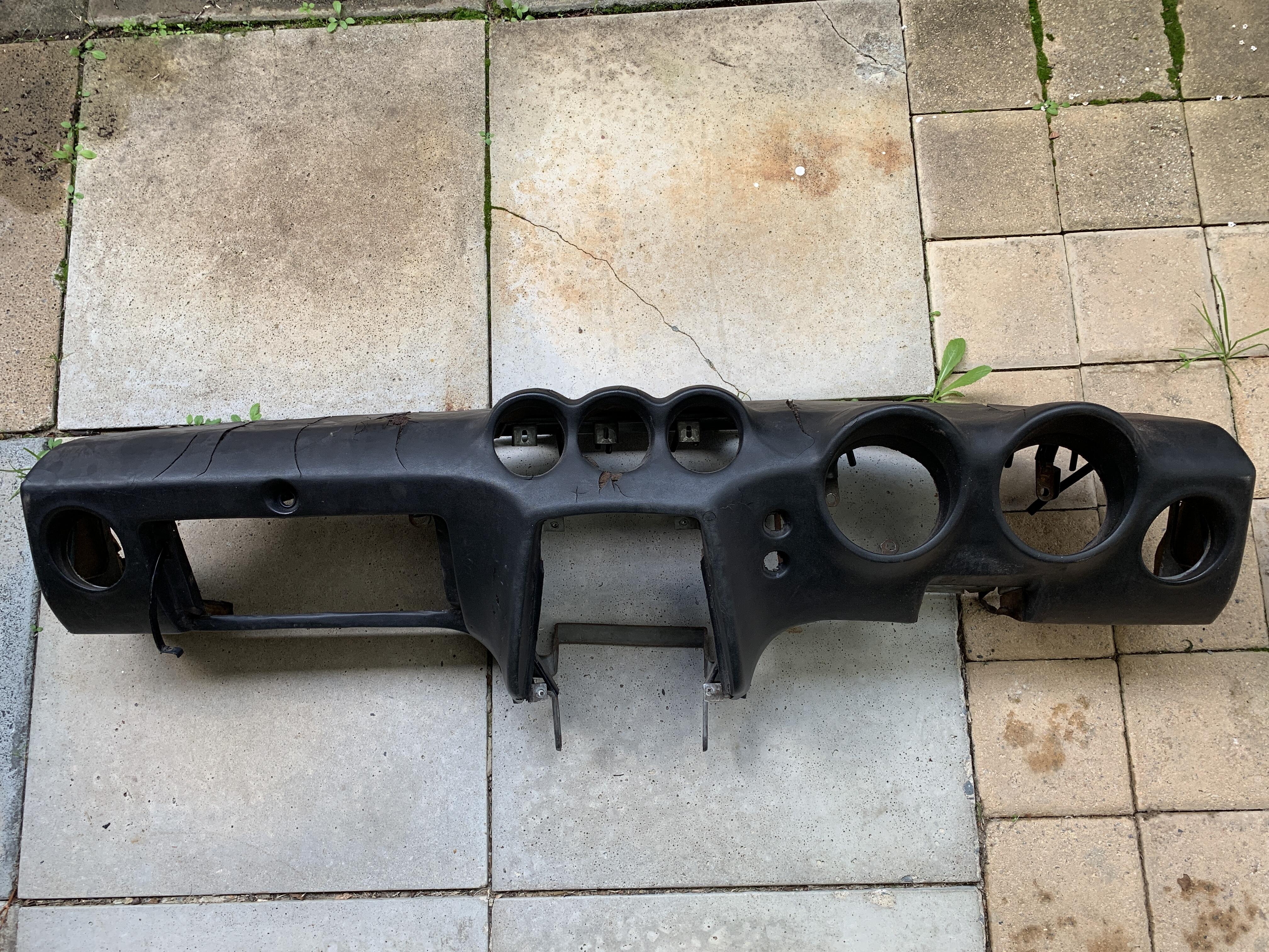

On 5/1/2022 at 11:40 PM, Namerow said:
Given that your location in Darwin is a bit off the beaten path, I'm curious to know who you used for the dash restoration work.
I’m actually in Perth. I used a local classic car parts store who also do dash restoration
Perth!  Well then, that explains everything:facepalm:
Your dash surface was pretty badly damaged.  It looks like the shop did an excellent job.  A bit of a head-scratcher, though, because this type of work typically requires a large vacuum chamber with heat treatment (steam, IIRC) in order to pull the new vinyl overlay down onto the restored form.  Did you get a chance to look at the equipment they use?
