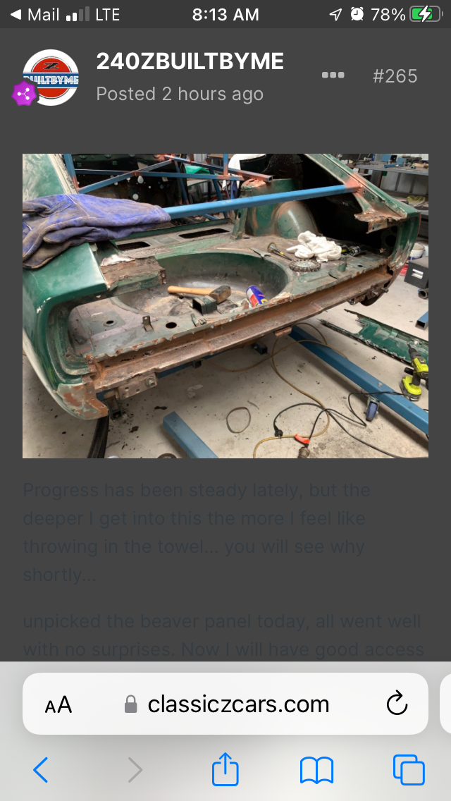

Progress has been steady lately, but the deeper I get into this the more I feel like throwing in the towel… you will see why shortly…
unpicked the beaver panel today, all went well with no surprises. Now I will have good access to repair the box section behind it.
couldn’t resist putting the replacement piece on to see
moved onto the roof skin next. As I began I felt a sense of impending doom…
wire wheeled the rain rail to reveal the spot welds.
before
after
ah no, Your eyes do not deceive you, that is a giant frickin hole over the A pillar. Gazing into the darkness of this chasm I felt like my soul was being pulled from my body along with all my motivation for this project….
it was like gazing into the eye of Sauron himself….
Where the roof skin joins the rear quarter was also a huge hole. I’m yet to perform the archeological dig to extract the bog artifact from its resting place
I didn’t even bother trying to unpick the spot welds, I just cut what little metal was left. Then I did a lot of swearing, bird flipping and inanimate object abusing.
then I unpicked the rear of the roof skin. I used a 25mm scraper blade to help check if the panels were separated and to separate the last bits that were holding on, this allowed me to do minimal damage to either panel. I found it incredibly useful.
I found the roof skin was tacked the roof structure in the corners where they couldn’t get the spot welder, I believe this is from factory if anyone can confirm.
so halfway to having the roof off now, should knock it off next session, then start tackling the rear quarter panels.

Looks like you’re making headway. Awesome!

That's always hard to see when you dig into a project. Anytime you see rust bubbles,  just assume there's a hole behind it. Almost always is...
At some point the surprises will end and you will start getting nice new metal in place
WOW, just... WOW!!  Even the roof is rotten away..  I had a 240z with doors.. the lower sides were made of putty..  I made by hand some new doors (lower parts)  and it was A LOT of work but worth it..
I believe i told you in the beginning to look close at every panel before you put one dollar into this project, but don't be sad.. there are many guys that fell for a wreck and had to buy themselves another car..  I think to restore this one it's gonna take A LOT of (Very expensive) parts, can't you buy a better one and keep the parts from this one for spareparts?  I have had one for spareparts and it was a big plus!

Okay Charles, he could try that but i think they are very scarce..  and then all the other holes like behind the rear bumper, the inner panels are rotten away..

disagree with dutchzcarguy. These cars are rare in Australia. Most of these parts are readily availabl, albeit not local. Find a roof skin and push on ahead!
You’re right patcon they are rare over here and even more so in Western Australia.
good news though is I already have a donor roof!
I have thought about buying another one but any car I buy will probably be restored, not many survivor cars this neck of the woods, and so I will have no idea what’s under the paint or the quality of the repairs and just find myself back where I started. With a rusty Datsun. Plus I would be spending a minimum of 40,000 to 50,000. The cheap unfinished projects are extremely rare in my state.
