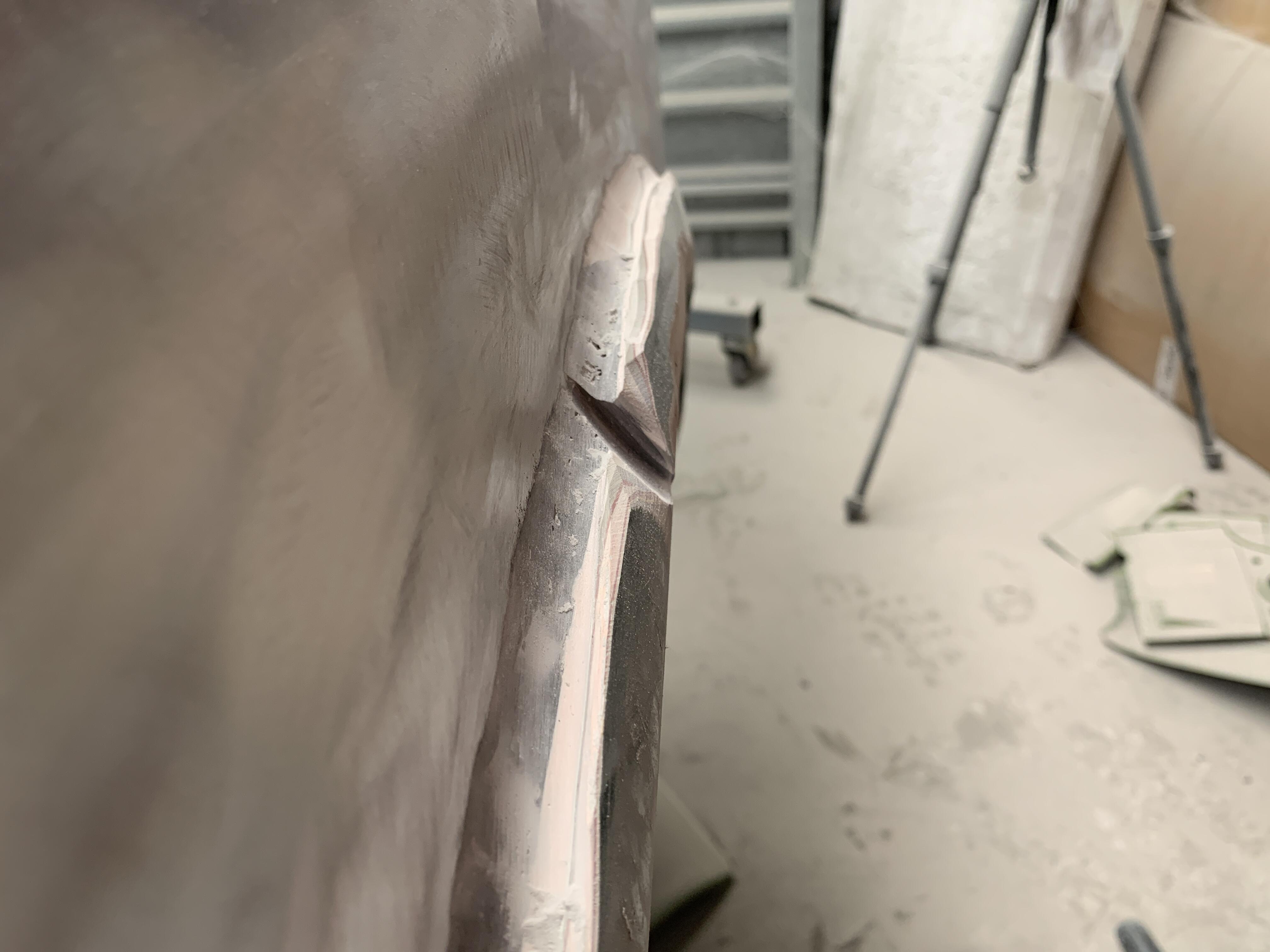

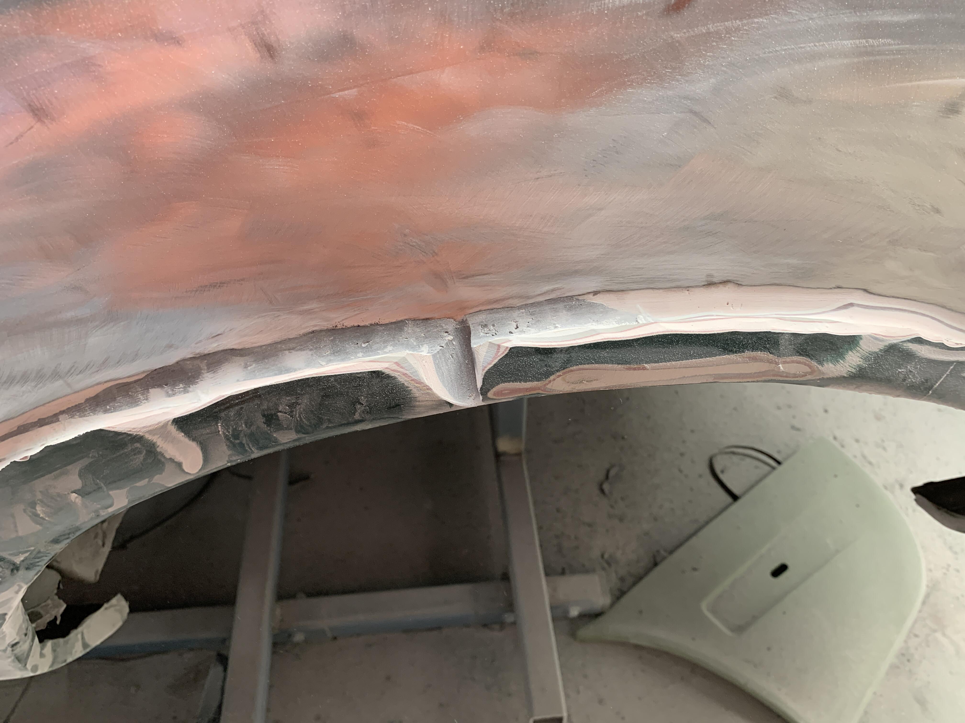

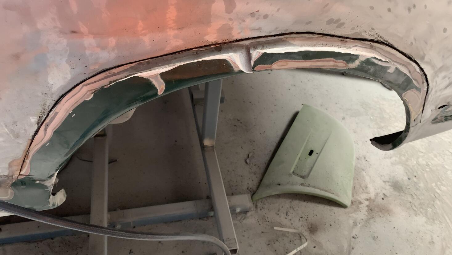

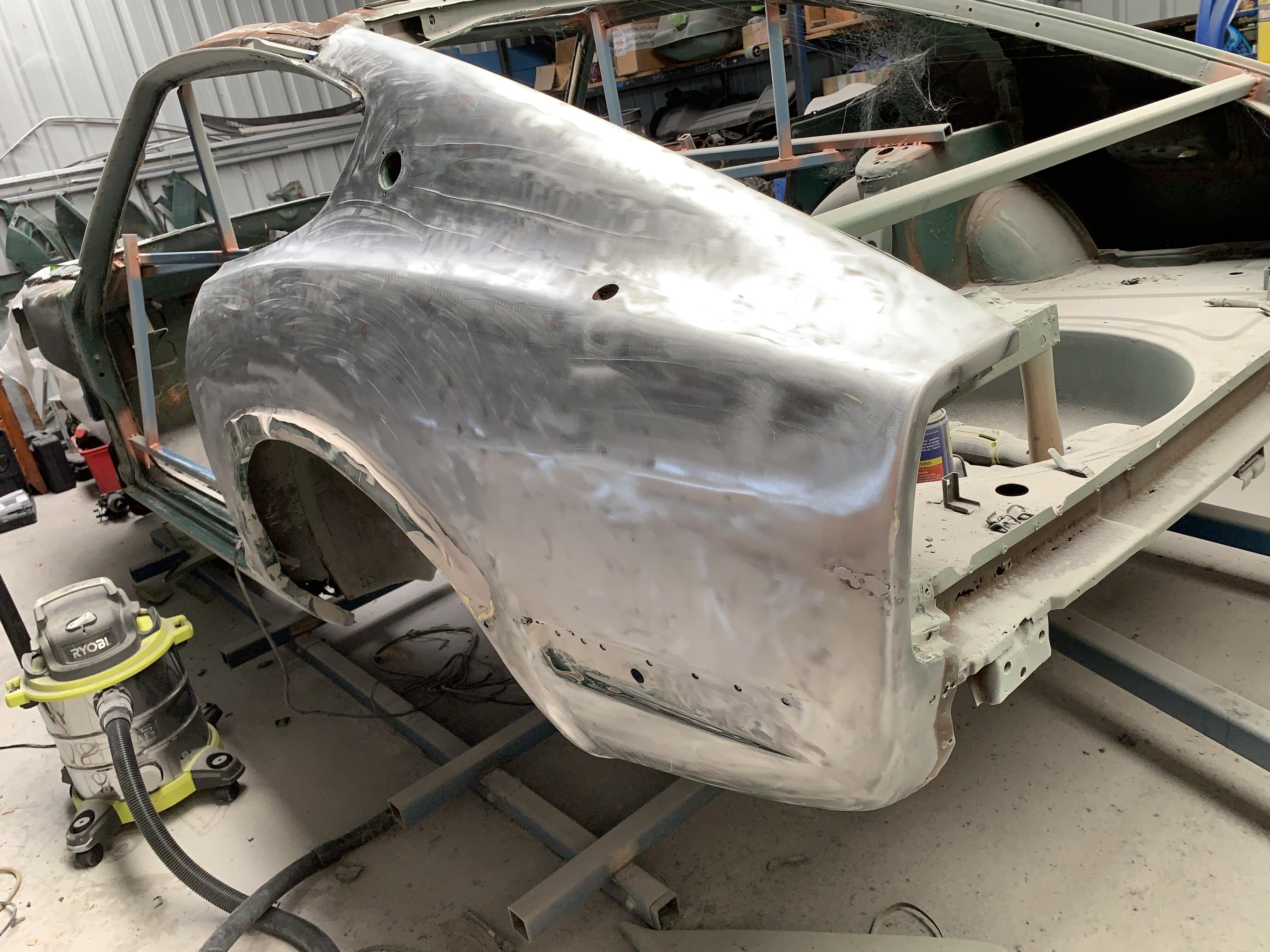

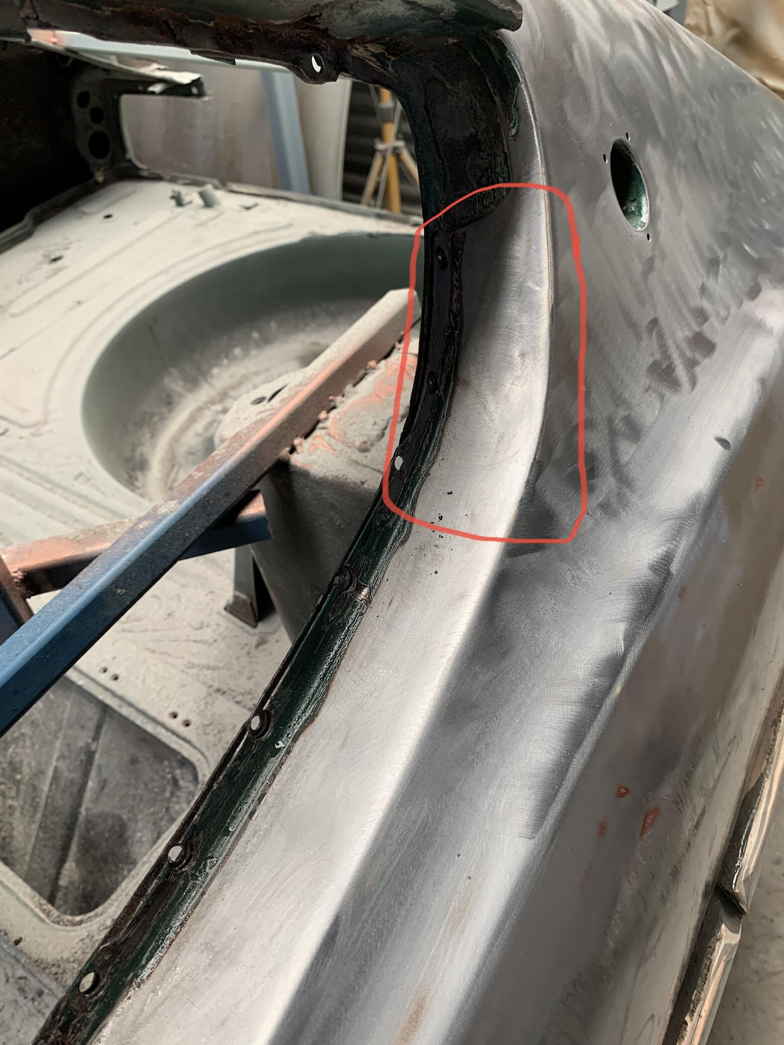

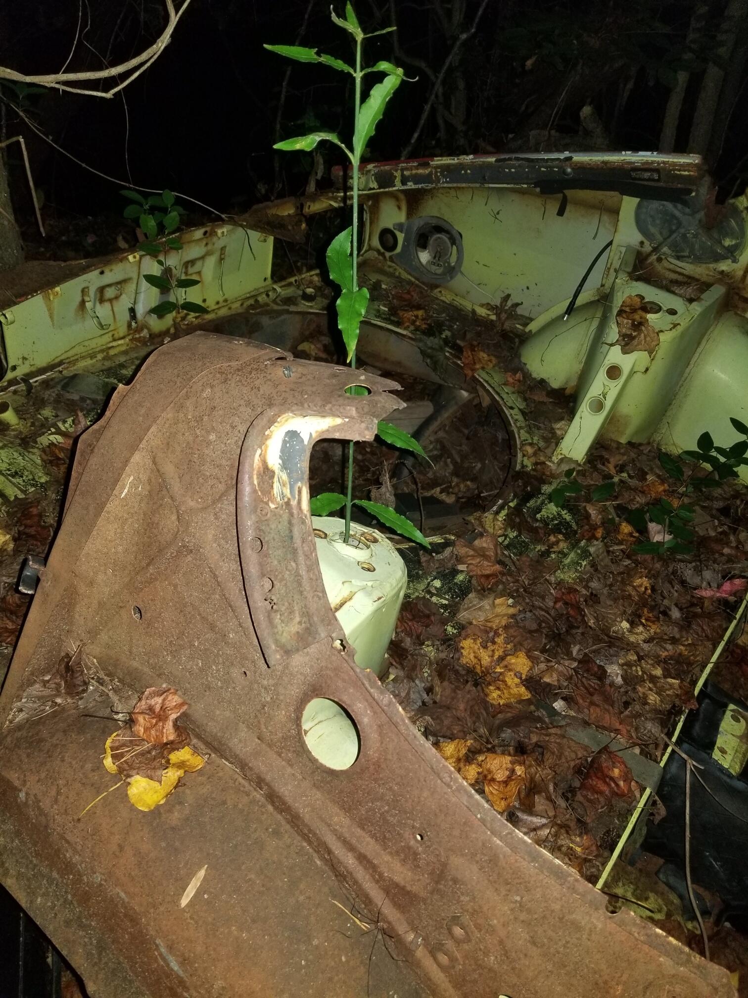

October 14, 20222 yr Author comment_646384 Continuing on with panel removal I started on the LHS rear quarter panel, before starting I decided to strip the paint, Im undecided if Im going to reuse this quarter panel, I have all the necessary replacement panels to patch it (tabco rear wheel arches, KFV lower rear section and my spare roof has healthy looking pieces around the rear quarter window i could use )but would be much easier to just replace the full KFV quarter panel. but cost of shipping is beyond ridiculous. was quoted $4167USD including shipping..... more than i paid for the car! Surprisingly besides the rooted doglegs, wheel arches and rusted out quarter window sections its a very clean panel, one minor bit of dodgy patching on the very corner but otherwise clean. check out the more than inch worth of bog in the rear arch.... some real artisans worked on this car... The arches are pretty much non existant so i stripped until i found the rust and decided to leave the bog and cut around it, same with the dogleg. Ive drilled out majority of the spotwelds, only the C pillar/rear quarter window area to go. One question i have is does anyone know if there are any spotwelds in the below location onto the underlying panel that creates the curve of the rear window? Edited October 14, 20222 yr by 240ZBUILTBYME Link to comment https://www.classiczcars.com/forums/topic/64416-240zbuiltbyme-1971-240z-hs-001063-project-georgia/?&page=24#findComment-646384 Share on other sites More sharing options...
October 14, 20222 yr comment_646392 WAUW !!! Those guys were not painters.. they were sculpturers!! Over a inch of .. as you call it bog.. WAUW !!! 4 hours ago, 240ZBUILTBYME said: does anyone know if there are any spotwelds in the below location onto the underlying panel that creates the curve of the rear window? I really would not know but if you clean up the surface really good you should see the welds if there are any. Maybe a small camera inside to check for them? (endoscope) Link to comment https://www.classiczcars.com/forums/topic/64416-240zbuiltbyme-1971-240z-hs-001063-project-georgia/?&page=24#findComment-646392 Share on other sites More sharing options...

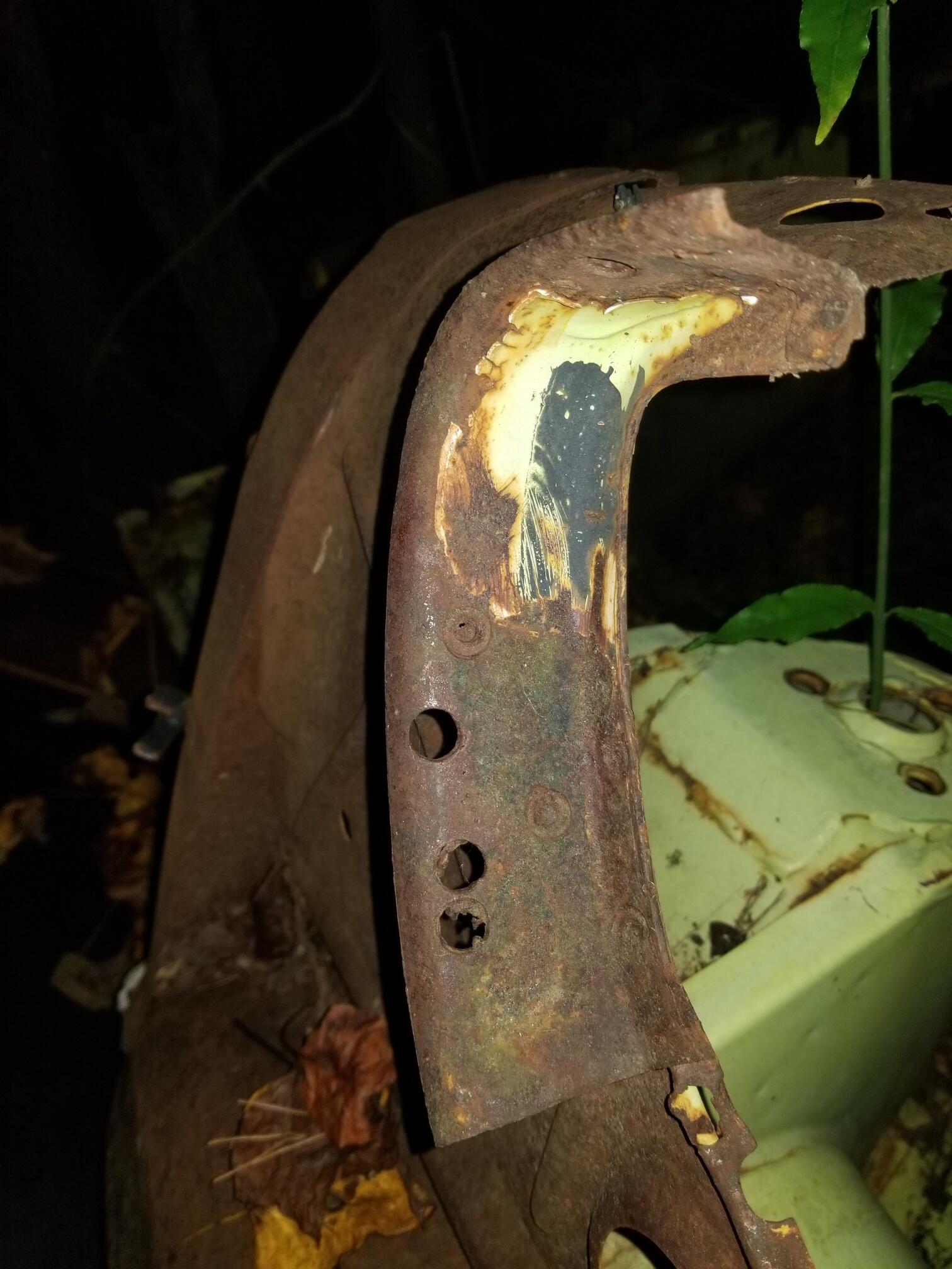

October 14, 20222 yr comment_646415 I took these on the way up from the deer blind. Does this help? Looks like 5 spot welds on the bottom section. there are some on the top too you can just barely see Link to comment https://www.classiczcars.com/forums/topic/64416-240zbuiltbyme-1971-240z-hs-001063-project-georgia/?&page=24#findComment-646415 Share on other sites More sharing options...
October 15, 20222 yr Author comment_646416 23 minutes ago, Patcon said: I took these on the way up from the deer blind. Does this help Looks like 5 spot welds on the bottom section. there are some on the top too you can just barely see Thanks! Yes this does help! somewhat anyway, they're very difficult to see for some reason, its going to be fun trying to find them... Edited October 15, 20222 yr by 240ZBUILTBYME Link to comment https://www.classiczcars.com/forums/topic/64416-240zbuiltbyme-1971-240z-hs-001063-project-georgia/?&page=24#findComment-646416 Share on other sites More sharing options...
