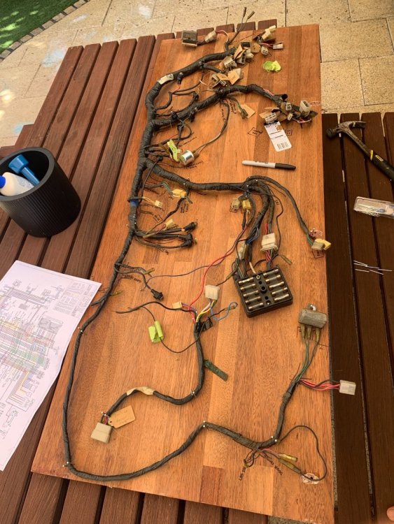

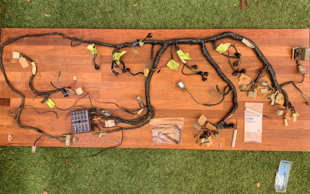

240ZBUILTBYME Posted March 24, 2023 Author Share #301 Posted March 24, 2023 My z guy Martin is giving me the hurry up to get my dash harness to him so he can install my gauges, I wanted to do an overhaul on all the terminals and plugs, so I first created a nail board and splayed out the harness. I then started studying the wiring diagram which to be honest at first look overwhelmed me, but once you have the harness splayed out and diagram in front of you it gets clearer. Then I marked out all the harness intersections on the board and began labelling each terminal using the wiring diagram to help me identify terminals or plugs that weren't connected to anything when i removed it from the car. Next I plan to strip the tape off the harness putting small bands of temporary tape to hold its shape and intersections, then Ill inspect and repair the wires, once I'm happy with the wires i will start depinning, replacing pins and plugs. before retaping I'm going to see if i can get it continuity tested or if i can do it myself. 3 Link to comment Share on other sites More sharing options...
Racer X Posted March 24, 2023 Share #302 Posted March 24, 2023 1 hour ago, 240ZBUILTBYME said: My z guy Martin is giving me the hurry up to get my dash harness to him so he can install my gauges, I wanted to do an overhaul on all the terminals and plugs, so I first created a nail board and splayed out the harness. I then started studying the wiring diagram which to be honest at first look overwhelmed me, but once you have the harness splayed out and diagram in front of you it gets clearer. Then I marked out all the harness intersections on the board and began labelling each terminal using the wiring diagram to help me identify terminals or plugs that weren't connected to anything when i removed it from the car. Next I plan to strip the tape off the harness putting small bands of temporary tape to hold its shape and intersections, then Ill inspect and repair the wires, once I'm happy with the wires i will start depinning, replacing pins and plugs. before retaping I'm going to see if i can get it continuity tested or if i can do it myself. You can do the continuity testing yourself, with a volt/ohm meter. Link to comment Share on other sites More sharing options...
240ZBUILTBYME Posted March 24, 2023 Author Share #303 Posted March 24, 2023 28 minutes ago, Racer X said: You can do the continuity testing yourself, with a volt/ohm meter. yeah I was planning on giving it a go, was just reading up on testing a harness seems straight forward but you obviously need to know where each wire terminates on both ends, so would make sense to do it while all the tape is off 1 Link to comment Share on other sites More sharing options...
dutchzcarguy Posted March 25, 2023 Share #304 Posted March 25, 2023 Also check the fusebox on bad connections. take out 1 fuse and close the clamps and check it they are still have a good conn. to the back cable. clean the fuse clamps with alcohol. Put back fuse and check if it is clamped well.. next fuse etc. etc. 1 Link to comment Share on other sites More sharing options...
Patcon Posted March 26, 2023 Share #305 Posted March 26, 2023 I have found that on many locations the harnesses already have small bands of tape at the junctions. I also believe the original loom tape had some adhesive on it. The residue is on the wires, the ends didn't have additional wrapping to prevent raveling and it makes a noise when unwrapping that sounds like old adhesive. 1 Link to comment Share on other sites More sharing options...
