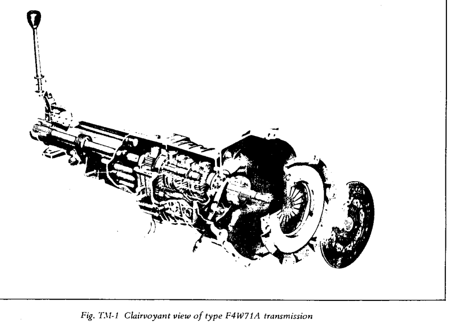

September 12, 20204 yr comment_605781 The engine removal process looked pretty normal. Many of us have been there. Letting air out of the tires will give you a little more room. Wait until you put it back in and can't the get the tail of the transmission lifted up to fit the back mount. The transmission looks like a "B" model, Not "A". You can tell by the shifter area. It's not "monkey motion". Link to comment https://www.classiczcars.com/forums/topic/64416-240zbuiltbyme-1971-240z-hs-001063-project-georgia/?&page=3#findComment-605781 Share on other sites More sharing options...
September 13, 20204 yr Author comment_605827 22 hours ago, Zed Head said: The engine removal process looked pretty normal. Many of us have been there. Letting air out of the tires will give you a little more room. Wait until you put it back in and can't the get the tail of the transmission lifted up to fit the back mount. The transmission looks like a "B" model, Not "A". You can tell by the shifter area. It's not "monkey motion". I actually had the front of the car up on stands when I took it out, my theory was that it would create a better angle to work with but I think it made it harder... lol oh well live and learn! Yea definitely a B type. I believe my car was an automatic originally, so PO must have transplanted this and the engine in as it’s a 72+ gearbox and mine is a early 71. Not too fussed though! Link to comment https://www.classiczcars.com/forums/topic/64416-240zbuiltbyme-1971-240z-hs-001063-project-georgia/?&page=3#findComment-605827 Share on other sites More sharing options...

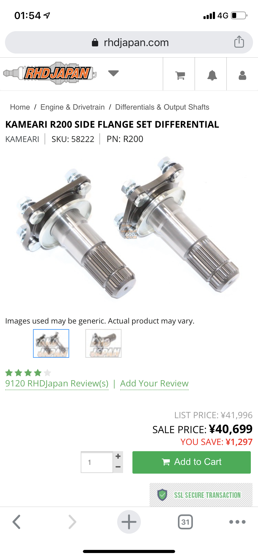

September 13, 20204 yr Author comment_605829 So these are the kameari Subaru R180 diff to half shaft adapters. They are really pretty.... so the splines go into the Subaru diff and flanges onto stock halfshafts. Chuck your stock z diff front face flange and diff backplate onto the Subaru R180 and hey presto 240z LSD for under 2k! My z man has to check the internals on the Subaru diff to make sure everything’s healthy and then it’s a done deal! Link to comment https://www.classiczcars.com/forums/topic/64416-240zbuiltbyme-1971-240z-hs-001063-project-georgia/?&page=3#findComment-605829 Share on other sites More sharing options...

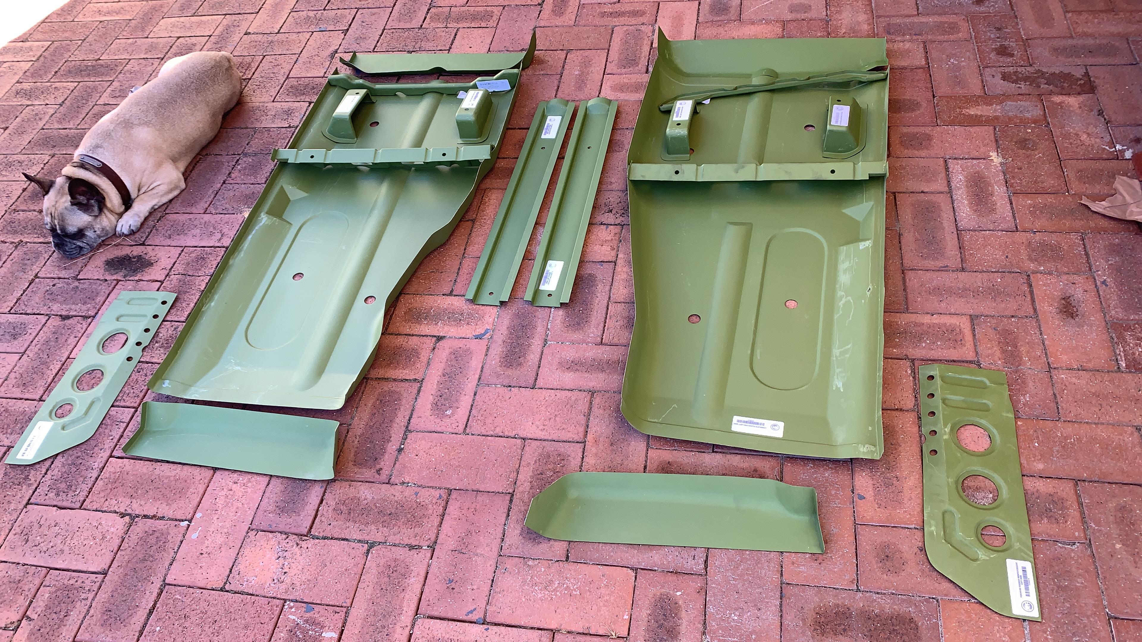

September 15, 20204 yr Author comment_605948 My panels arrived from KFvintagejdm! Well some of them... did the post on Viczcar and has lots of photos which took me ages to upload so if you would like to check out my thoughts on the panels here’s the link. https://www.viczcar.com/forums/topic/20081-kfvintagejdm-replacement-panels-initial-review-and-quality/ they’re very high quality, I’m especially impressed by the floor pans! Edited September 15, 20204 yr by 240ZBUILTBYME Link to comment https://www.classiczcars.com/forums/topic/64416-240zbuiltbyme-1971-240z-hs-001063-project-georgia/?&page=3#findComment-605948 Share on other sites More sharing options...

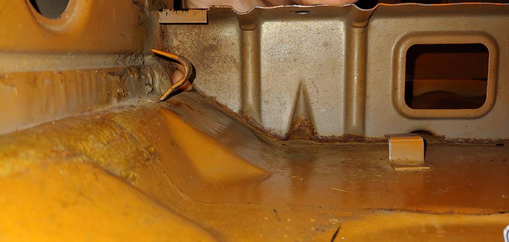

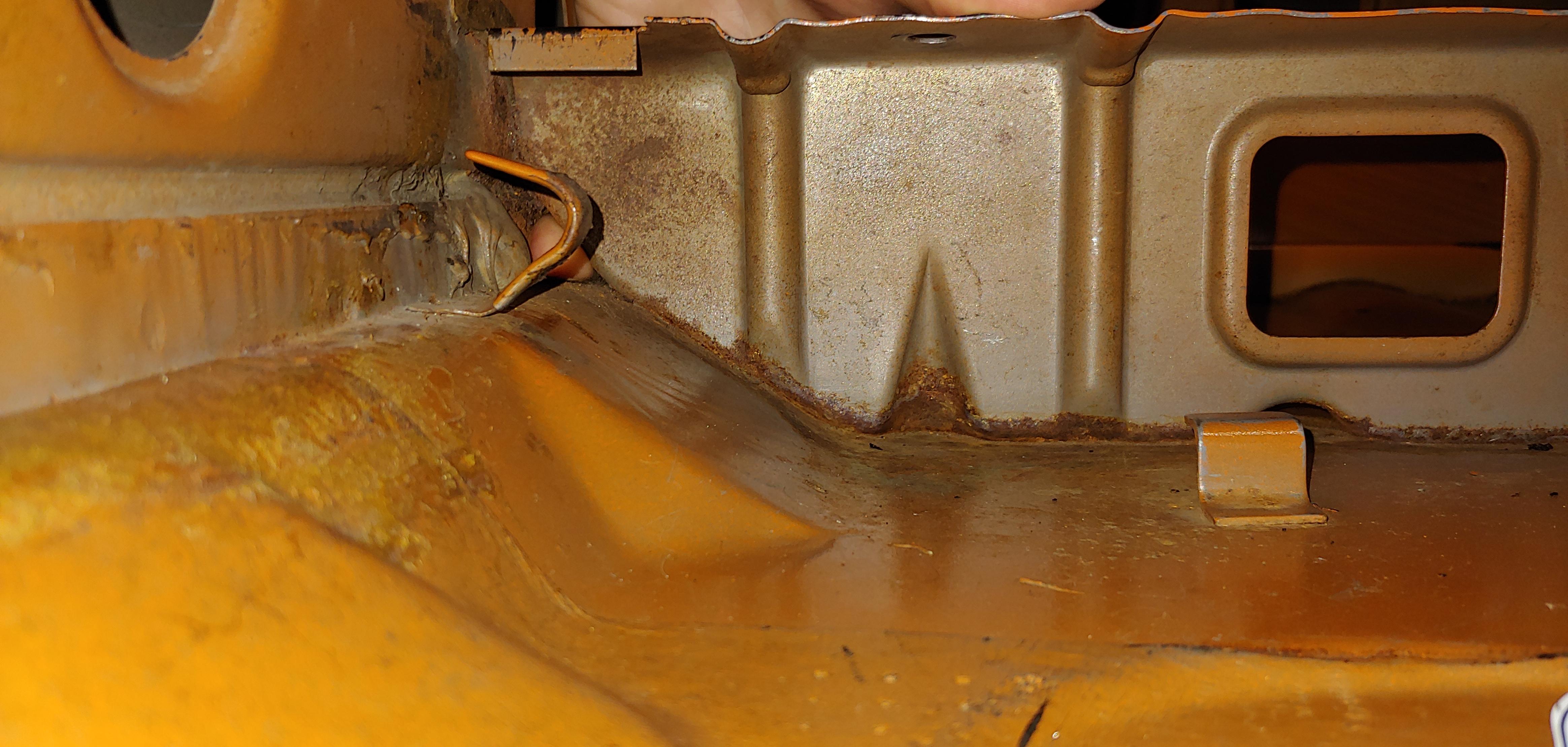

September 15, 20204 yr comment_605958 5 hours ago, 240ZBUILTBYME said: My panels arrived from KFvintagejdm! Well some of them... did the post on Viczcar and has lots of photos which took me ages to upload so if you would like to check out my thoughts on the panels here’s the link. https://www.viczcar.com/forums/topic/20081-kfvintagejdm-replacement-panels-initial-review-and-quality/ they’re very high quality, I’m especially impressed by the floor pans! Thanks for your review of the parts from KFvintageJDM, it's very timely as I might need some of the parts they offer. Regarding your question, on viczcar, about the fit on the outside edge of the front seat rails, mine has about a pinky finger sized gap. Link to comment https://www.classiczcars.com/forums/topic/64416-240zbuiltbyme-1971-240z-hs-001063-project-georgia/?&page=3#findComment-605958 Share on other sites More sharing options...
September 16, 20204 yr Author comment_606001 10 hours ago, CanTechZ said: Thanks for your review of the parts from KFvintageJDM, it's very timely as I might need some of the parts they offer. Regarding your question, on viczcar, about the fit on the outside edge of the front seat rails, mine has about a pinky finger sized gap. No problem cantech! Will update the thread once I start fitting panels which won’t be for a bit. Ahhh thanks for the photo I thought it might be a stock gap! Link to comment https://www.classiczcars.com/forums/topic/64416-240zbuiltbyme-1971-240z-hs-001063-project-georgia/?&page=3#findComment-606001 Share on other sites More sharing options...
