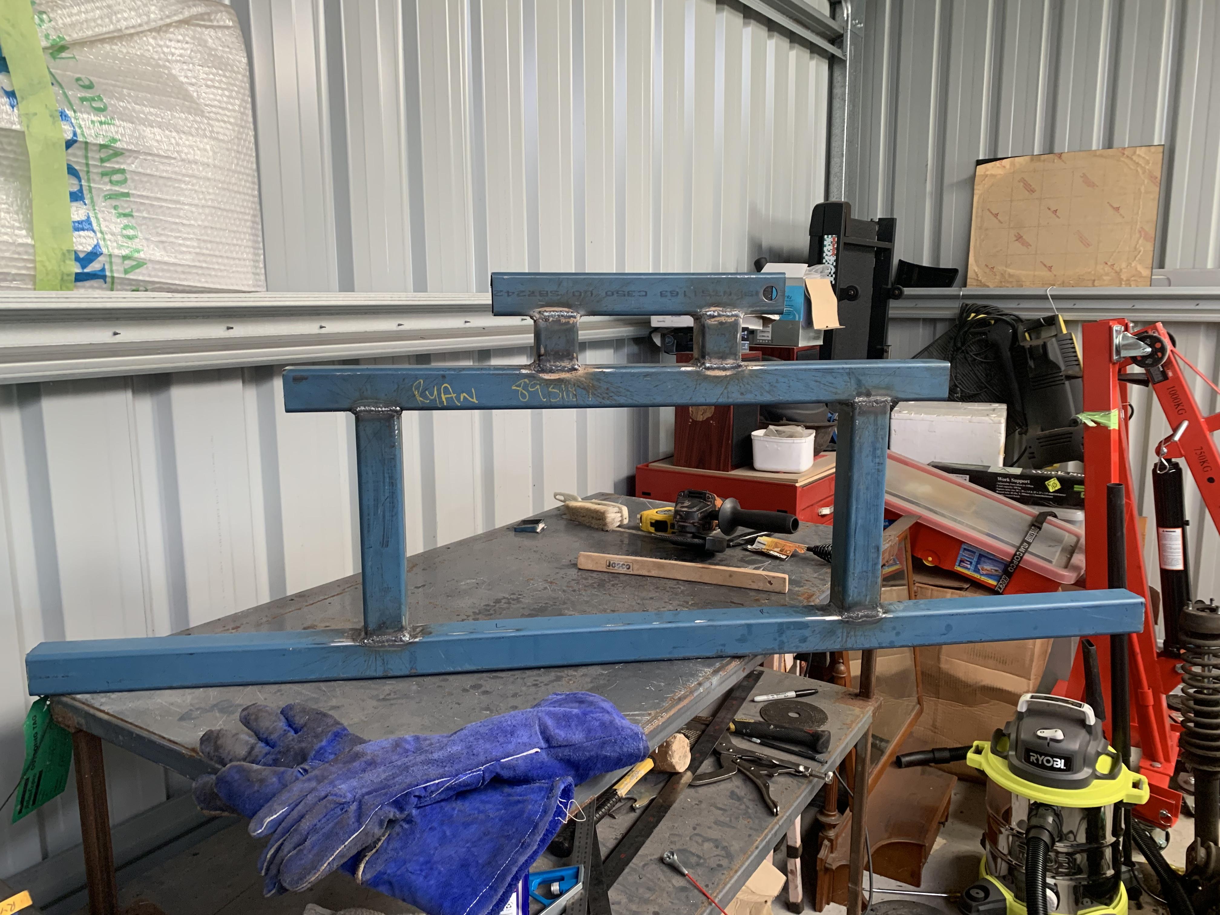

October 30, 20204 yr Author comment_609242 Completed the next frame which attaches to the gearbox support mounts in the trans tunnel. Drilled out the bolt holes and made sure it fit before welding onto the rest of the frame. My welding is getting better and quicker. But still slow as... this took me 5 hours including drilling. Came out square so I’m happy! next time I hope to finish the last 2 frames... Link to comment https://www.classiczcars.com/forums/topic/64416-240zbuiltbyme-1971-240z-hs-001063-project-georgia/?&page=6#findComment-609242 Share on other sites More sharing options...
