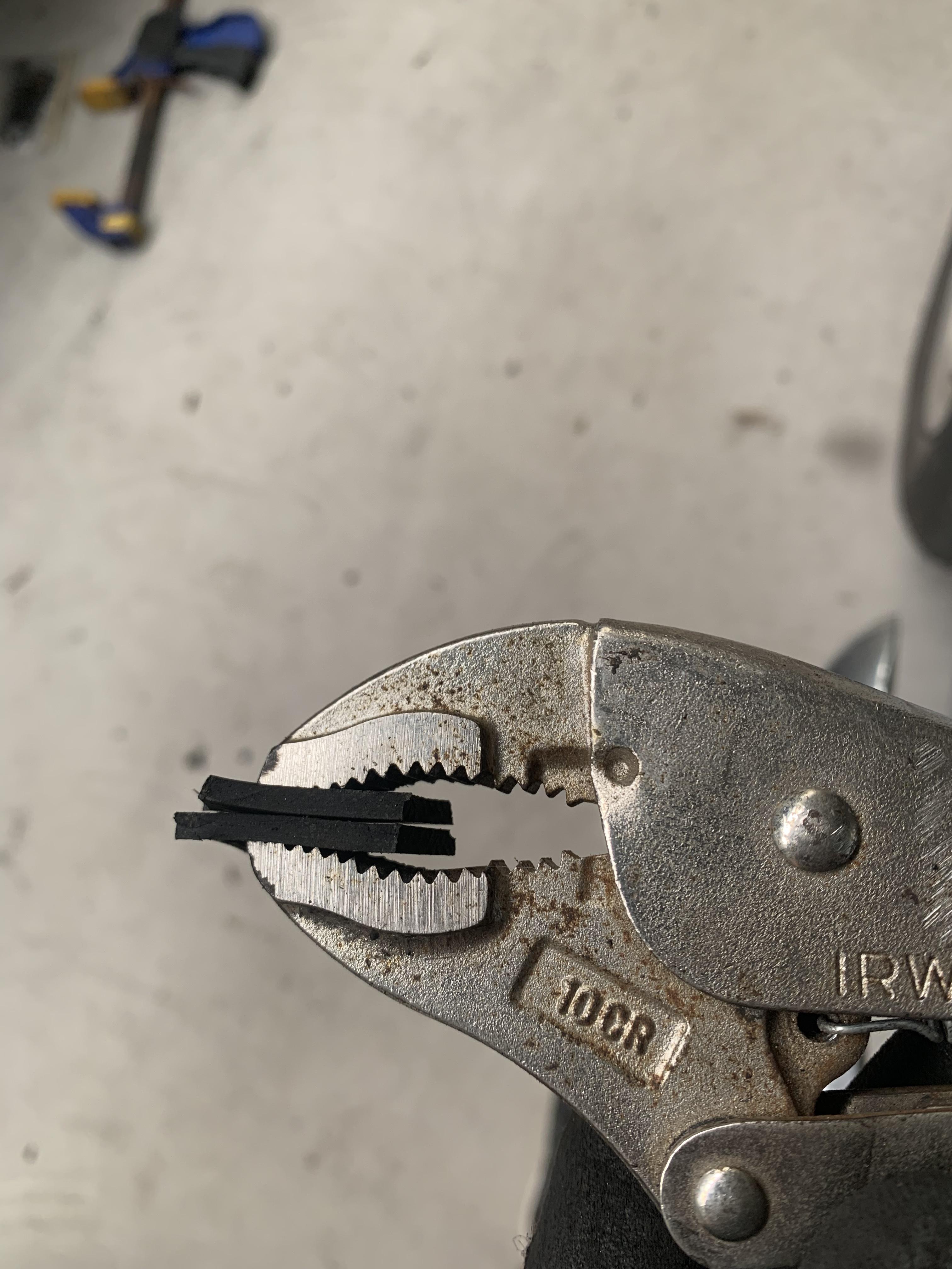

Have you tried the vise method?  If you have an old rad hose lying around cut out 2 pieces, they go on either vise jaw, tighten it up hard against the needle as close to the base as possible. Then you have the body of the carb as your handle so you can slowly rotate body around the shaft of the needle.

Another technique is to clamp the needle as @grannyknot suggested.  Set up a "permanent" torque on the piston and LEAVE IT ALONE overnight, or longer.  Juice it once in a while with WD.  Many times I return to the shop next day and find no torque on the part and the two pieces are loose of each other.

But I did get round to trying to get the needles out, I decided to first try some rubber and some vice grips as it was the easiest to conjure.
And long story short it worked! Just needed the grip  of the rubber to apply enough torque to twist it free!  The second needle came out by hand.
