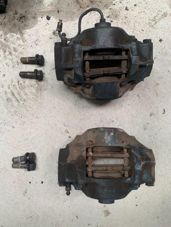

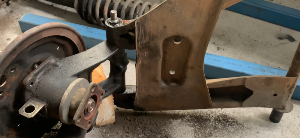

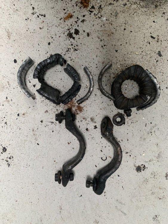

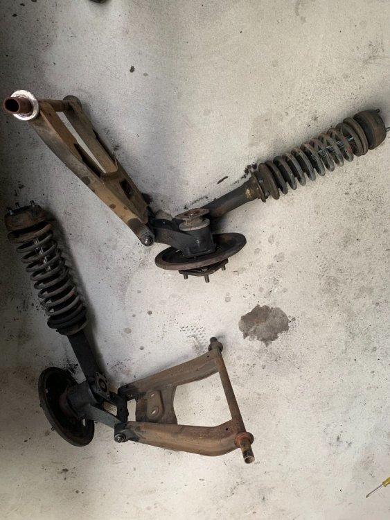

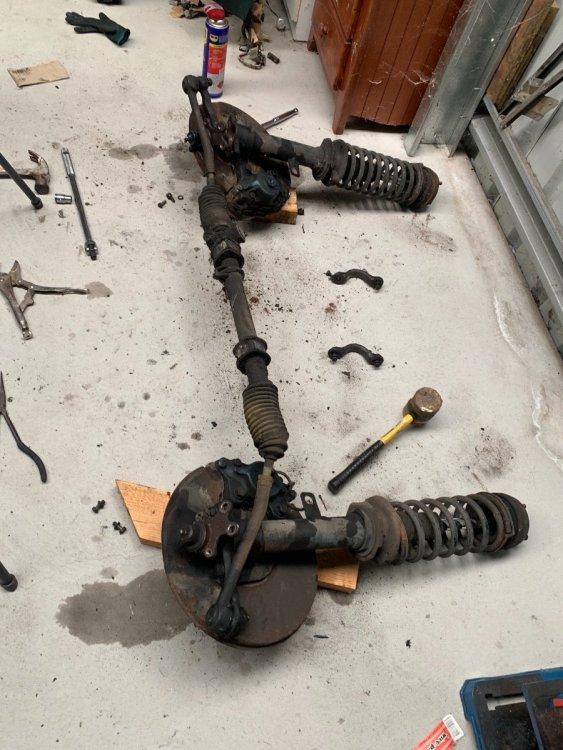

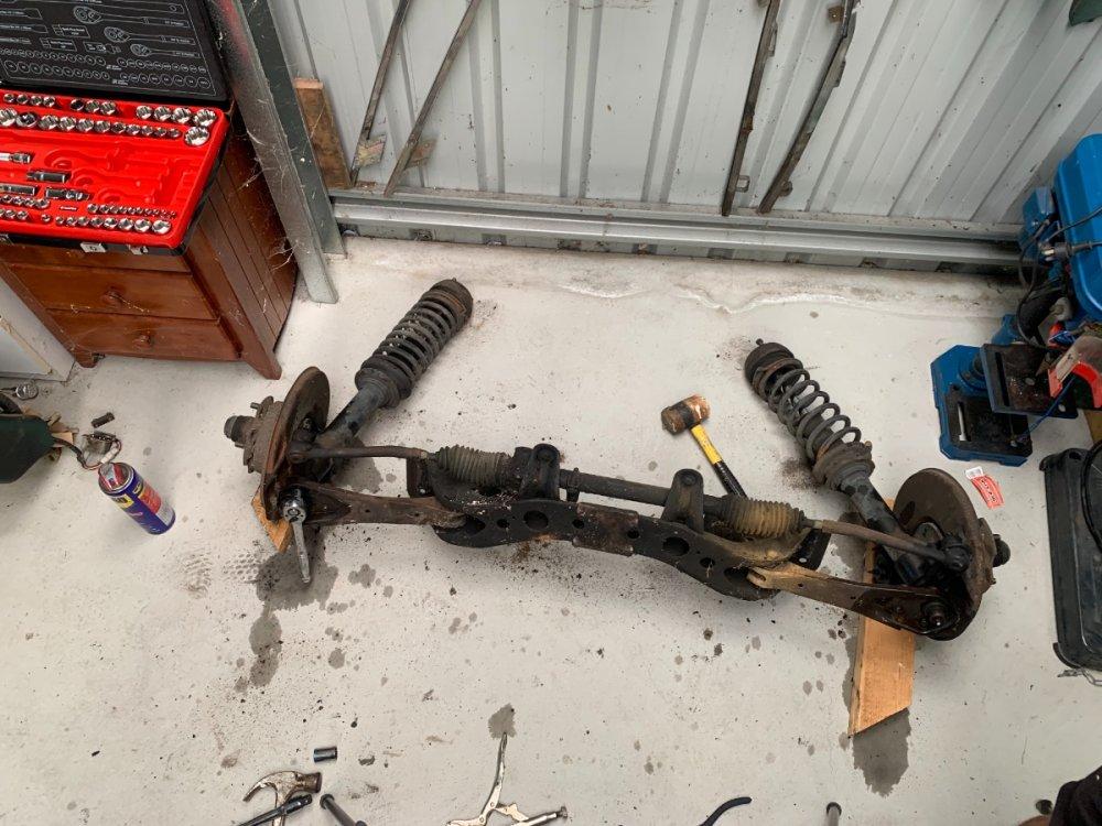

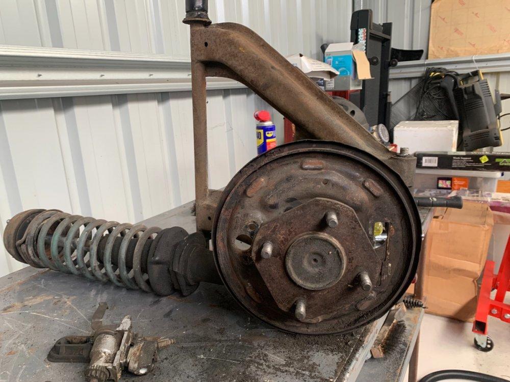

December 13, 20204 yr Author comment_612429 so despite my daughter arriving I managed to make it to the car to do a bit of spannering, stripped the drum brakes and gave them a clean out, also got the front suspension assembly broken down and ready to bring all components in need of a press to my mates shop. I still haven’t decided if I’m going to rebuild drums or go straight to discs. Any thoughts or opinions? not sure which is an original 240z cylinder, anyone know off hand? After wire brushing the crud off the rear control arm looks like some smart fellow tried to put a jack stand under it. I was thinking I would just finesse the dents straight if I can. Outer tie rods were jammed in tight, haven’t tried heat yet but figure I’ll just press them out along with everything else. So just dismantled steering rack at the knuckle. anybody know if the silver brackets from the steering rack bushes are meant to be there? They looked like diy aluminum shims made up. Link to comment https://www.classiczcars.com/forums/topic/64416-240zbuiltbyme-1971-240z-hs-001063-project-georgia/?&page=9#findComment-612429 Share on other sites More sharing options...
December 13, 20204 yr comment_612435 I agree, I would try to straighten out the damage on the control arm. Haven't seen the shims before Most rear brake upgrades dont increase brake efficiency. Some can throw off the F/R bias and increase stopping distance. All that said I am going with rear disc because they are self adjusting. Link to comment https://www.classiczcars.com/forums/topic/64416-240zbuiltbyme-1971-240z-hs-001063-project-georgia/?&page=9#findComment-612435 Share on other sites More sharing options...
December 13, 20204 yr comment_612436 3 minutes ago, Patcon said: I am going with rear disc because they are self adjusting. Uhhhh... So are the rear drums. Haha!! Link to comment https://www.classiczcars.com/forums/topic/64416-240zbuiltbyme-1971-240z-hs-001063-project-georgia/?&page=9#findComment-612436 Share on other sites More sharing options...
December 13, 20204 yr comment_612440 1 minute ago, Captain Obvious said: Uhhhh... So are the rear drums. Haha!! I know, I know... But I find they dont always adjust as designed and the pedal stroke gets longer to take up the space. The discs really dont have that issue Link to comment https://www.classiczcars.com/forums/topic/64416-240zbuiltbyme-1971-240z-hs-001063-project-georgia/?&page=9#findComment-612440 Share on other sites More sharing options...
December 13, 20204 yr comment_612443 I know. You are absolutely right. They are supposed to adjust, but they usually just don't. In order to get rear drums that really do adjust, you need to get away from that goofy floating cylinder design and swap over to the 77-78 style or do a rear disk mod. Link to comment https://www.classiczcars.com/forums/topic/64416-240zbuiltbyme-1971-240z-hs-001063-project-georgia/?&page=9#findComment-612443 Share on other sites More sharing options...
