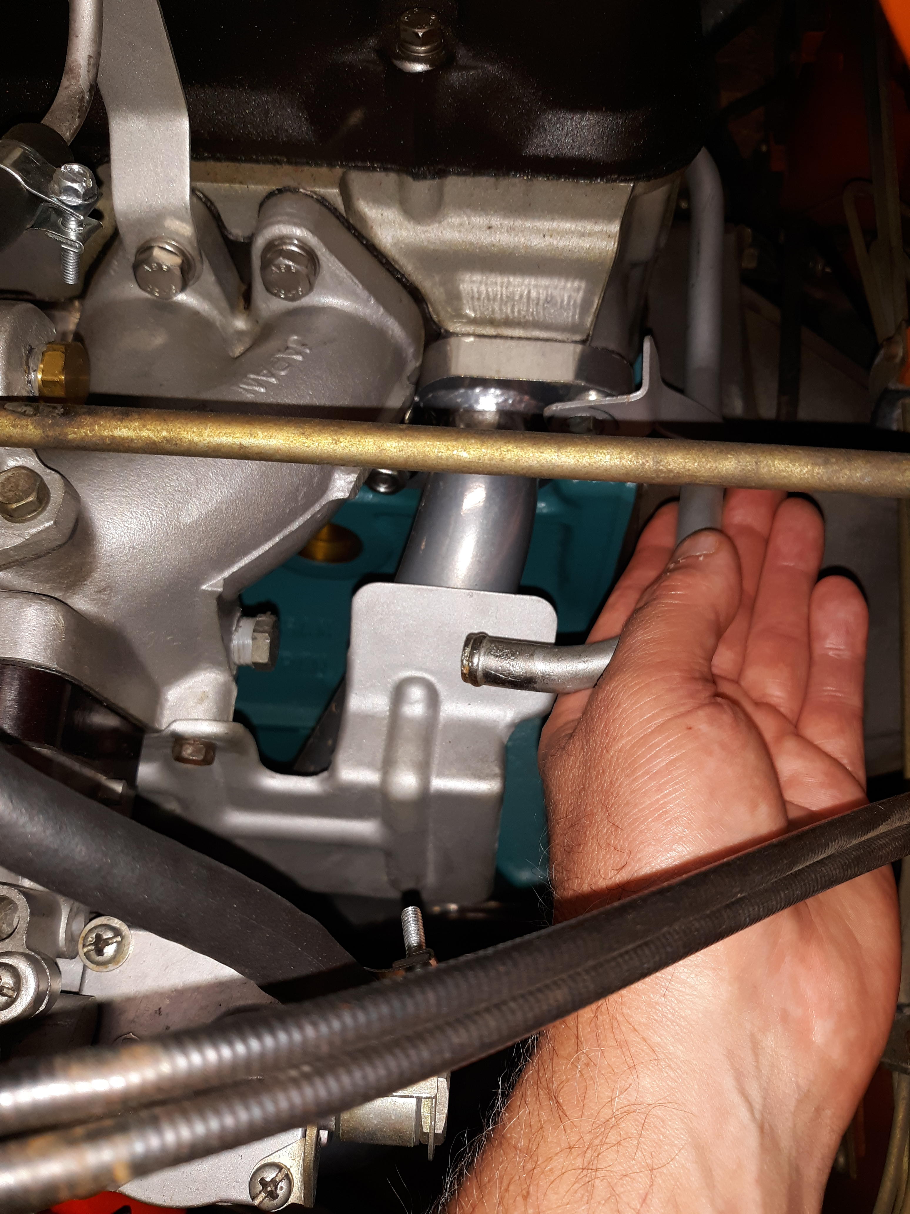

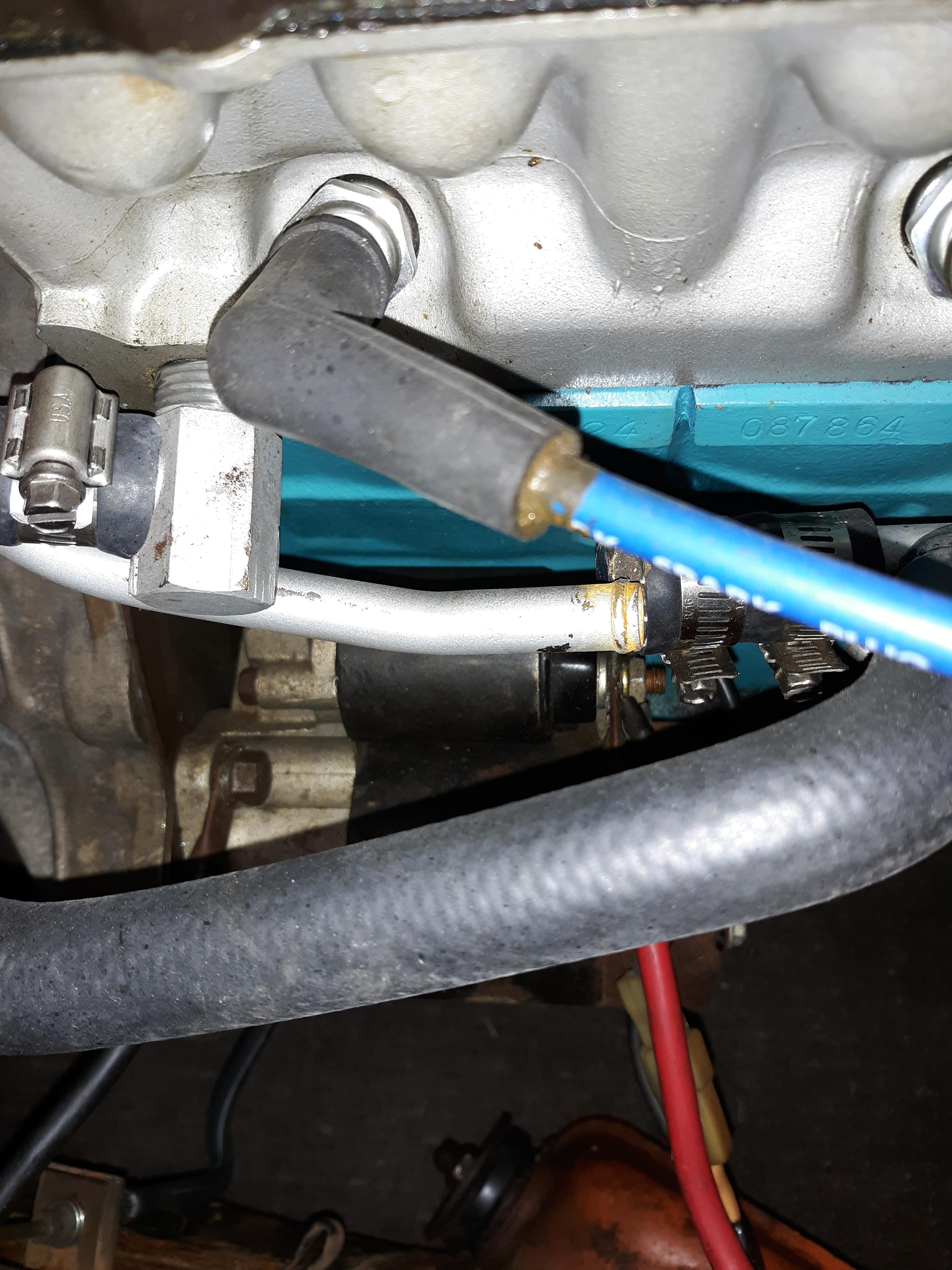

The lower thermostat housing that you have with the blocked off port is interchangeable in mounting with the earlier lower thermostat housing. The upper housing caps are the same. You could swap out the lower housing, install an earlier manifold water fitting and reduce some of the clutter and previous owner damage. When and if you decide to change over to the earlier balance tube you will also have the opportunity to change to the earlier type water piping at the rear of the engine block. This would eliminate capping off the now un-necessary water lines on the water piping used on the later flat tops in that area.
The routing of the water lines with the "Y" connection shown in your lower photo is on the wrong side of the block/ valve cover.  It should be on the opposite side ---mounted below the spark plugs. It reduces in diameter and converts to a hard metal pipe the wraps behind the engine and connects to the rubber coupling shown above the heat shield on the lower photo.
If you have on hand all of the parts shown in your photos you have most everything you need to make a complete proper conversion. I don't know if you have on hand the earlier metal water pipe that wraps around the rear of the engine.

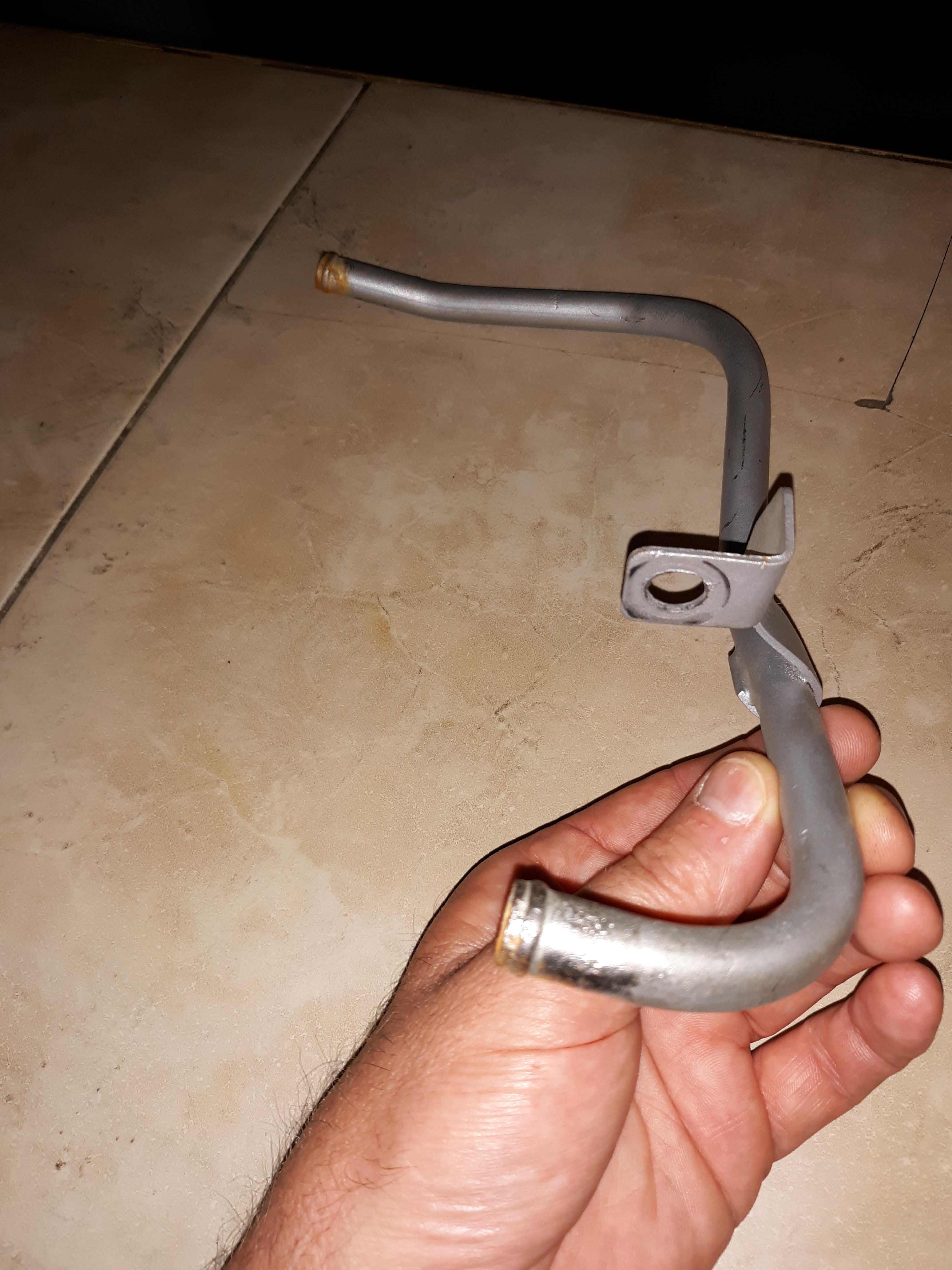

The capped port on the balance tube shown in your third photo should be plugged just like it is on the very end. Just a plug, instead of a fitting with rubber hose and a bolt. The remaining  fitting is where you obtain vacuum for your brake booster and can be left there (vertically) or moved to the end (horizontally) depending on which hose type you have coming from the brake booster.

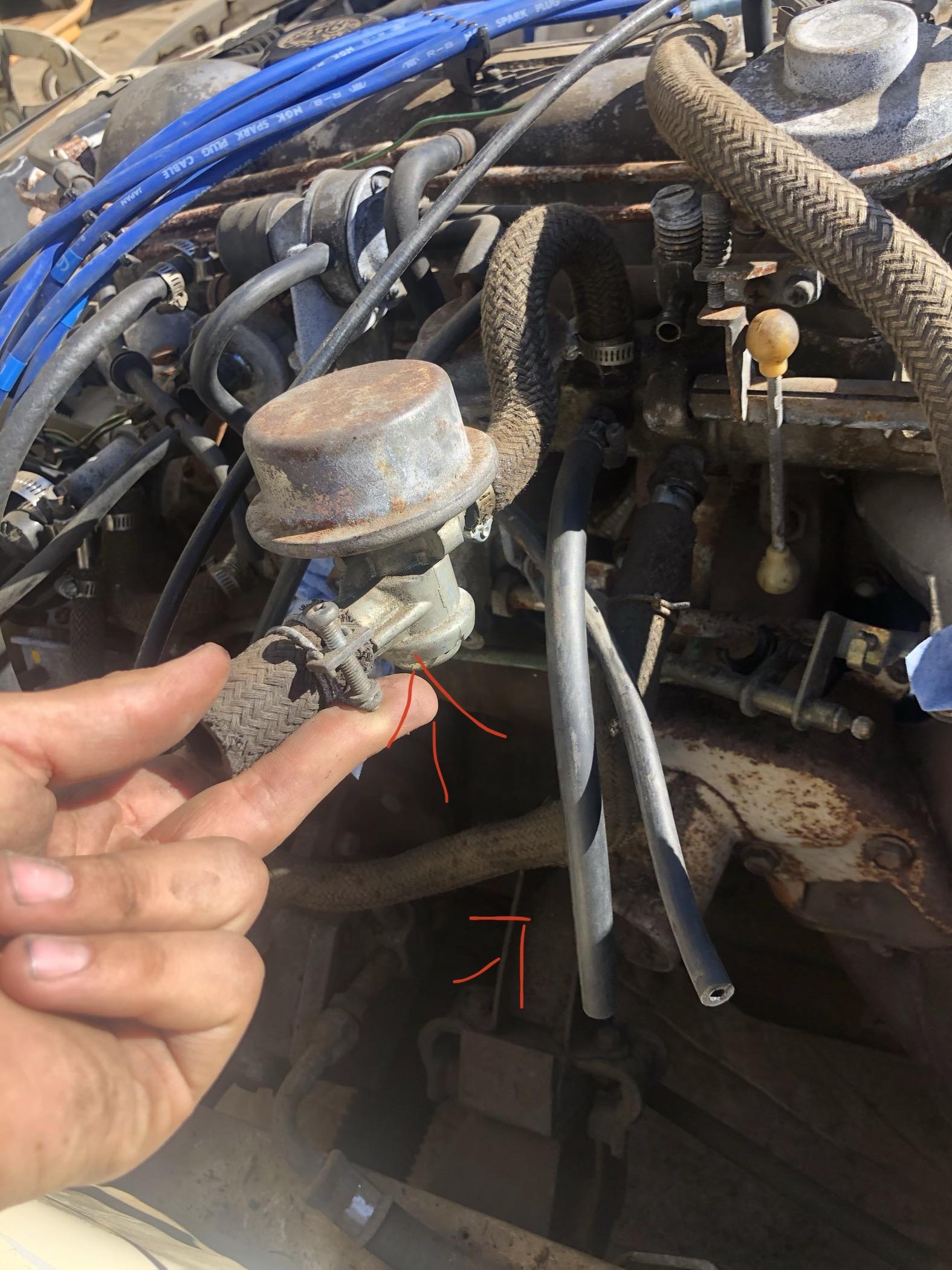

What should I do with this diaphragm? Not exactly sure what it does but from what I can tell, earlier 240Zs at least don’t seem to have them so I’m guessing it isn’t necessary and I’m not sure if the aftermarket air filters I bought (but haven’t received yet) will allow for it to plug in.
So really the question is do I add that port in the balance tube to the list of things to plug? And also what does that diaphragm do, just so I have that knowledge.
Also what is that vacuum hose for and can I plug that? Because I’m not sure if the new air filters will have a port for that either
That diaphragm device is your anti-backfire valve. The round top cars used something similar. Not located in the exact same spot, but pretty close.
As for the vacuum line, that went to your "idle compensator" device built into the air cleaner. It's job was to lean out the idle mixture a little bit when the engine got hot. The round top cars didn't have anything like that and you can just pull the hose off the balance tube and put a cap over the nipple.
