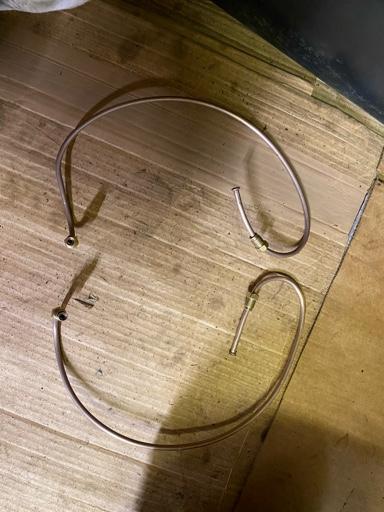

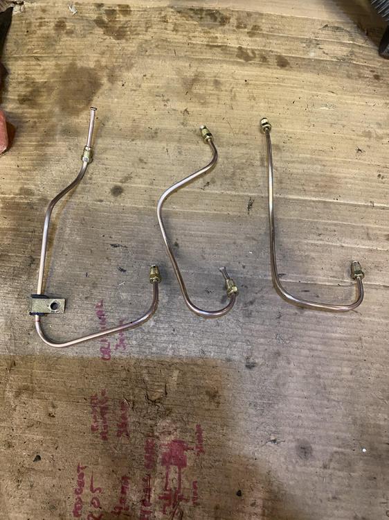

;) I didn’t have to remake mine due to the new cylinders, I did as the PO had used copper! These are cupronickel.
It took under an hour to make and that was mostly me being numb and making them wrong to start with! ;)
25ft pipe £15
Pipe Flaring kit £14
Pipe bender I already had £10
50 x brake line fittings £10
473f27cce1352f2b0db57d2d5e5f5e43.jpg&key=ce9b7c27c19b71ffe230fad7b80b07f48128ec679647a4dec105ab1b86ed45df

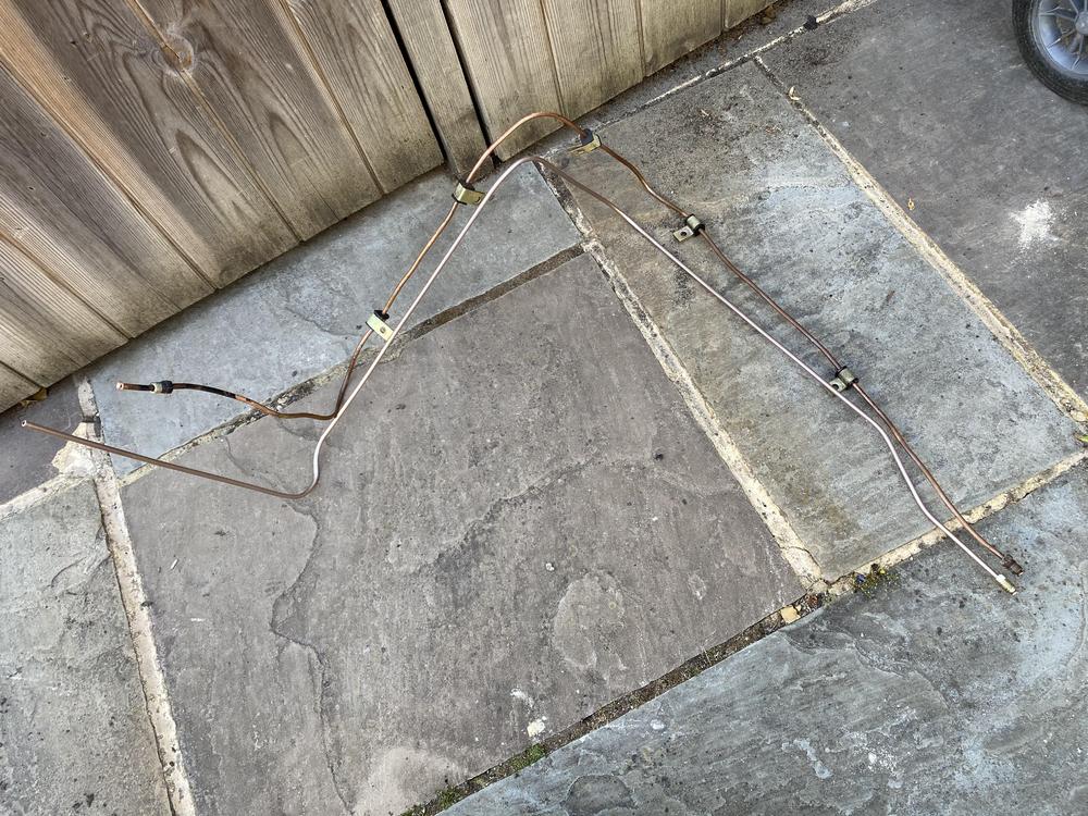

Also remade all the copper brake lines at the front of the car too, saved a small fortune and have safe brakes again! [emoji12]
