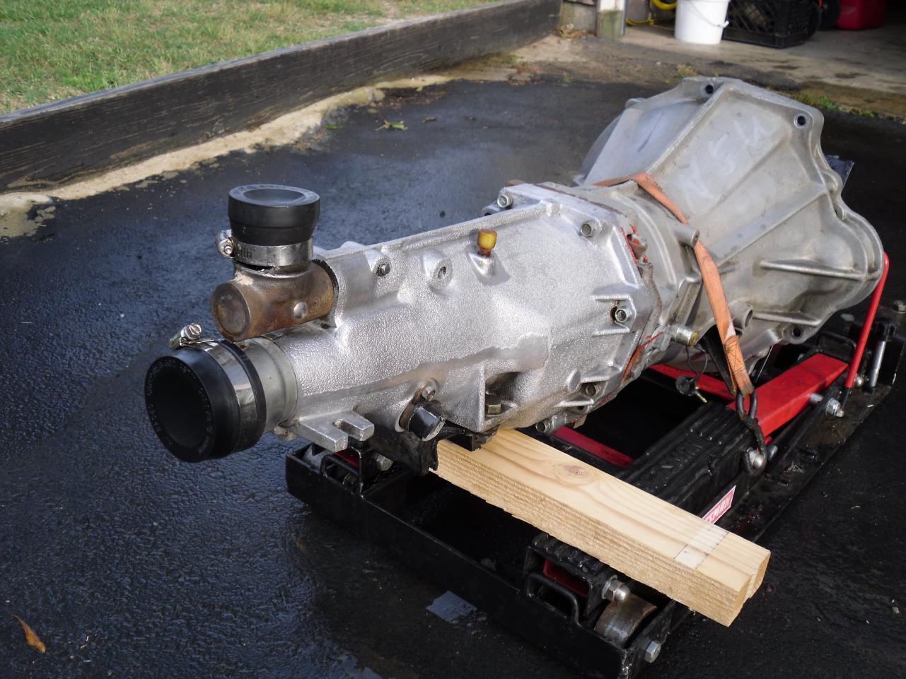

Posted September 20, 20204 yr comment_606262 I pull the transmission out of an engine which is been sitting for 25 years and i found at the bottom a hole in the bell housing surrounded by white powder, my best opinion is that the aluminum rot and is just disintegrating. Im cleaning as much of the transmission as i can but i dont really know of any good product to use so i going a little slow. Is the hole is going to have any negative impact? How can i fix it as to prevent the spread and maybe cover it? Edited September 20, 20204 yr by User0945 Link to comment https://www.classiczcars.com/forums/topic/64475-bell-housing-hole/ Share on other sites More sharing options...
September 20, 20204 yr comment_606278 I'd use it if I couldn't find a replacement. One could also TIG weld the damage. I seem to remember Cliff @siteunseen using cheap oven cleaner on a trans, at one time, and reporting it worked very well. Link to comment https://www.classiczcars.com/forums/topic/64475-bell-housing-hole/#findComment-606278 Share on other sites More sharing options...
September 20, 20204 yr Author comment_606283 5 hours ago, Mark Maras said: I'd use it if I couldn't find a replacement. One could also TIG weld the damage. I seem to remember Cliff @siteunseen using cheap oven cleaner on a trans, at one time, and reporting it worked very well. I bought the oven cleaner and is like magic, as for the weld f its not going to affect anything i might just clean it and leave it. Link to comment https://www.classiczcars.com/forums/topic/64475-bell-housing-hole/#findComment-606283 Share on other sites More sharing options...
September 20, 20204 yr comment_606284 Yes I did use the cheap walmart oven cleaner then went to hot water spray car wash. You can buy these rubber caps in the plumbing section at Lowe's for just a few dollars. Worked out good for me. Link to comment https://www.classiczcars.com/forums/topic/64475-bell-housing-hole/#findComment-606284 Share on other sites More sharing options...
September 20, 20204 yr Author comment_606295 Thanks, im new to the transmission stuff and this might go out of the original question but i don't want to create a new post, how do i check the gears?. I know i have to rotate the input shaft but, how do i get them to change when the transmission is like that? Link to comment https://www.classiczcars.com/forums/topic/64475-bell-housing-hole/#findComment-606295 Share on other sites More sharing options...
September 20, 20204 yr comment_606297 You need a shift lever. The corrosion around the drain hole is not a big deal. Maybe some road salt got in there and caused corrosion over the years. It shouldn't get bigger once you clean things up. Link to comment https://www.classiczcars.com/forums/topic/64475-bell-housing-hole/#findComment-606297 Share on other sites More sharing options...
