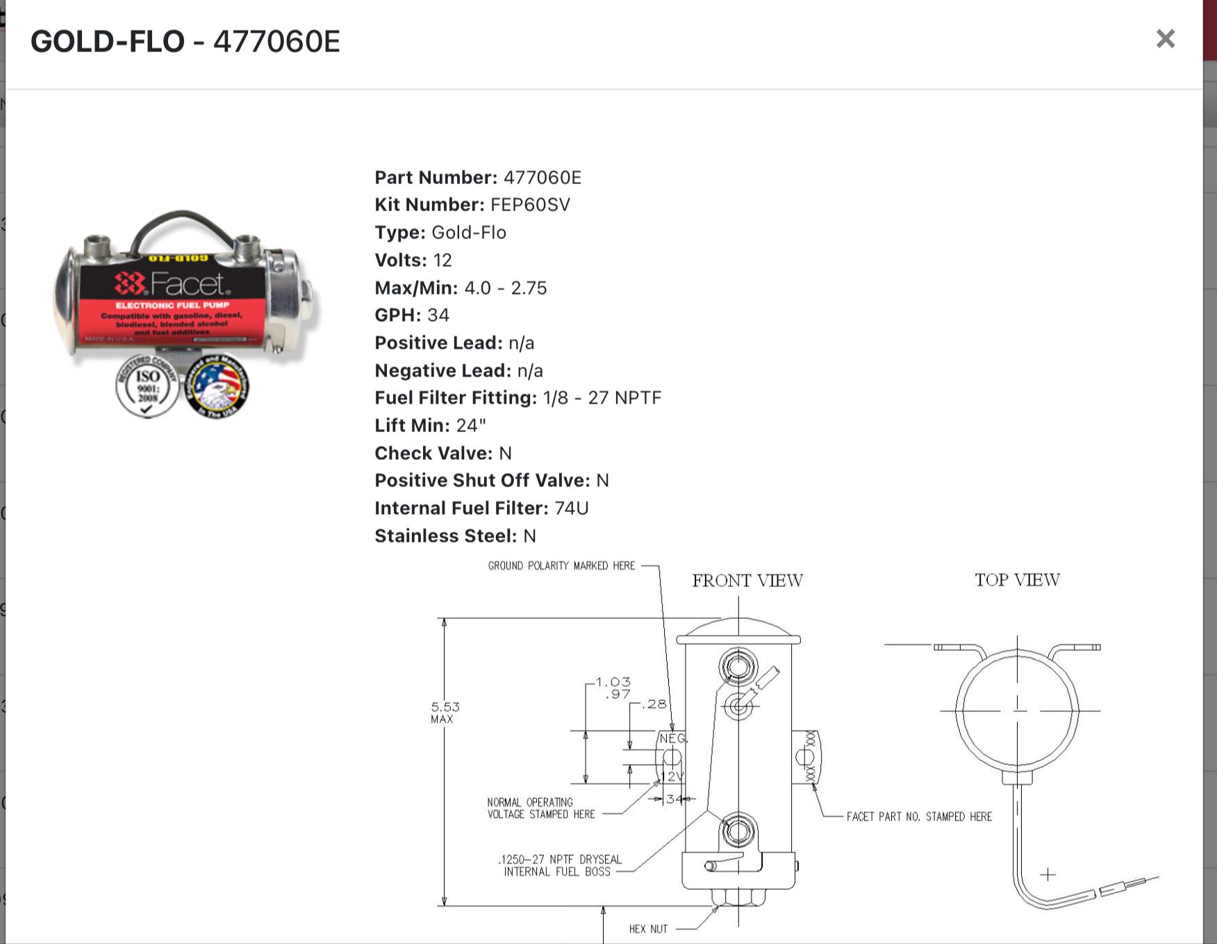

Well, it's been almost a month since my last update.  The fuel tank is back in, and besides a quick adventure with a blown heater hose I've still been struggling with this damn fuel system.  It looks like I've just had my second mechanical fuel pump quit on me in a month.  It seems like everyone has had some issues with these reproduction pumps, but two in a month sounds like very bad luck.  My first though was that my return line was plugged and putting too much backpressure on the pump, but I was able to blow through the return without too much resistance.  Can anyone think of what else could be causing these pumps to die, or is that just how it goes with these pumps?
I'm strongly considering just biting the bullet and going with an electric pump (probably this K&N one) unless someone wants to talk me out of it.
