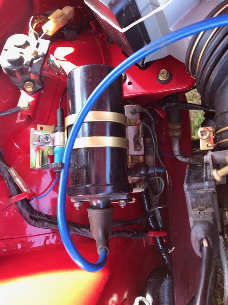

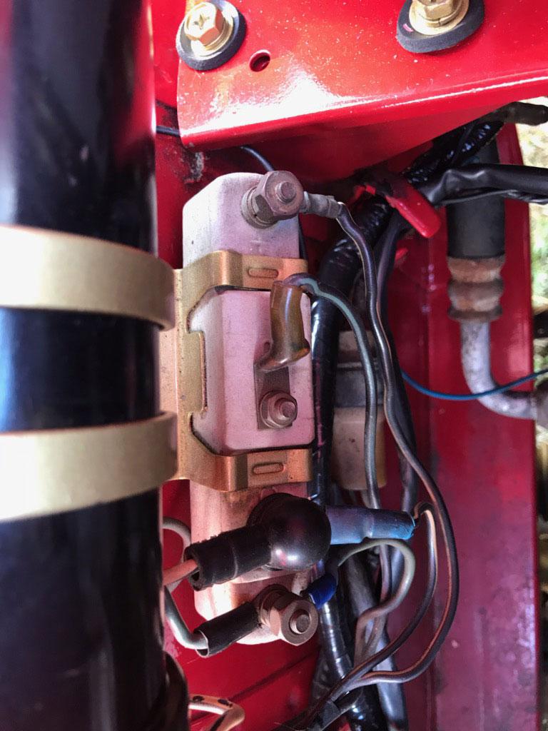

Here's a couple of pix of the coil/res. Let me know if you need more
Which color goes to the coil + terminal.  I really would not like to take my educated guess. Thanks.

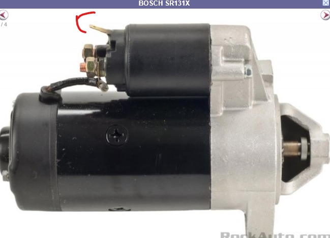

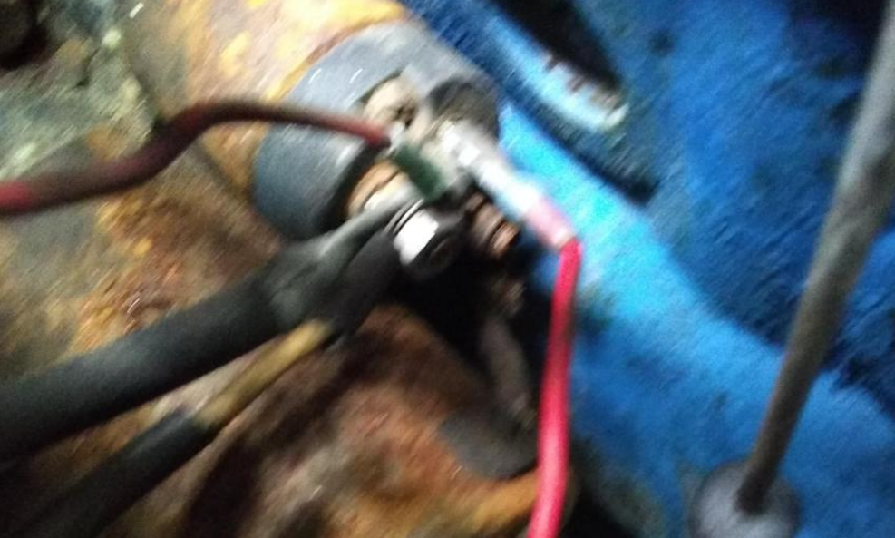

If you don't mind I need a couple definitions.
START = all the way clockwise but not trying to kick in the solenoid / starter
The yellow or whitish wire is the one to disconnect?  (It goes from battery to inside of the larger wiring harness which goes into the dash board. )
[Guessing here, the only thing connected is the Accessories wire that runs directly from the + battery lead connector. ]
[the 2 red wires are what replaces the Yellow Solenoid wire with the aftermarket relay. If I ever find all my wiring, I plan to replace those with yellow & yellow / red.]
thanks.
Edited by iscnetwork
added more info

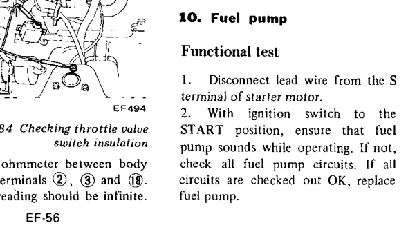

Yours is red now.  The one that pulls off by hand, no wrenches needed.  With it disconnected the starter solenoid will not energize, only the fuel pump, and CSV, etc.  The engine won't spin so you'll hear the pump.  It's a good way to run the pump and flush out the system with fresh fuel, if you're worried about that.  You can also use it to check your fuel pressure, without engine vacuum.
