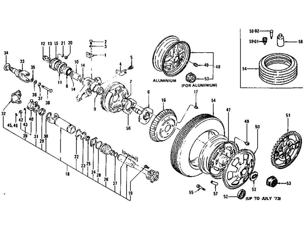

I was wondering if the rear wheel grease catch (the bracket that the wheel studs go through - part 56) can be eliminated without issue?  I am also converting the rear brakes to disk if that makes any difference.

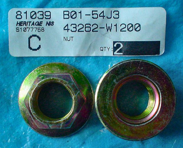

Interesting, what is different about the 280zx axle nut that it doesn't need to be peened?
The 280ZX used a distorted thread prevailing torque type nut.
Pic. Thanks Blue!!
Pic. Thanks Blue!!
Thanks Captain!  So is this some sort of self-locking nut magic?  Is it a one-time use nut also?

If you look at the face (hex) side closely and you can just see the dimples at third spacing. That makes the nut self locking. Yes, they are supposed to be reuseble
This is good info.  Can I use the original 240z washer with this nut?
Yes, you use the same original washer. Everything else is the same except for the nut.
Every distorted thread nut I've ever come across is listed as "one time use" and is non-reusable. That said, depending on the application, sometimes I violate that directive and reuse them. However for this application, I would not do that. I would get new ones. But if you do this job right, you hopefully won't be needing to go back in there again for a long time.
