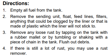

One of the keys to using Red-Kote is to make sure it's dried/cured before adding fuel.  Also notice that they do not say that all rust has to be gone.  Just most of it.
http://damonq.com/red-kote.html
http://damonq.com/TechSheets/Red-Kote.pdf

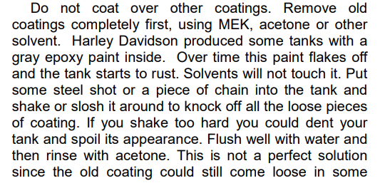

i think u might be right, and i’m pretty certain there’s no pin holes. i’m hesitant to do redcoat then make it worse . i can’t get that remaining previous sealant i believe is what it is to come off any better. i don’t know if the red kote will stick to the old stuff real good or not

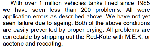

If that stuff is old sealant then you're right to be careful.  Some sealers have a curing reaction that happens after the solvent is gone.  That will make it more difficult for new sealant to stick to it.
But, Red-Kote is apparently completely soluble.  So it can be stripped out if there's a problem.
dang good thing i didn’t do the red kote yet . i’m letting it dry out now. after that last acetone it does look just barely better. i think that sealant in there now isn’t gonna come out unless i take to a radiator shop but i’m gonna run with it way it is now. i blew through all the hose lines on the tank and could hear solid air throughout all of them.
