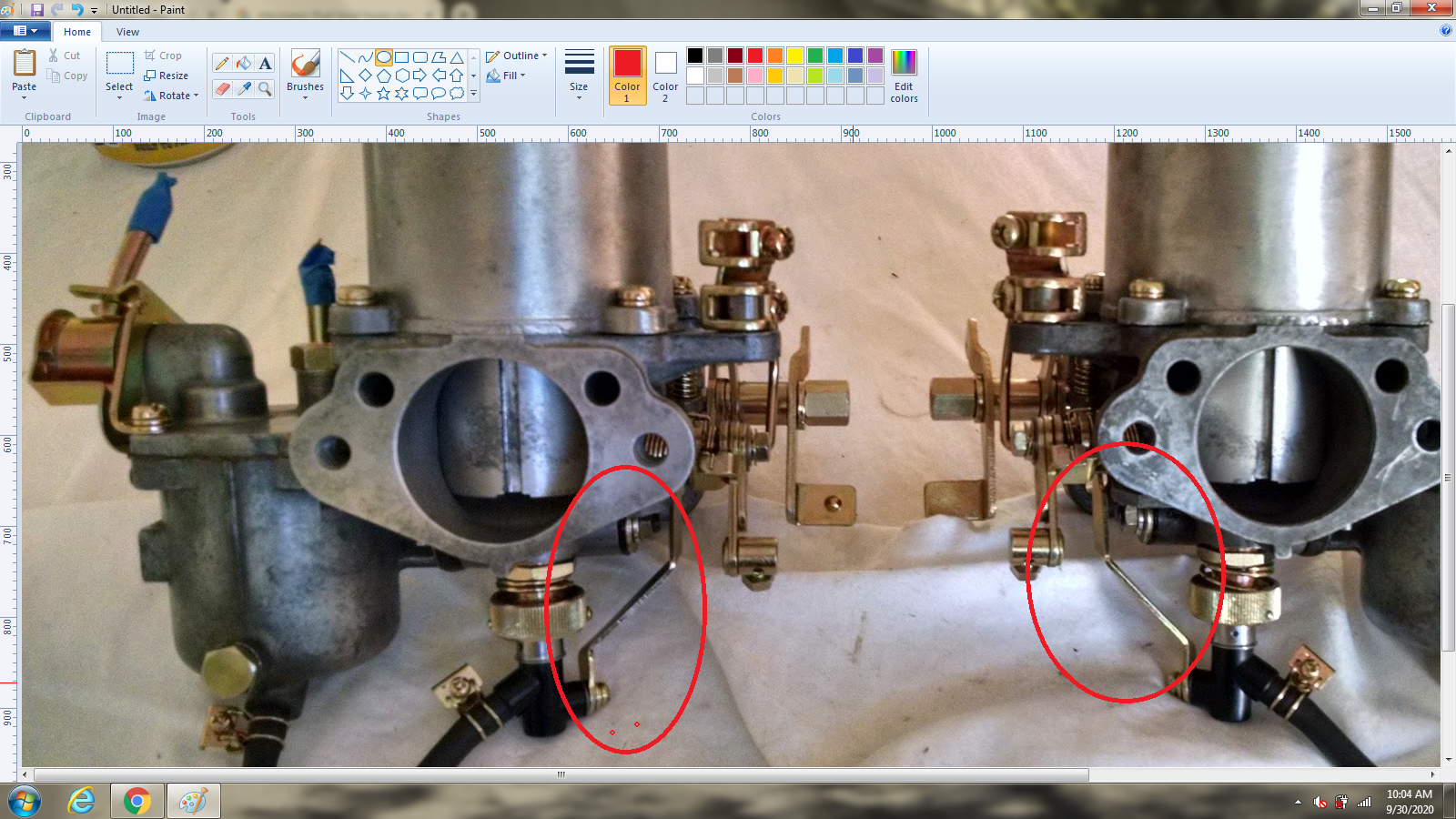

September 30, 20204 yr comment_606888 Great, it would seem the needles, pistons and domes are in good shape. Earlier you mentioned the choke not working on one carb.There are a couple of things that will cause the nozzle to bind up. The fuel hose to the nozzle needs to be ultra flexible. Ztherapy sells silicone hoses. The other problem can be the linkage that pulls the nozzle down and pushes it up. Over time, the flat-bar linkage can warp a bit causing the nozzle to bind up. The carb will have to be removed to check the linkage alignment. Check to see that both ends of the linkage are parallel to their mounting surfaces and lube the outer surface of the nozzles before assembly. Another thing to check is the float levels. The float level is the primary mixture adjustment. You'll definitely need a Uni Syn for balancing the carbs. Link to comment https://www.classiczcars.com/forums/topic/64491-240z-running-rough/?&page=3#findComment-606888 Share on other sites More sharing options...
September 30, 20204 yr Author comment_606889 49 minutes ago, Mark Maras said: Great, it would seem the needles, pistons and domes are in good shape. Earlier you mentioned the choke not working on one carb.There are a couple of things that will cause the nozzle to bind up. The fuel hose to the nozzle needs to be ultra flexible. Ztherapy sells silicone hoses. The other problem can be the linkage that pulls the nozzle down and pushes it up. Over time, the flat-bar linkage can warp a bit causing the nozzle to bind up. The carb will have to be removed to check the linkage alignment. Check to see that both ends of the linkage are parallel to their mounting surfaces and lube the outer surface of the nozzles before assembly. Another thing to check is the float levels. The float level is the primary mixture adjustment. You'll definitely need a Uni Syn for balancing the carbs. i did order some new float bowl to carb lines and throttle return springs from them yesterday. when i was taking the dome off the rear carb it did stick a little and was a little harder to pull off . the front one came off with ease. i’m not sure if that means anything but when it was all tightened up the piston seemed to move fine . i’ll have to attempt to check the linkage. this might be a really dumb question but is the linkage that connects to the nozzle controlled by the choke? Link to comment https://www.classiczcars.com/forums/topic/64491-240z-running-rough/?&page=3#findComment-606889 Share on other sites More sharing options...

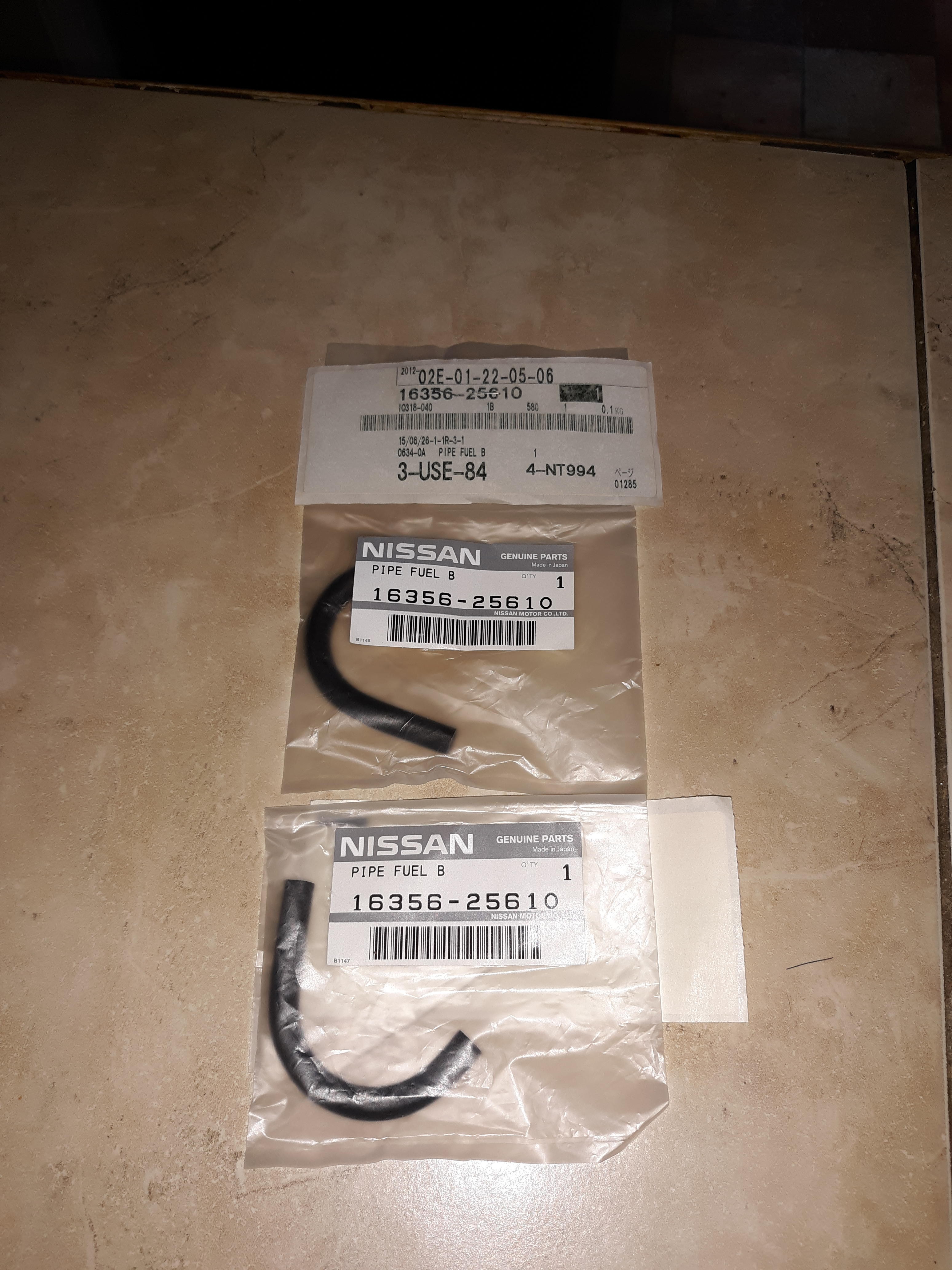

September 30, 20204 yr comment_606891 I bought these a few years ago from my local dealership. They will have to order them but it seems like they were there in a day or two. Call the parts department and read off the numbers 16356-25610. They'll punch them in and tell you if they are still available. My guy told me the reason they still carry these was for Nissan forklifts. Link to comment https://www.classiczcars.com/forums/topic/64491-240z-running-rough/?&page=3#findComment-606891 Share on other sites More sharing options...
September 30, 20204 yr comment_606892 Well I missed you on that one! Got a couple of windows open... Here's what Mark is talking about I think. Link to comment https://www.classiczcars.com/forums/topic/64491-240z-running-rough/?&page=3#findComment-606892 Share on other sites More sharing options...
