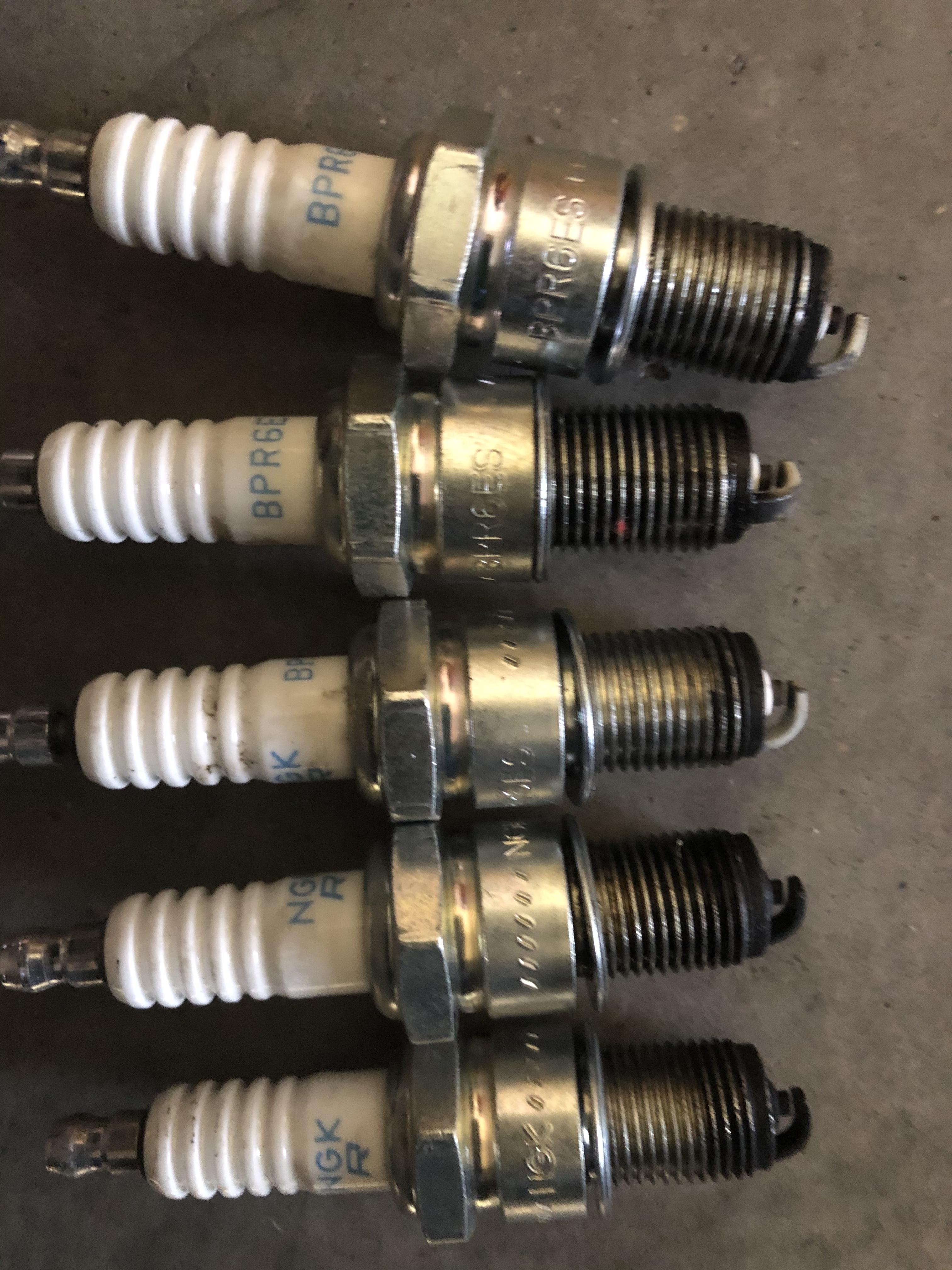

i haven’t adjusted the valves yet . i swapped plugs here’s a picture of them. front 3 were whitish tan, back three black

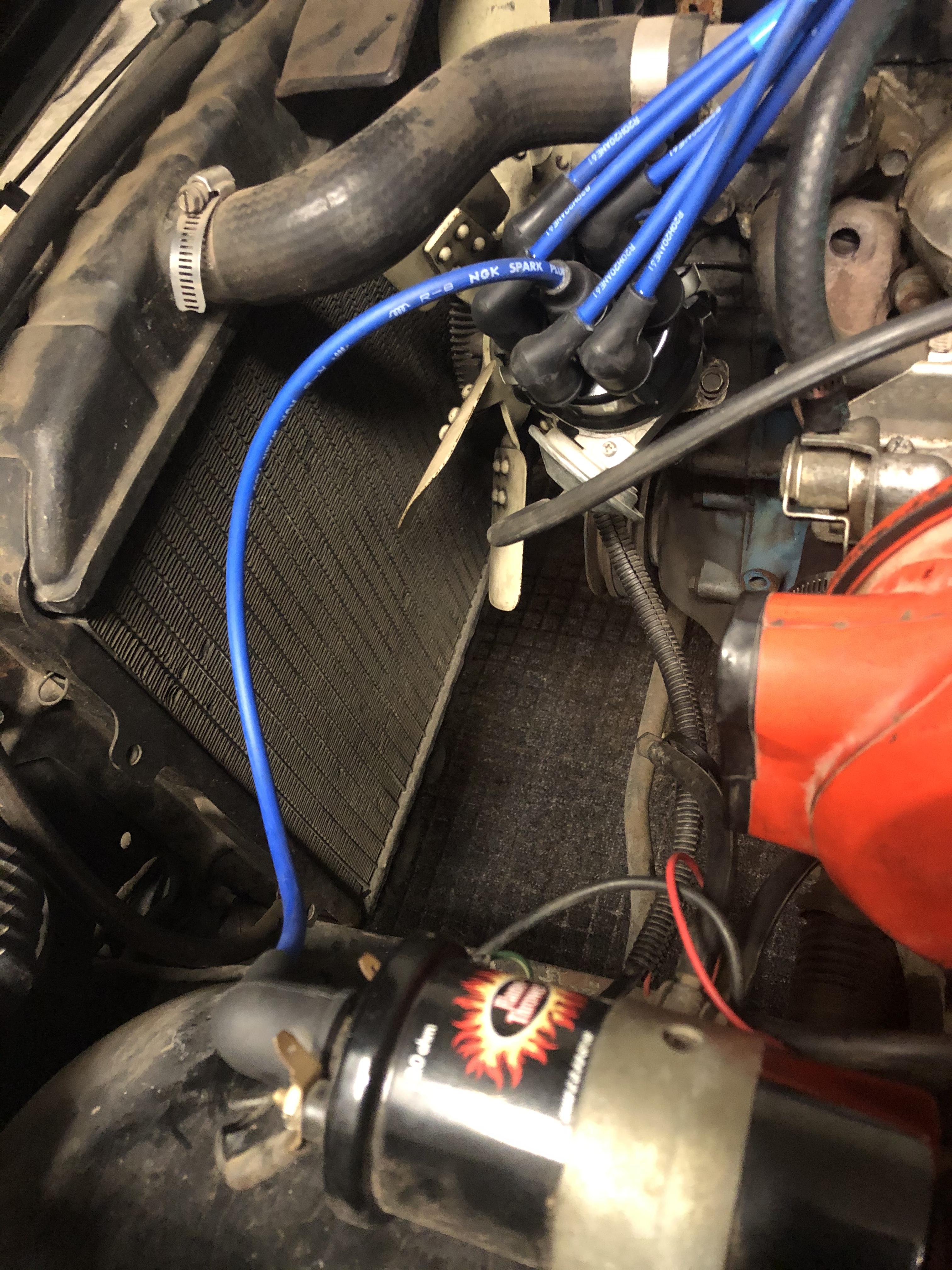

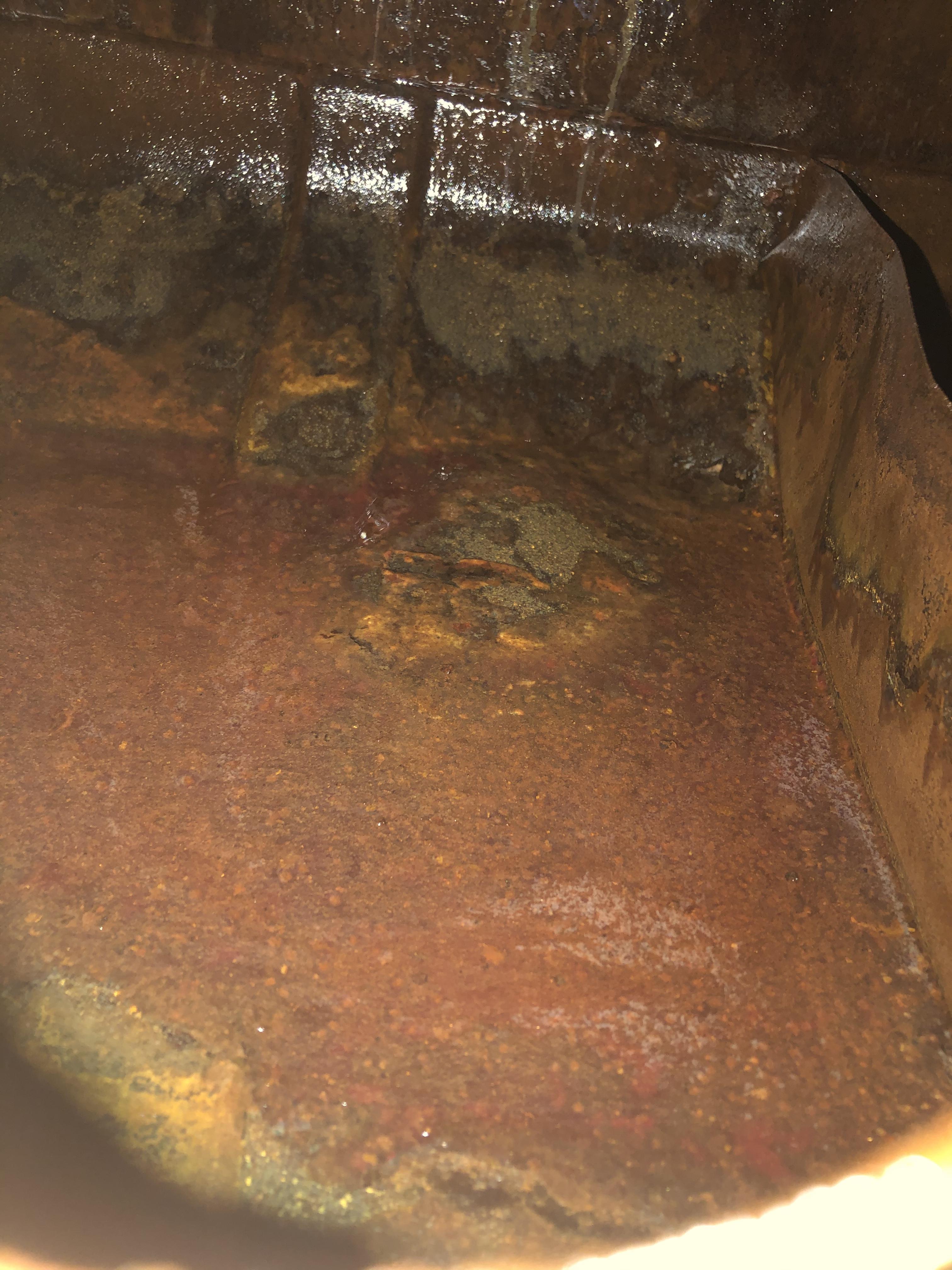

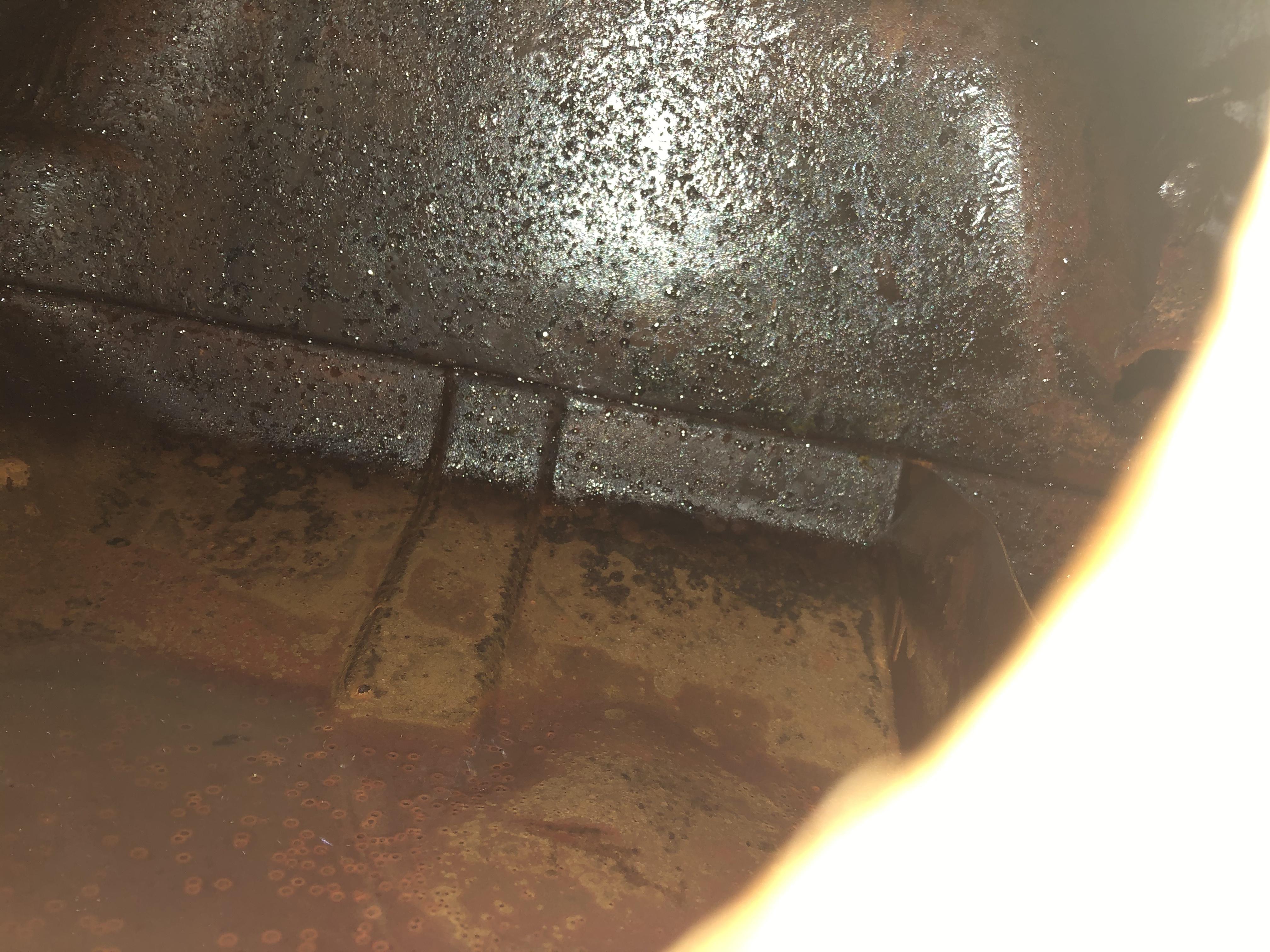

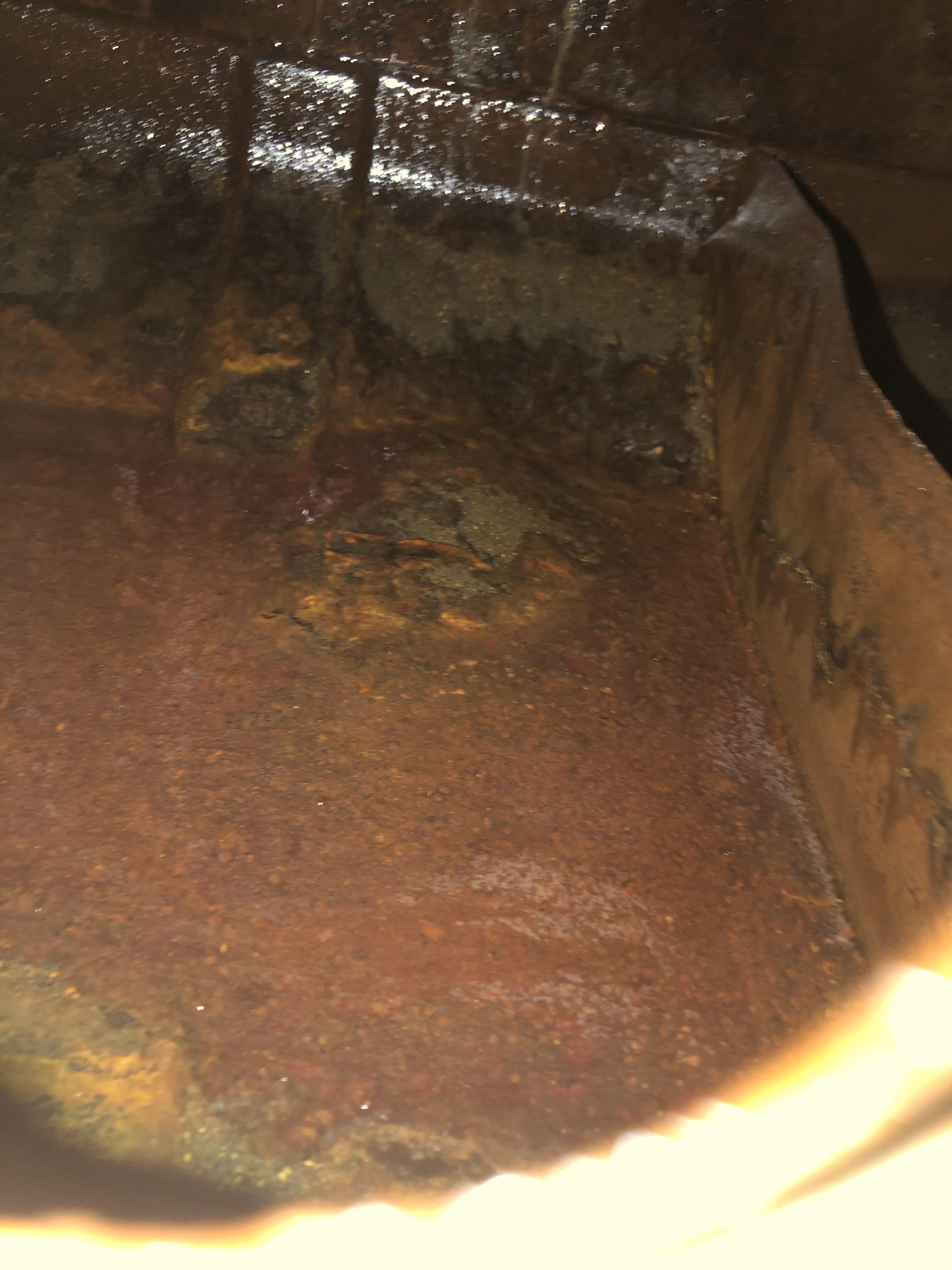

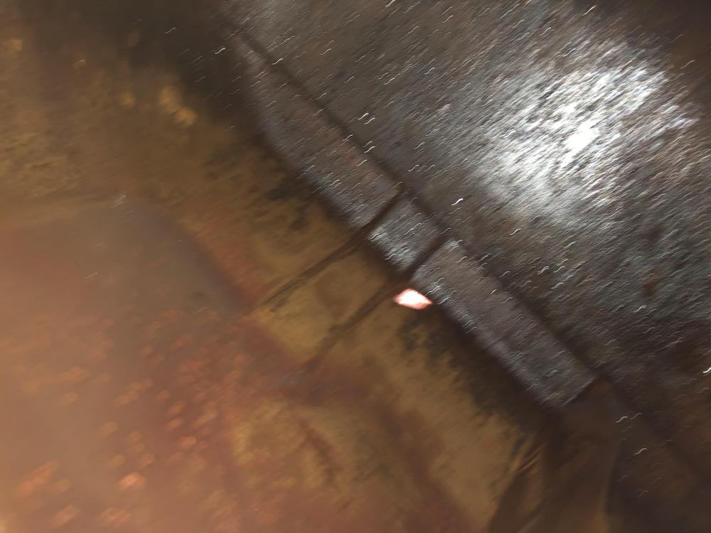

Where are the coils wires? Maybe they're tucked under? Looks like the air box is taped up in the front. What's the story on that? Your back 3 are missing spark or too much fuel for sure. If it'll crank and idle at all, do that and pull one plug wire at a time and see what it does. Just saw the tank photo. It looks good and clean.

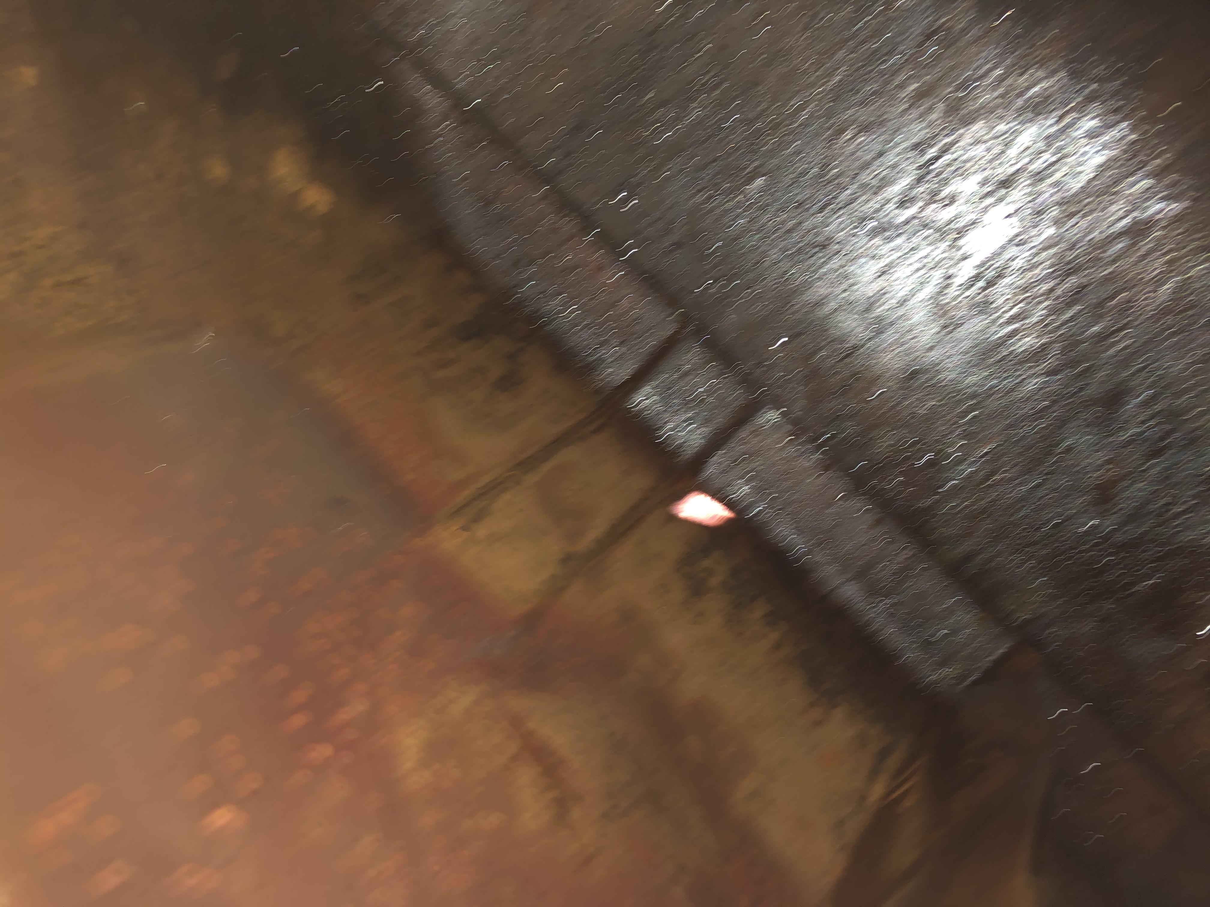

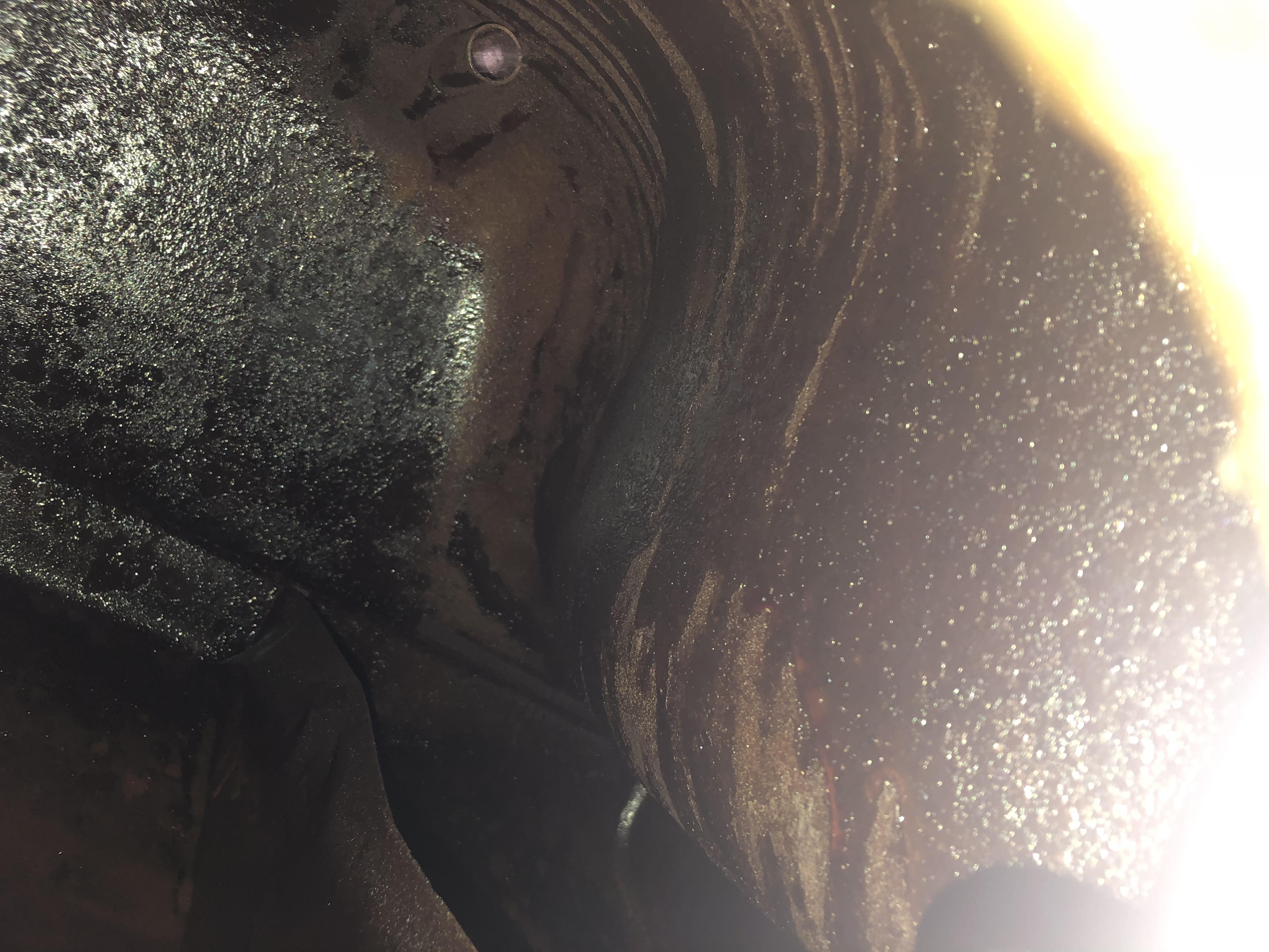

2 minutes ago, Patcon said:

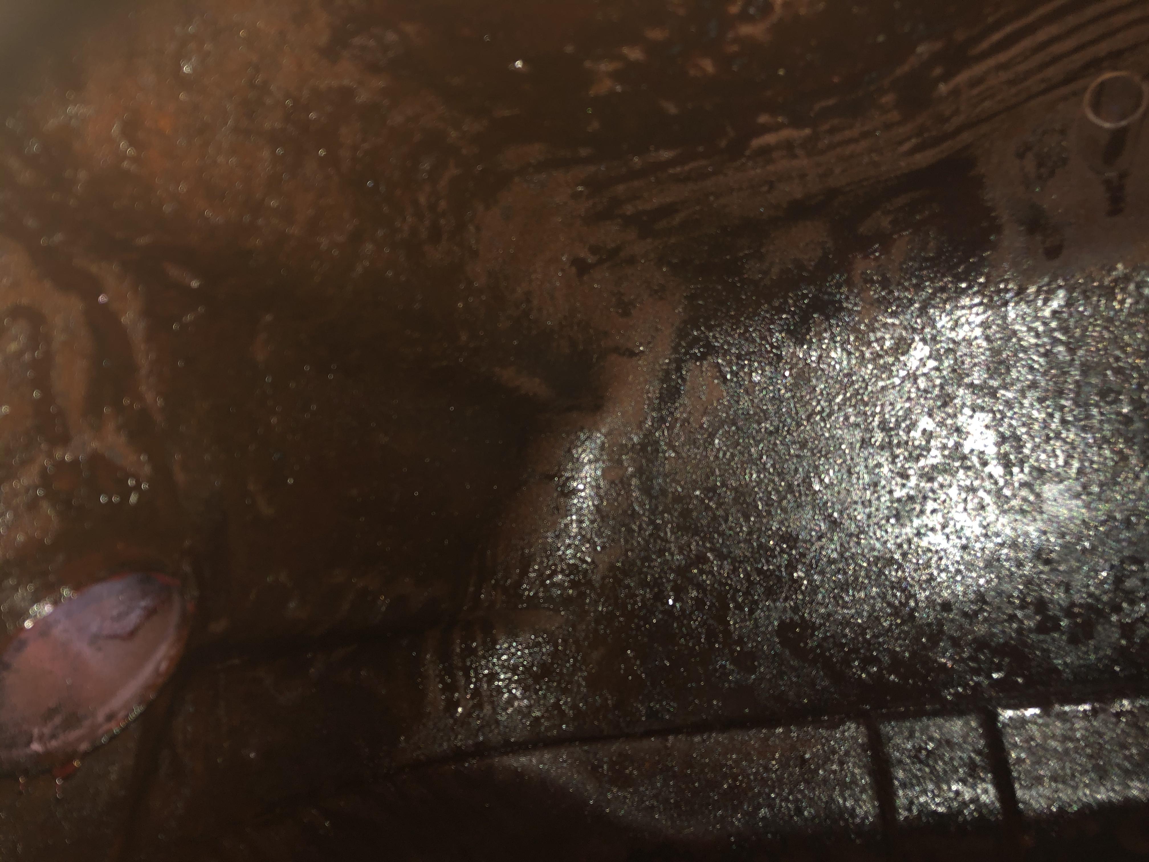

Looks like "red coat" in the tank. Its coming out with the fuel. The acetone made it worse. The tank coating is coming out. Needs redoing properly.
Might not be the main problem but will need fixing now
is it red kote or rust? do i run with the muriatic acid then do the baking soda and acetone after ? i’m contemplating buying a new tank but they’re $600
Awe man that's needing an acid wash. I don't see any red kote just rust. I can find some info on my cleaning tomorrow. The Tide is on now so I'm OUT.
