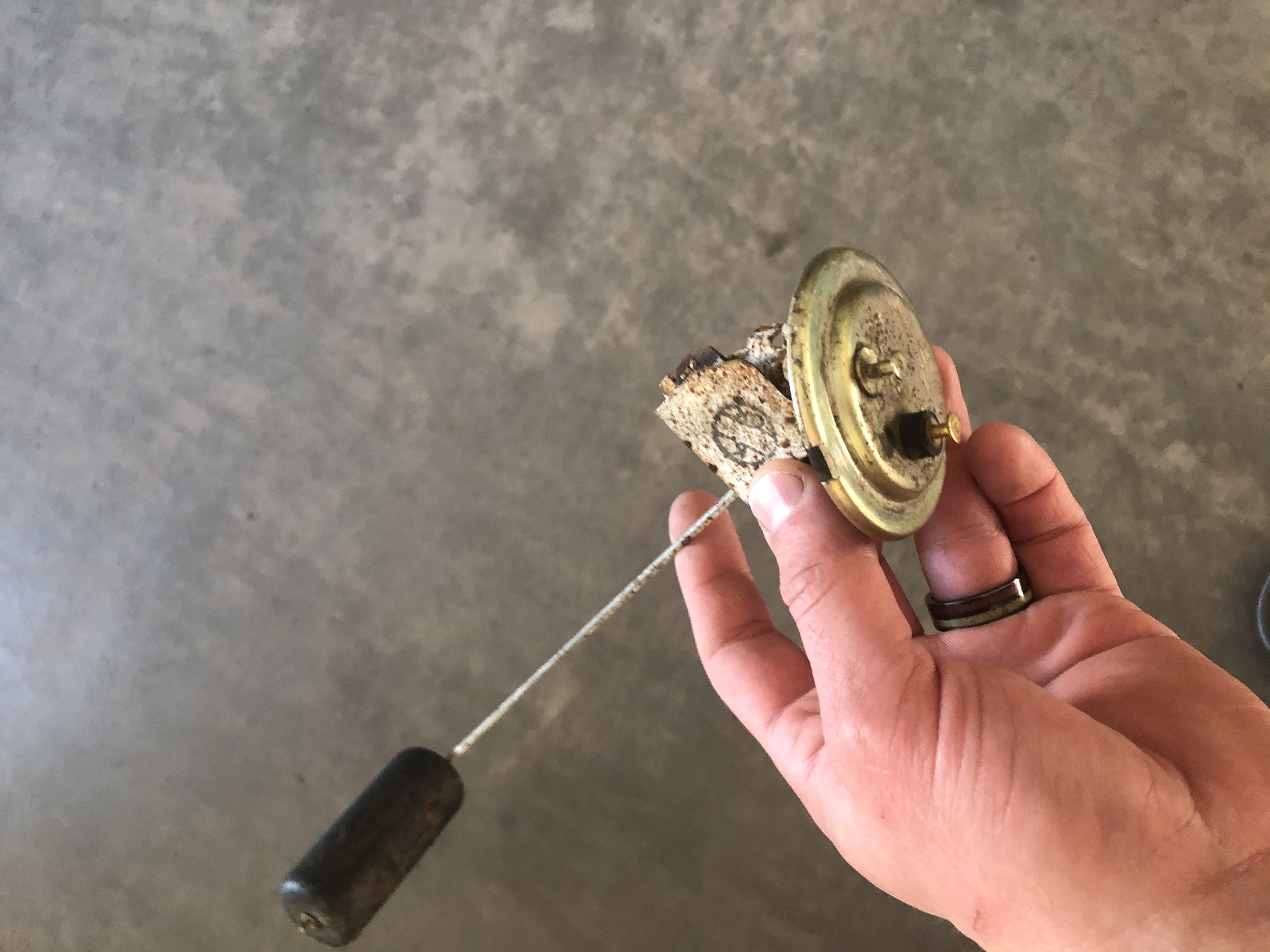

October 13, 20204 yr Author comment_607876 i got some muriatic acid, acetone and red kote . im going to see if i can get it done today or tomorrow . do you leave the sending unit in assuming the red kote is not good for it and order a new one or take it out and mask it off ? Link to comment https://www.classiczcars.com/forums/topic/64491-240z-running-rough/?&page=9#findComment-607876 Share on other sites More sharing options...
October 13, 20204 yr comment_607880 It depends on what the sending unit looks like. When you drop the tank take a pic of the sending unit and post it here. It may be newer and not needing a replacement since the PO did the tank already. Link to comment https://www.classiczcars.com/forums/topic/64491-240z-running-rough/?&page=9#findComment-607880 Share on other sites More sharing options...

October 14, 20204 yr comment_607933 But don’t red kote the sending unit! Link to comment https://www.classiczcars.com/forums/topic/64491-240z-running-rough/?&page=9#findComment-607933 Share on other sites More sharing options...
