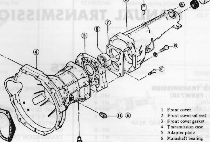

I sold the car so can't check.  I see that it's supposed to have it but am almost certain that mine didn't.  I do notice though that the drawing I posted also shows the outer dust sleeve on that tail section even though mine didn't have that.  But the ratios are from the same FSM.
