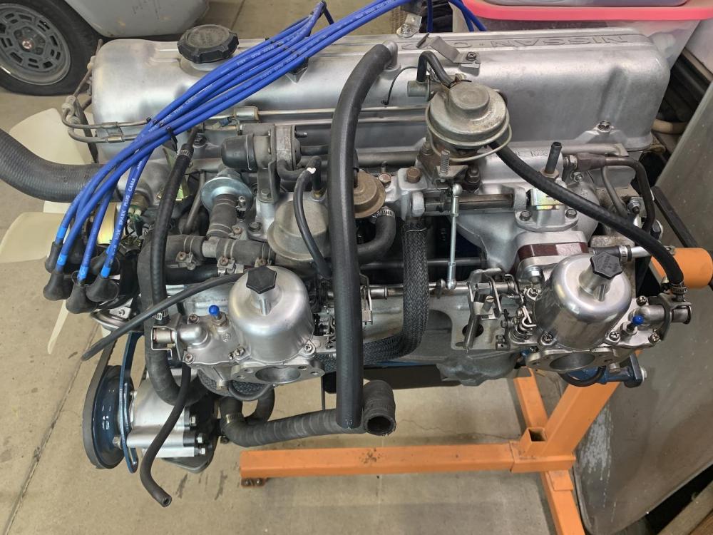

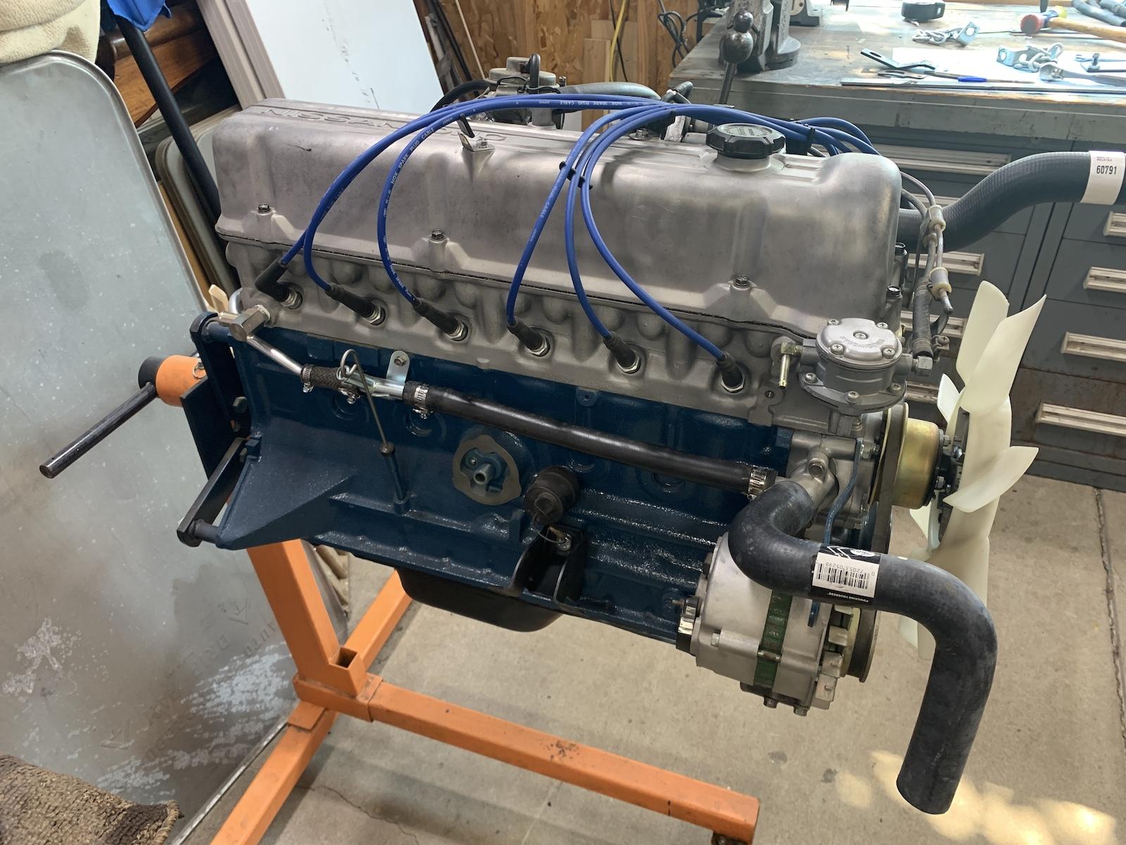

A good read on Site's thread, thanks!  I've got the same leveler, so I guess I shouldn't worry about it too much.  Years ago I pulled the motor sideways over the fender after removing trans.  I guess I'll do the the engine with trans method this time.  Hopefully no need to remove the front bumper, I'll do some measuring first.
Engine is not as great as some I've seen here, but will hopefully run good.  Decided to try to keep this 73 on the stock side, even the smog stuff.  Well, it does have earlier carbs.  I'll probably regret that choice later.  ðŸ™„

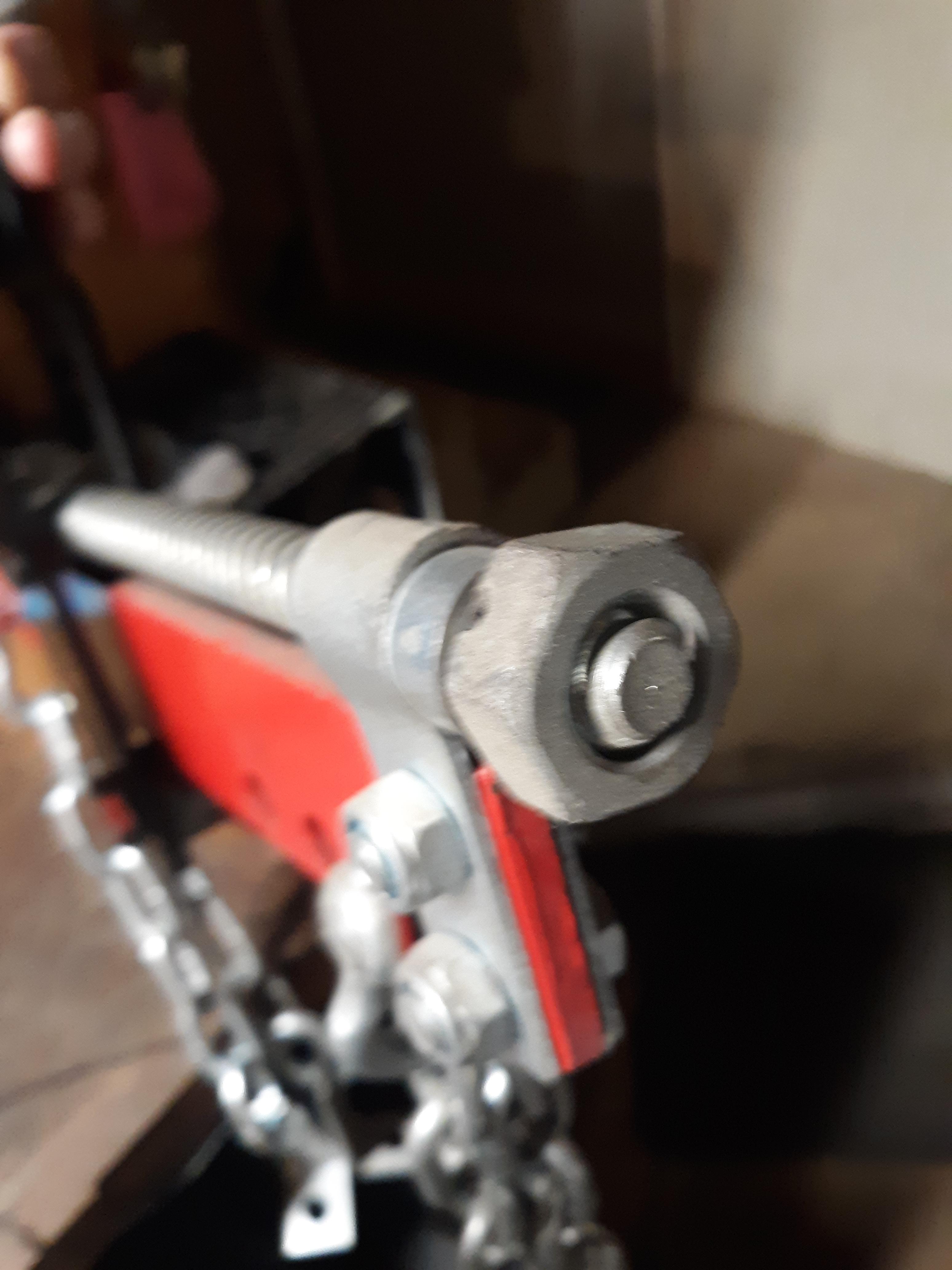

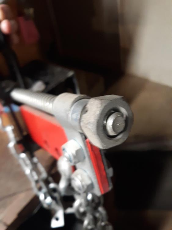

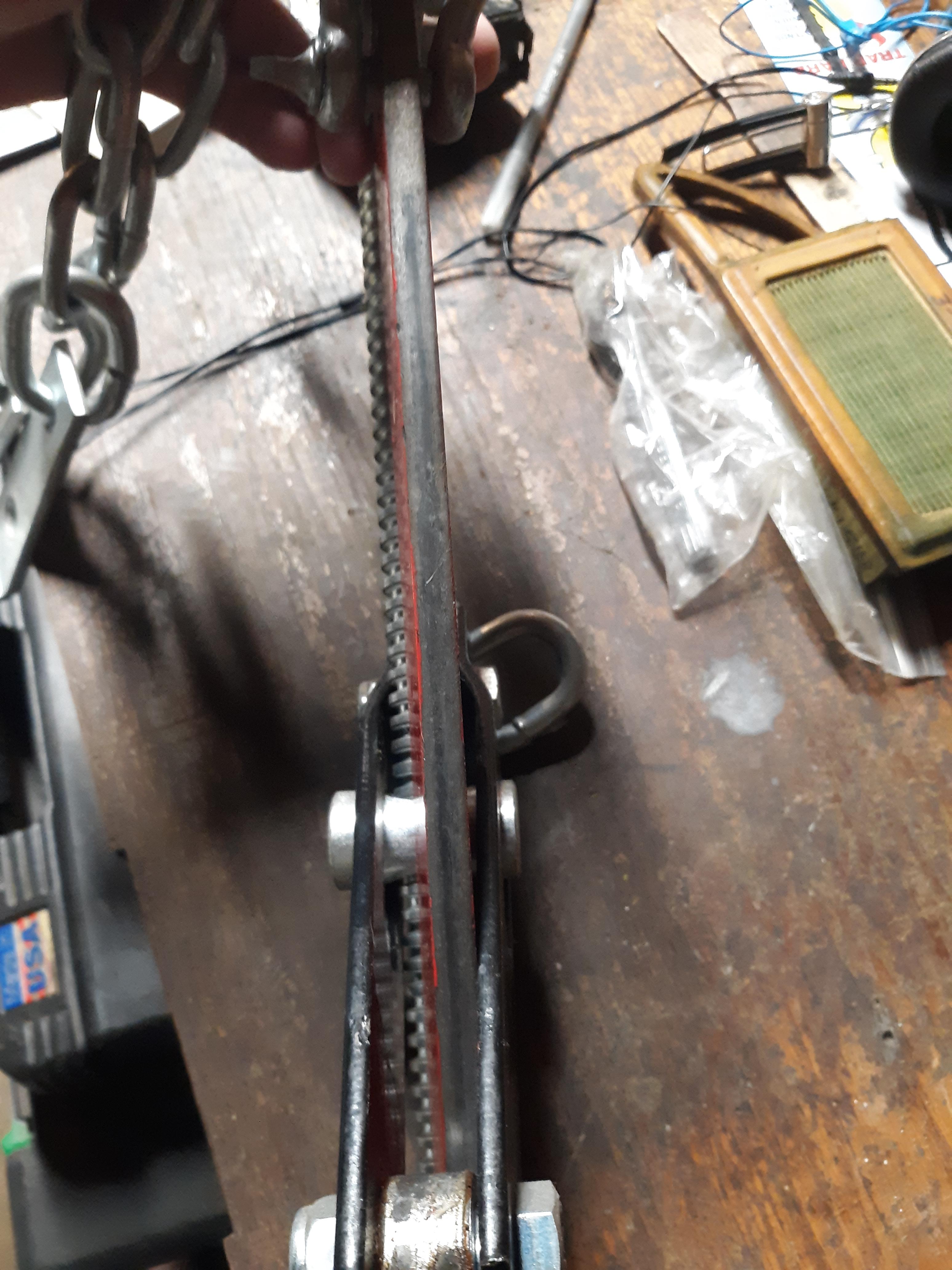

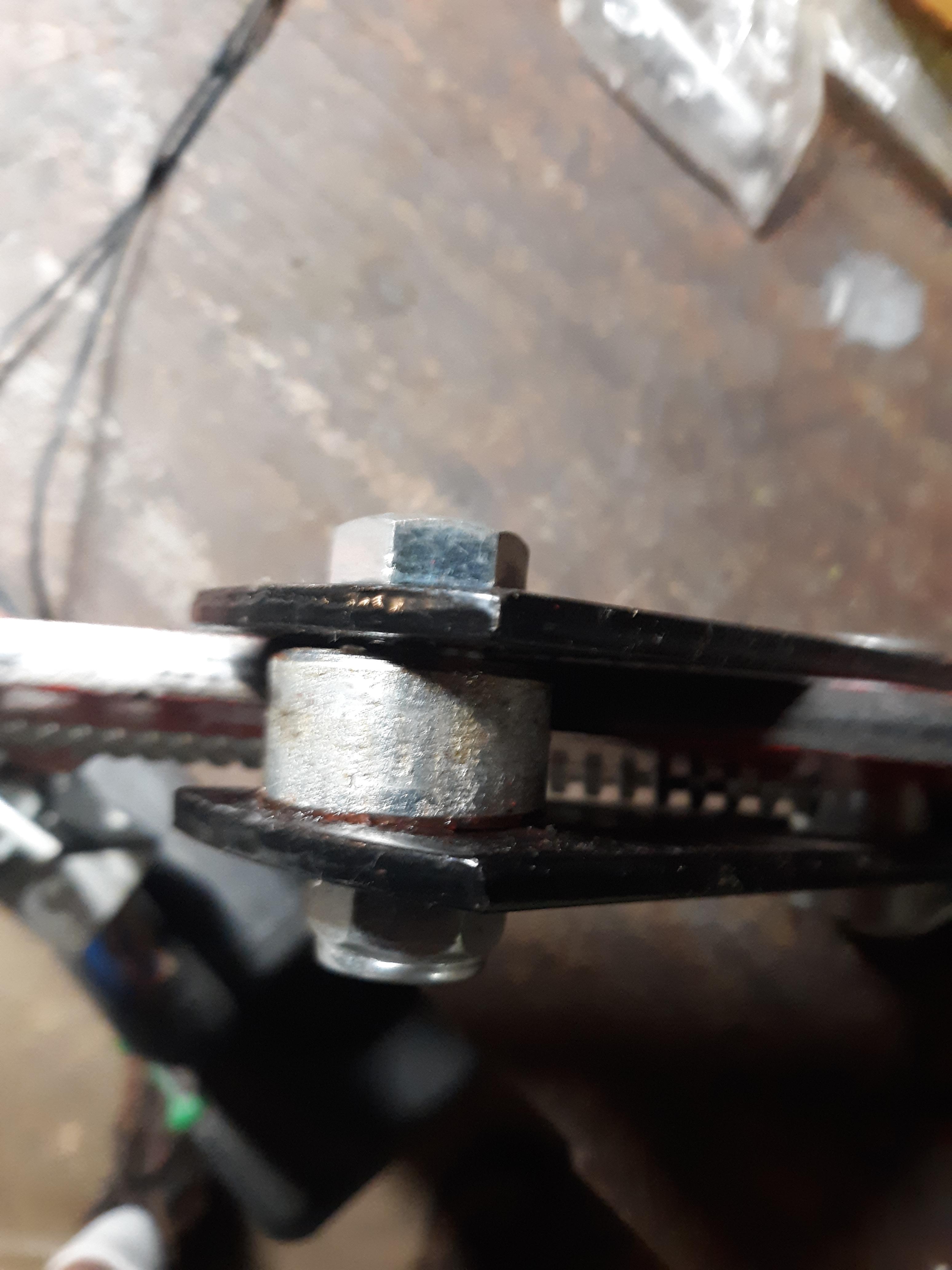

That leveler scared the bejesus out of me when I first used it, popping and jerking about with my motor hanging over my 280. I tweaked it a little and used a socket instead of the turn handle.
Scraped the paint off the bottom where the roller is. That made it smoother.
Then I used some axle grease on the roller and the bottom, even smoother.
Socket on the other end too.

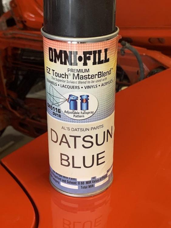

  On 10/2/2020 at 7:49 PM, Muzez said:
Love the paint color you went with. Can you share what you used? Looks so much cleaner than mine!
I ordered it from California Datsun.  Felt stupid at the time spending 30+ bucks for a rattle can, but is does look right!  ðŸ‘Œ  1 can did the block, brackets and air pump pulley, and still a bit left.
https://www.californiadatsun.com/paint-body/datsun-engine-true-blue-green-spray-can-paint.html

My local Z buddy here painted a block a couple years ago with that custom blue can from CA Datsun. Looked great compared to the stock color (when compared to other things like the harmonic balancer from that engine). Then he bought a second can about a year ago to do a second block and now it's a lot darker that it used to be. Doesn't match the stock color very well. Too dark and not enough green.
sfm6s524,  It's hard to tell from just a pic, but yours looks like the darker batch. There might be some overspray on the plate between the block and trans for a comparison?
