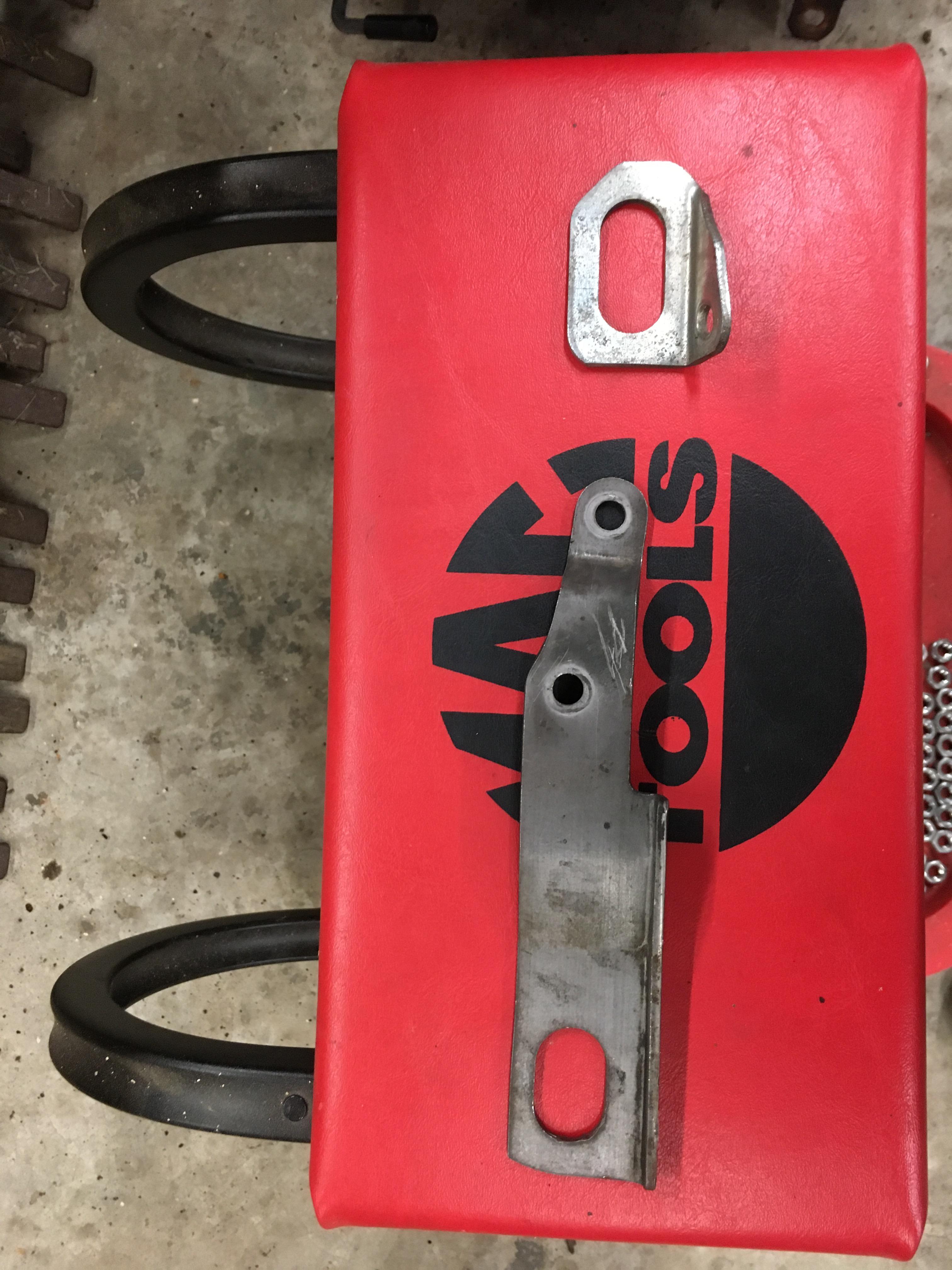

I ended up buying an inexpensive Harbor Freight lift.  I was able to get the engine out but the hydraulics in the lift were not strong enough to hold the load up for any period of time.  When I put it back in, I am going to use my tractor and loader in the driveway along with two sons to guide it in.
I read a previous post where using the two factory lift points was a bad idea.  Someone said they are not strong enough and would break.  From the pics, it looks like everyone is using those.  Has anyone had any problems?
I have a set of the factory lifting brackets that I use for engine removal and installation. Used them dozens of times swinging engine and engine/transmission in and out of my Z cars. After use they go back int the tool box to be used the next time they are needed.
Never had a bit of trouble with them.

The intake studs could be an issue with the factory lift points. I have never had an issue. You could just wrap a chain around the manifold in the rear which would spread the load over more studs. The rear point does the lions share of the work

Any chance you could post a sketch or pictures of your factory lifting brackets. I will be pulling my engine soon, transmission is already out.

OK, a quick and dirty cell phone pic.
The long one with 2 holes bolts on the right front side of the cylinder head just behind the fuel pump. The small one with one hole goes on the last exhaust manifold stud on the left rear of the head. My engine sling has tabs on the ends of the chains, and I use a 5/16” bolt, 2 fender washers, and a wing nut on each one to attach to the lifting fittings.328BC2FB-1FB0-44A2-B904-A60C062E8832.jpeg
