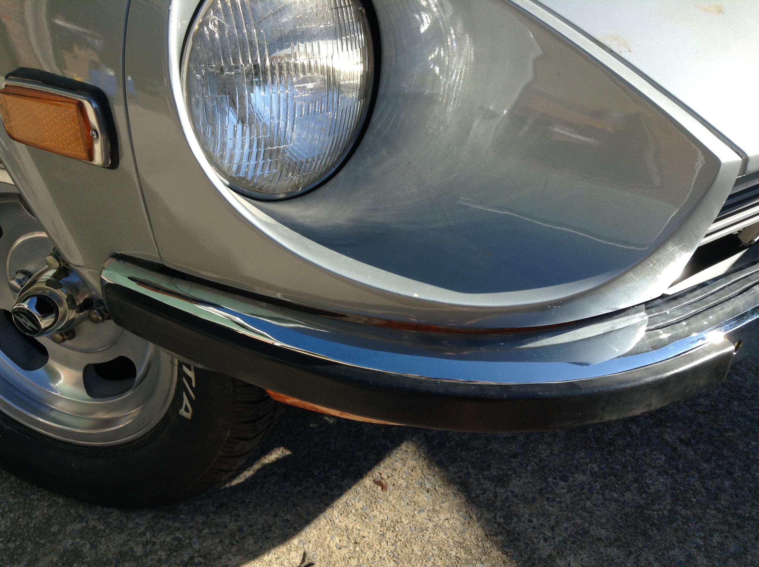

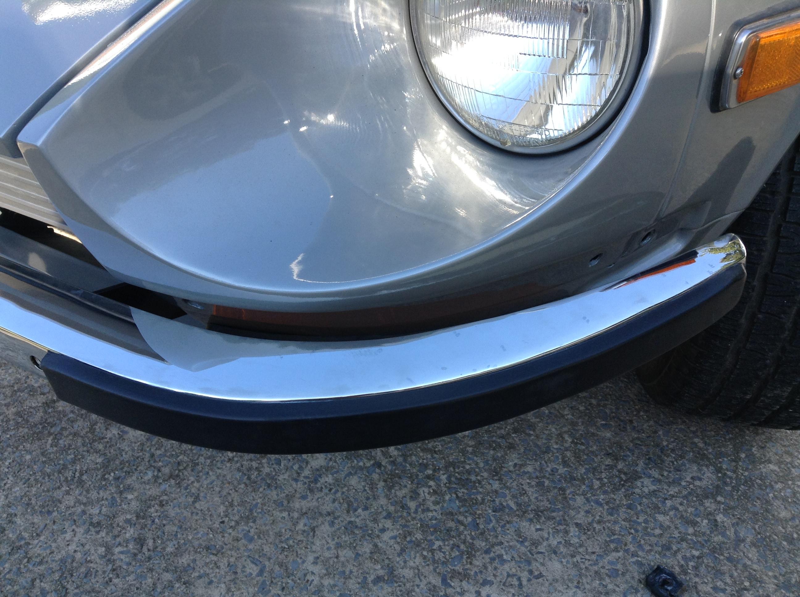

OK guys; what's going on here?
Passenger side perfect, driver side way off.  I got everything on loosely and then attached the passenger side bumper end bolt.
All the body panels are straight; everything lines up except for the bumper on the driver side.  Car has never been in an accident.
Both bumper brackets are identical length and profile (I checked).
I tried swapping them side-to-side; no difference.
The bumper brackets are all the way back in their slots behind the grille.
If I really force it, I can move the driver side bumper end close enough to fit the bolt, but it would be under some massive tension (would pull on the bodywork around the fender lip) and the part of the bumper under the headlight bucket still wouldn't align.
What am I missing here?

No sir.  It's original, but it got rechromed last year.

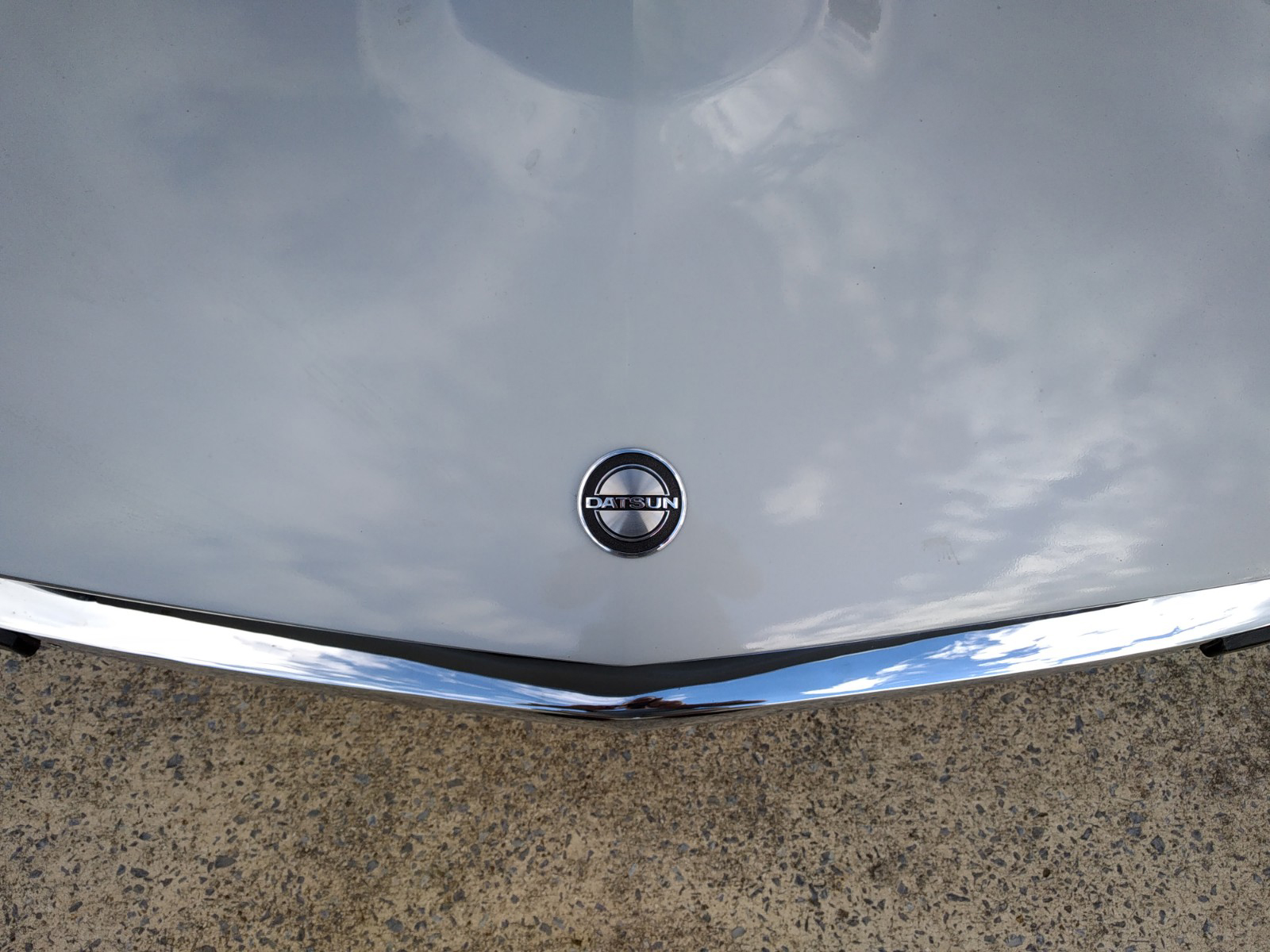

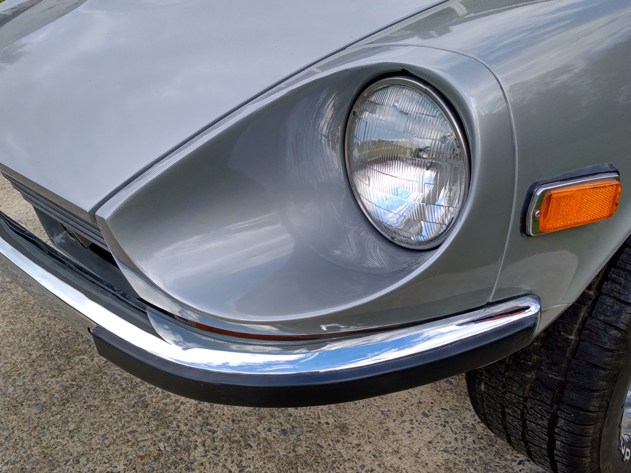

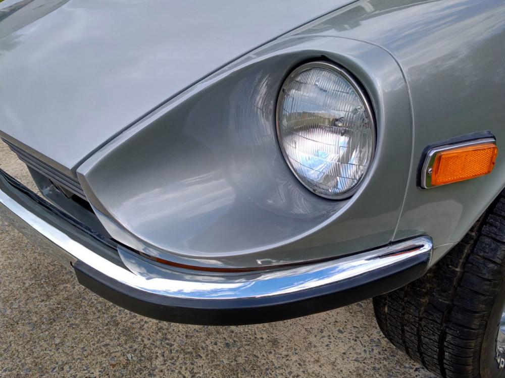

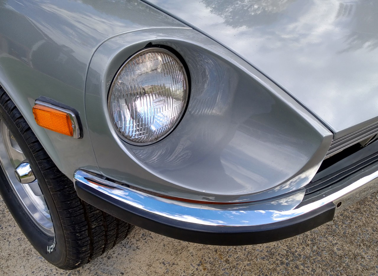

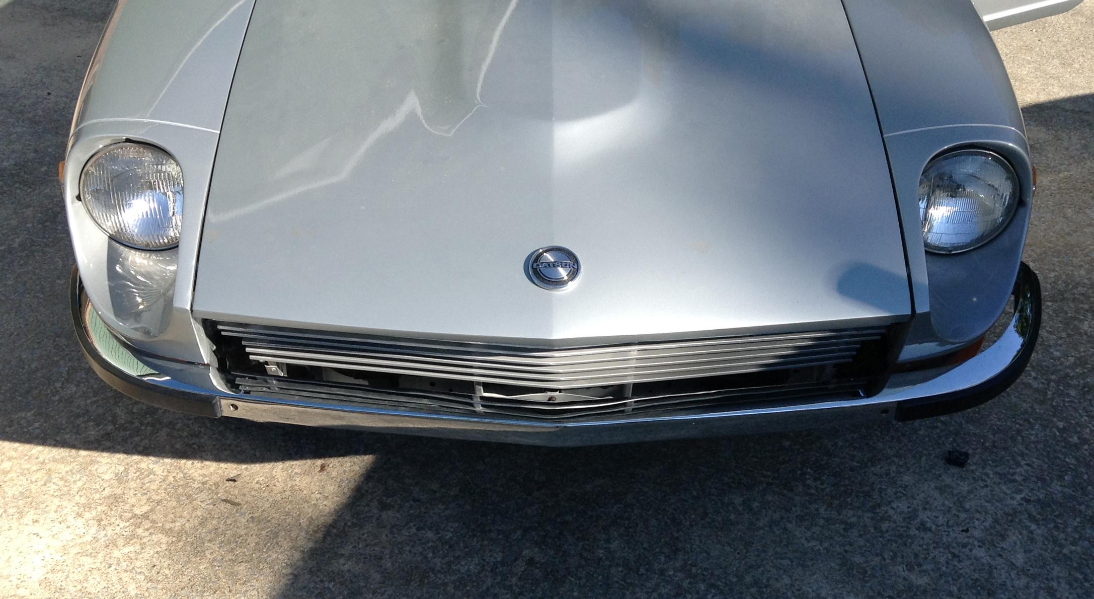

Here's a front view:
The bumper seems offset to the right just a bit.  Barring some "eureka moment," the only thing I can think to do would be to loosen the passenger side end bolt and try shifting it over.  I think the gap on the passenger side is perfect though...
If it fit before, it should fit now. Without the mounting brackets in play, the ends of the bumper should tuck right in to the fender recesses and I suspect they did just that prior to the chrome replating. To me that suggests that something happened at the plating shop that has warped or distorted the bumper. If you have a buddy with a OE bumper perhaps you could lay yours on his to check the shape and identify where the change is located. You are right in expecting stress on the body panels if you attempt to pull it in on one side or both - it should not need to be pulled in with the bolts.
It looks a bit close to me..  Mine  (is a 1971 feb. 240z) has a bigger gap.  Maybe use a shime.. (inside bumper) .  Loosen also the bolts of the 2 front brackets when you install the outside brackets.  The bumper ends should not really be IN the cavety's of the bodypanel.. just in front of them.
otherwise take the bumper off, (put it on a stable not damaging floor..  towels!) use a string fit it to the ends of the bumper with some ducttape and then carefully bend the lower and upper metal to the outside near the middle tip.
Use some tape (more layers.) to protect the chrome and extra clothes. also you need some flat steel To spread the force from the pliers and 2 sets of pliers..  When you put a little bit pressure on the bumper you'll see the string slacken.
Hope i sayd this right in english haha...

Sorry for the late follow-up here.  Been working on house projects for the last few months and today is the first time in a while I've been able to devote some time to it.
It actually only took me about 15 minutes to fix.  Undid the passenger side, centered the bumper, secured the middle and then cinched the ends down, no problem.
Thanks for the help guys.

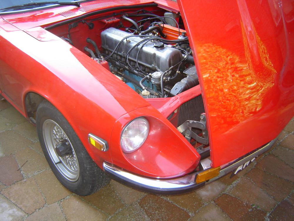

You need some rubber round thingy's to close those 2 holes in the front, orig. euro cars have them. these are about 3mm bigger then the hole is and stick out about 2,5 mm. And are a bit conical..
Here on the rear bumper to see, they are the same.
