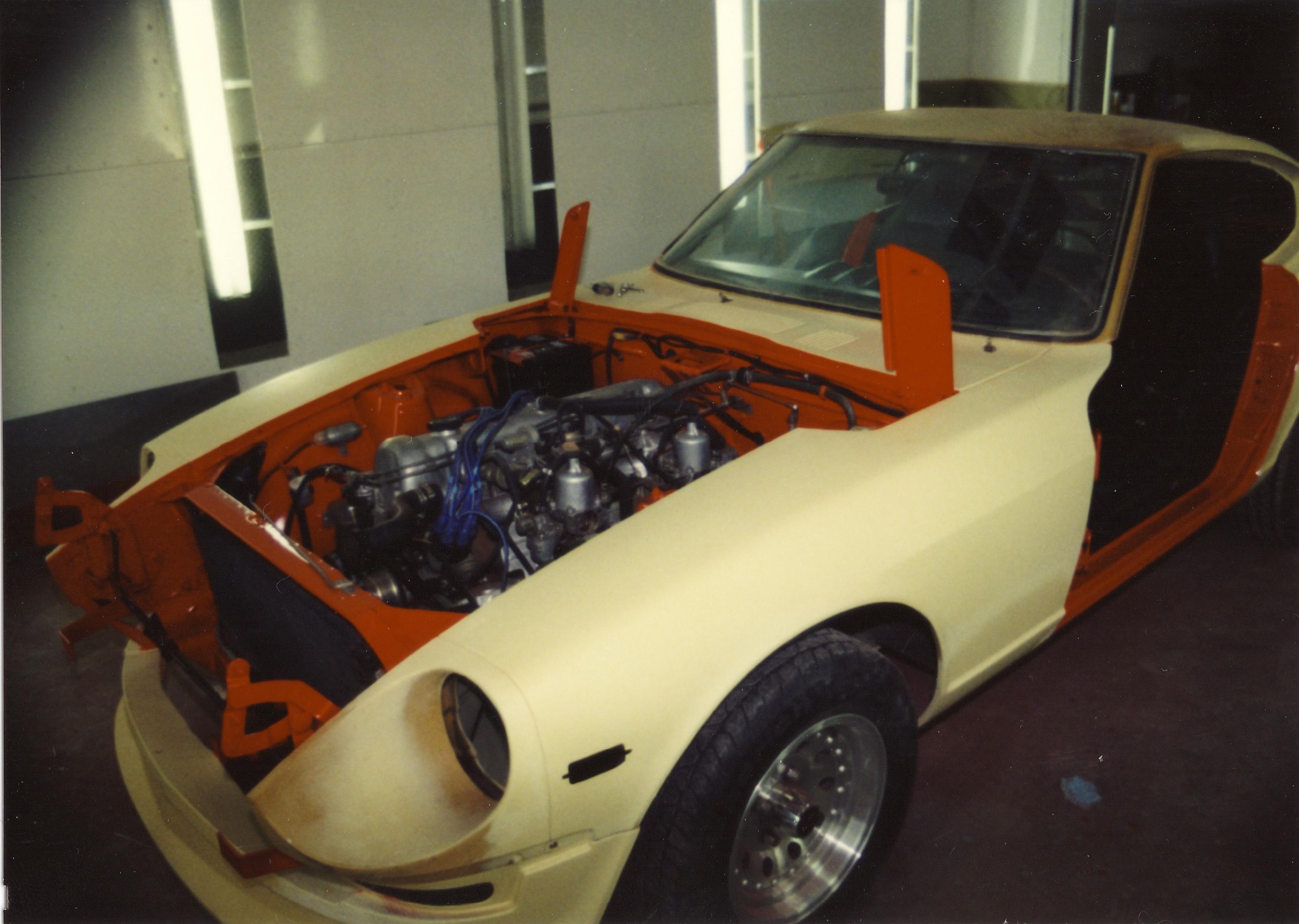

October 10, 20204 yr comment_607624 I too painted the engine bay without pulling the engine. Everything removable was removed and the harnesses were moved off the surfaces. My only mistake was not taping the nuts on the strut towers. Here's a pic right after doing the engine bay and jams most of the stuff has been put back in the engine bay except the radiator and yes, the windshield was pulled before we did the exterior. Link to comment https://www.classiczcars.com/forums/topic/64518-engine-compartment-color/#findComment-607624 Share on other sites More sharing options...
