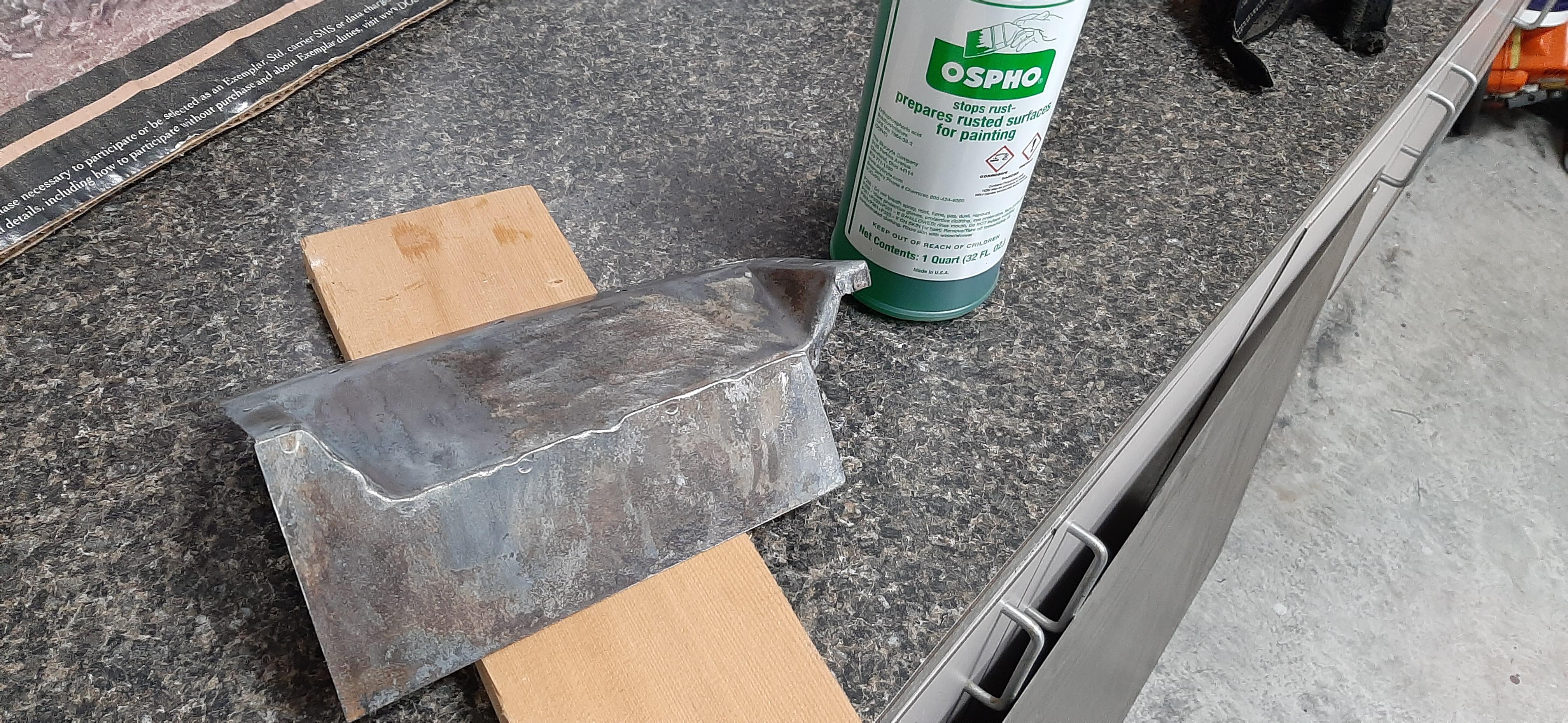

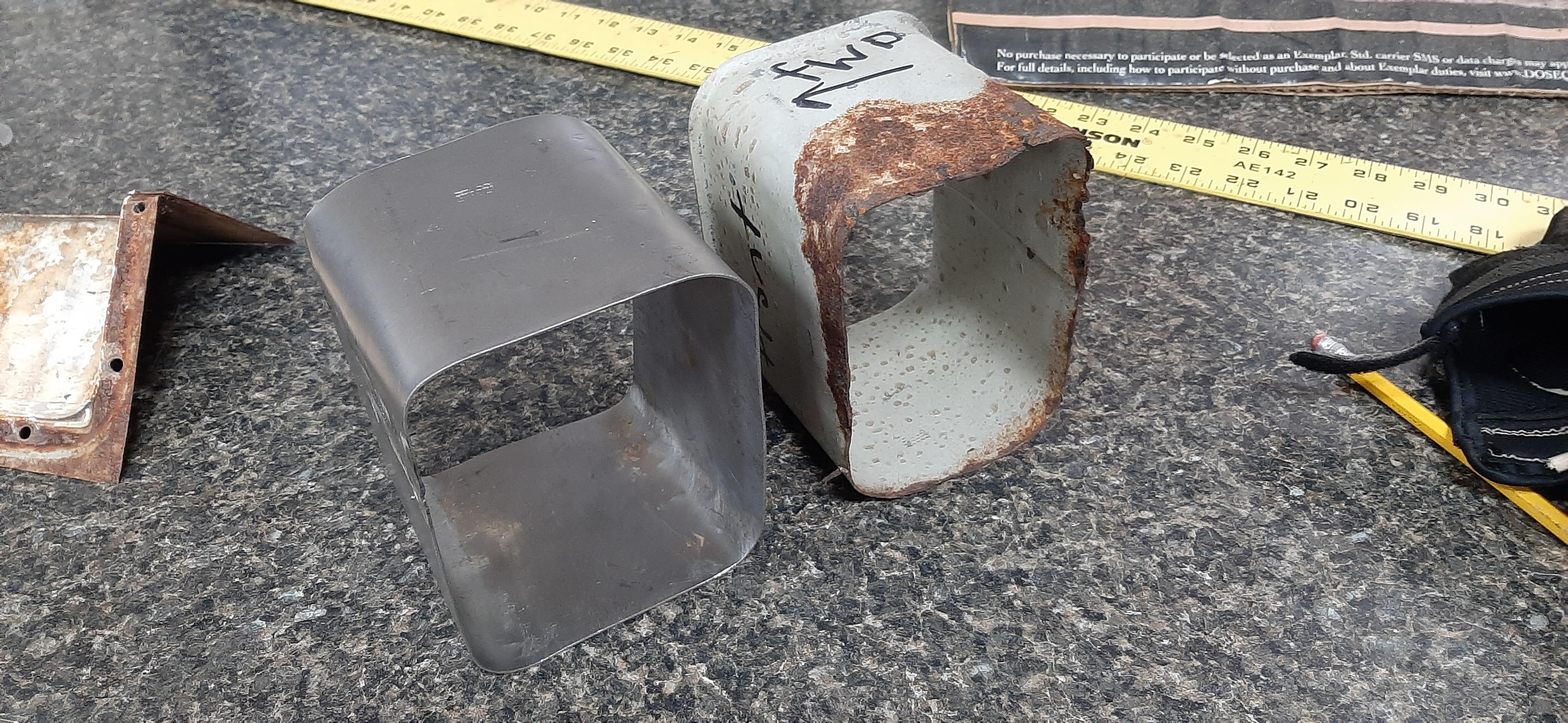

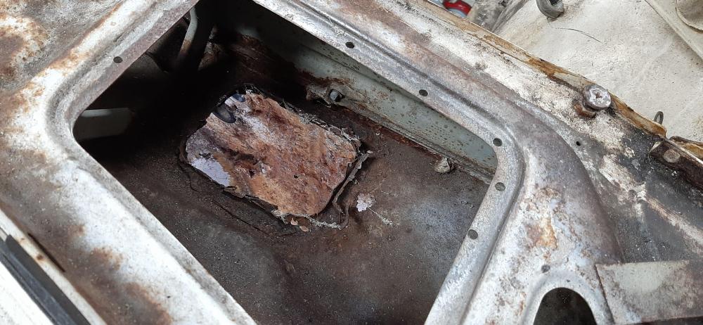

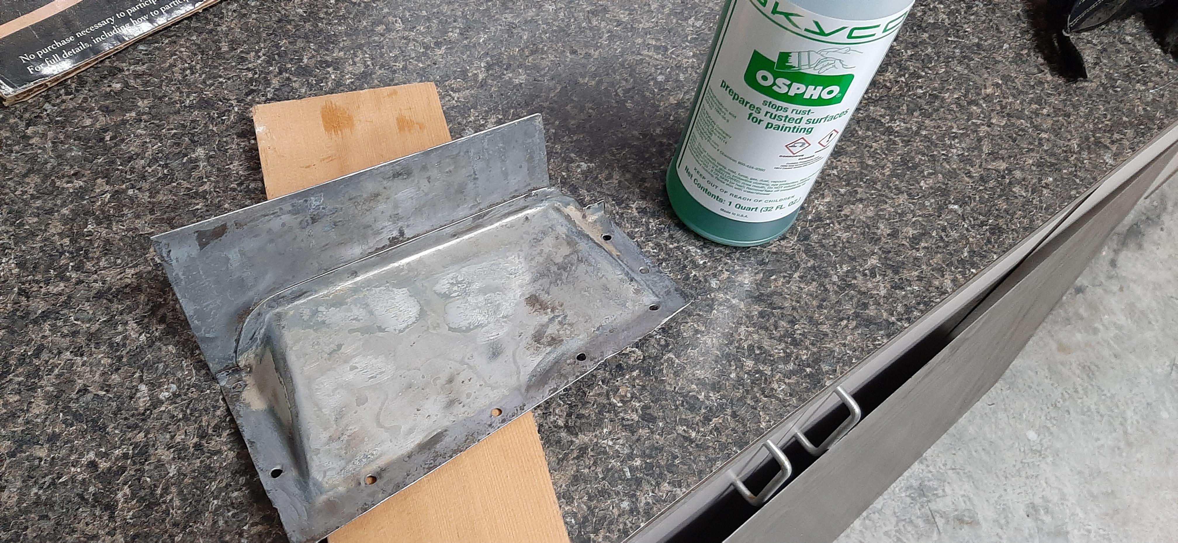

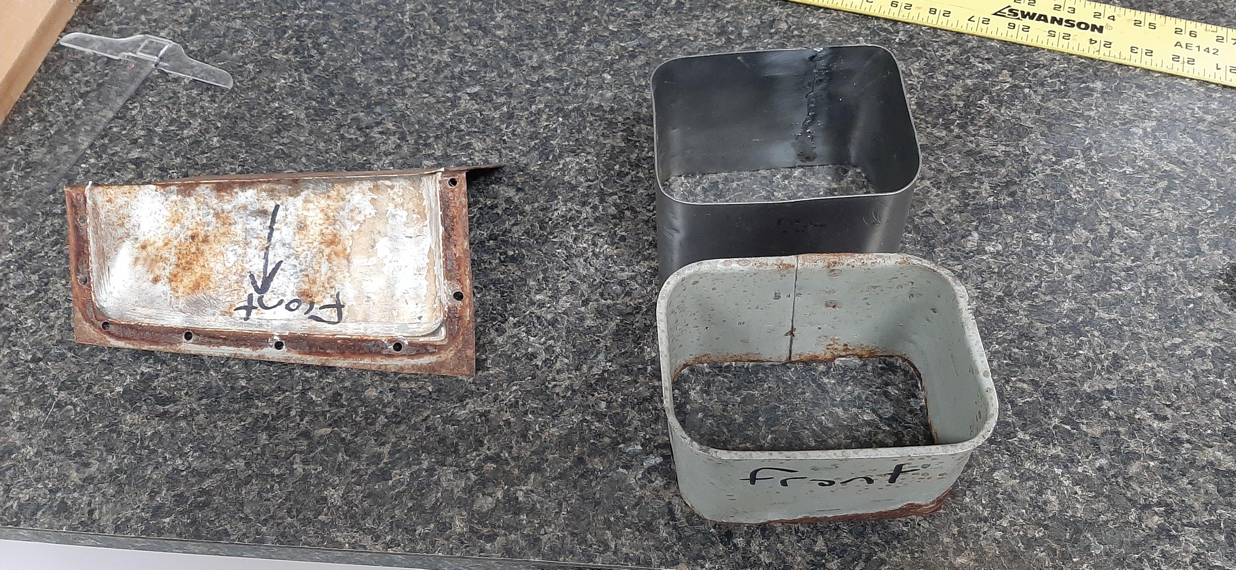

I read where the fresh air duct up in the cowl wont be needed. So I just finished making a new duct and patch repair to weld in. The question is, a, I spitting in the wind to do all this? Should I just weld in a blank and be done with it?

I'm not familiar with the A/C unit, but how did you get that chimney out?
It wasnt easy. Drill the spot welds off of the rain gutter over the vent (the easy part), but then you have to get in there with whatever you can find to cut out the duct.
If yours is rusty like mine, then actually thats an advantage as it already weak so you just start hacking at it. If your dash is out you can come up from underneath, if not, it may take a few beers and profanity.

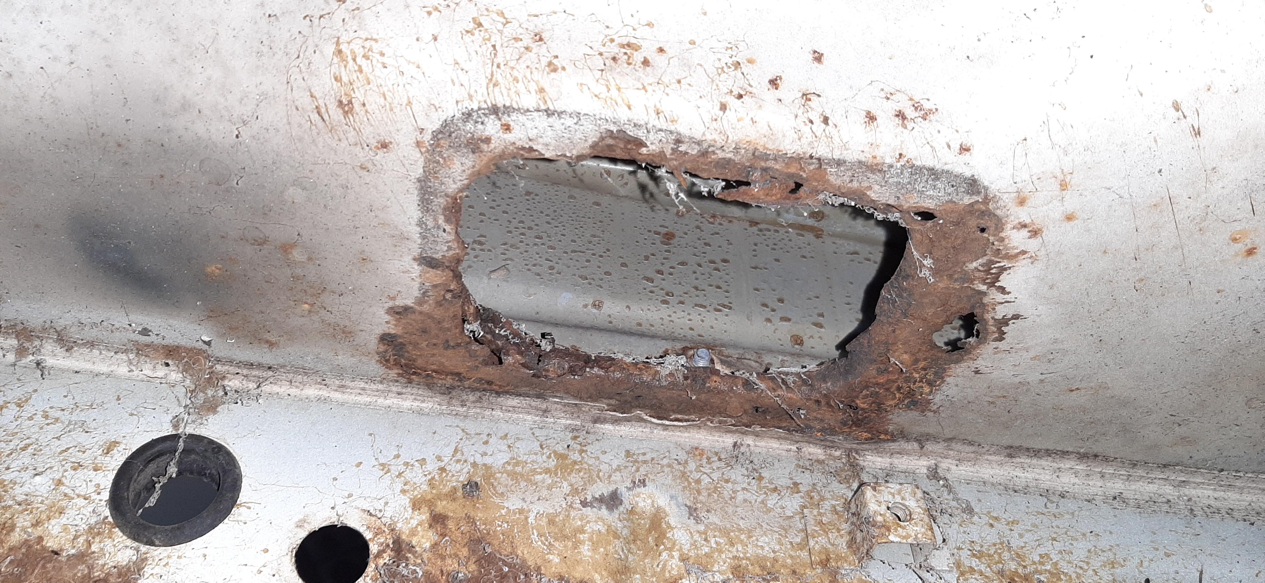

Mine looks rusty from what I can see of it, but it doesn't seem to have penetrated the cowl yet.  Just curious what the proper access procedure is, doesn't look easy.  If your air conditioning system does not need outside air, I suppose you could just put a plate over that hole and seal it up.  But, then where would the vent selector in the center dash panel get air?

If it were me I would repair the chimney to factory and then block it off in a reversible manner. At some point in the future it may make monetary sense to reverse these changes
Great minds think alike and I agree, I kind of have to after making up a new chimney already.
I figured I would make up a panel with to fit underneath the dash with some rivnuts and use a gasket to seal it off.

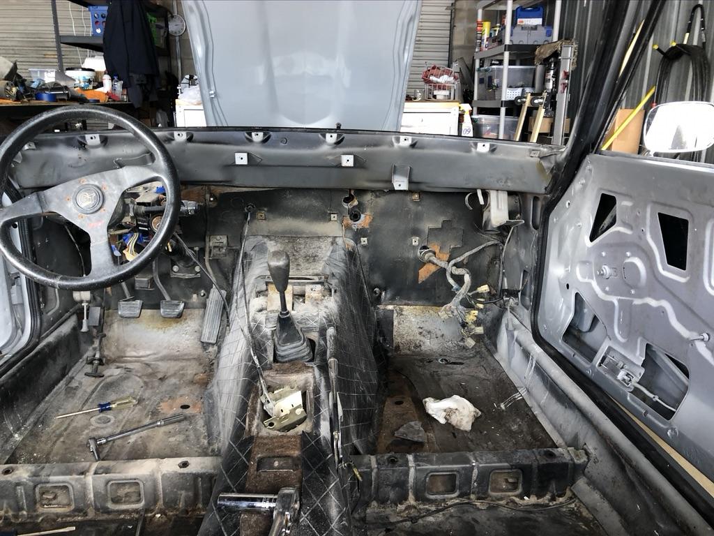

I’m going to install a VA Mini in one of my 1971s.  Do I have to seal (weld) off the duct or just close it?  It may be stupid question, but until I read this, I hadn’t thought about having to seal something off.  I have everything removed from interior and am about to order the ac unit.  I’m having the dash  refurbished and cleaning up the wiring harness.
one question I do have is should install the interior first or the AC unit?

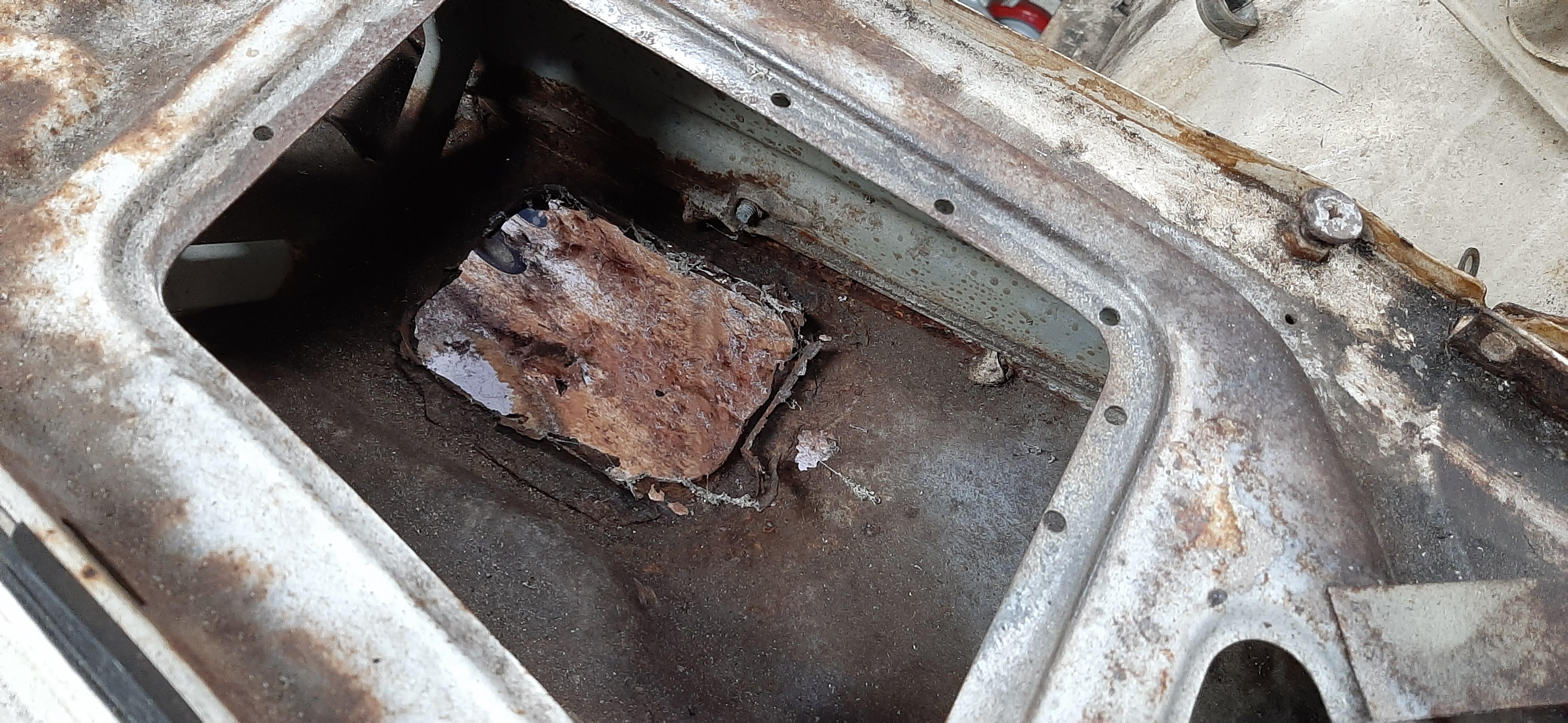

the chimney is sealed off by the old AC air box (there is a door that opens to the cabin or the chimney), so you lost that when you removed it. Now you just have a big gapping hole, so yes you have to fabricate something to close that or you will have a massive constant inrush of air from the cowl. I would just get a plate and use some silicon to seal it from the bottom, rather than welding up around the cowl and risking a leak. If the chimney is in good condition and the factory seam seal is in good condition you only have to worry about air coming in. If you start welding up around there you would likely damage the seam seal so you would have to really dig into the whole setup to make sure its water tight. You should look very closely around the chimney now that its all exposed to asses what needs to be done while the dash is out.
