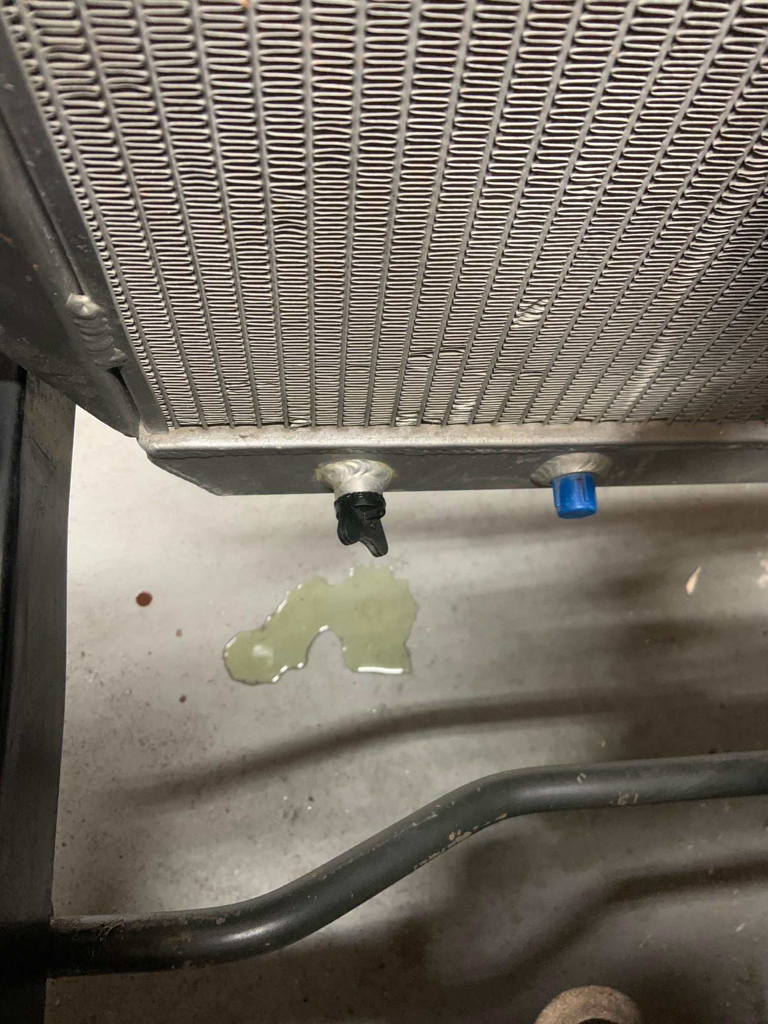

1 hour ago, Wally said:
Has a good plug and seal...yet continues to slow leak. Any ideas?
The seal is not good.
I used a steel bolt on my OReilly Auto radiator.  Drilled a hole in it so it worked like the plastic ones.  It's surprising how few options there are for those plugs, and all of the options are poor quality.
https://www.classiczcars.com/forums/topic/64535-radiator/#findComment-607551
I did exactly what Zed Head did on my O'Reilly radiator too but I didn't drill a hole for draining. I have to pull the lower hose off to get the fluid out. I also used Teflon tape as Heyitsrama suggest.
https://www.classiczcars.com/forums/topic/64535-radiator/#findComment-607552
