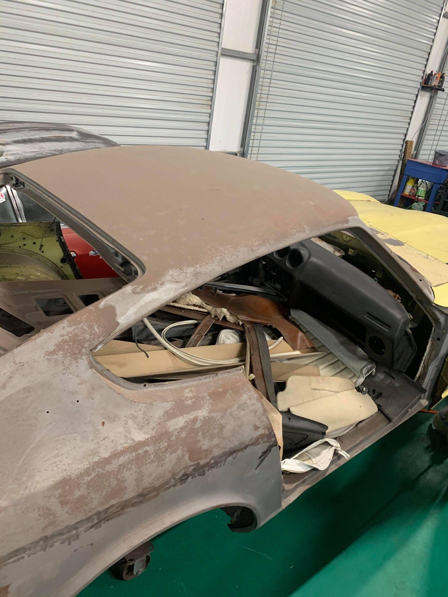

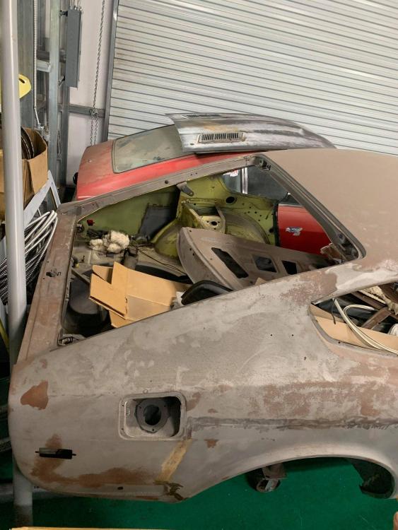

Well i have bought myself quite the project. Should be fun though. I have picked up an early sunshine yellow 1971 240z HLS30-07119. It has seen better days. Someone partially started some rust repair and failed miserably. I will get some better pictures once i move it to the shop. The Red 73 came with it. I have the supposed number matching engine/tyranny plus two l28 engines and transmission.
Current goal to to build a frame jig for the car. This way i can go about cutting up most of the car and i don't have to worry.
Long term I would like to build my stylized version of a 432r but, that can always change.

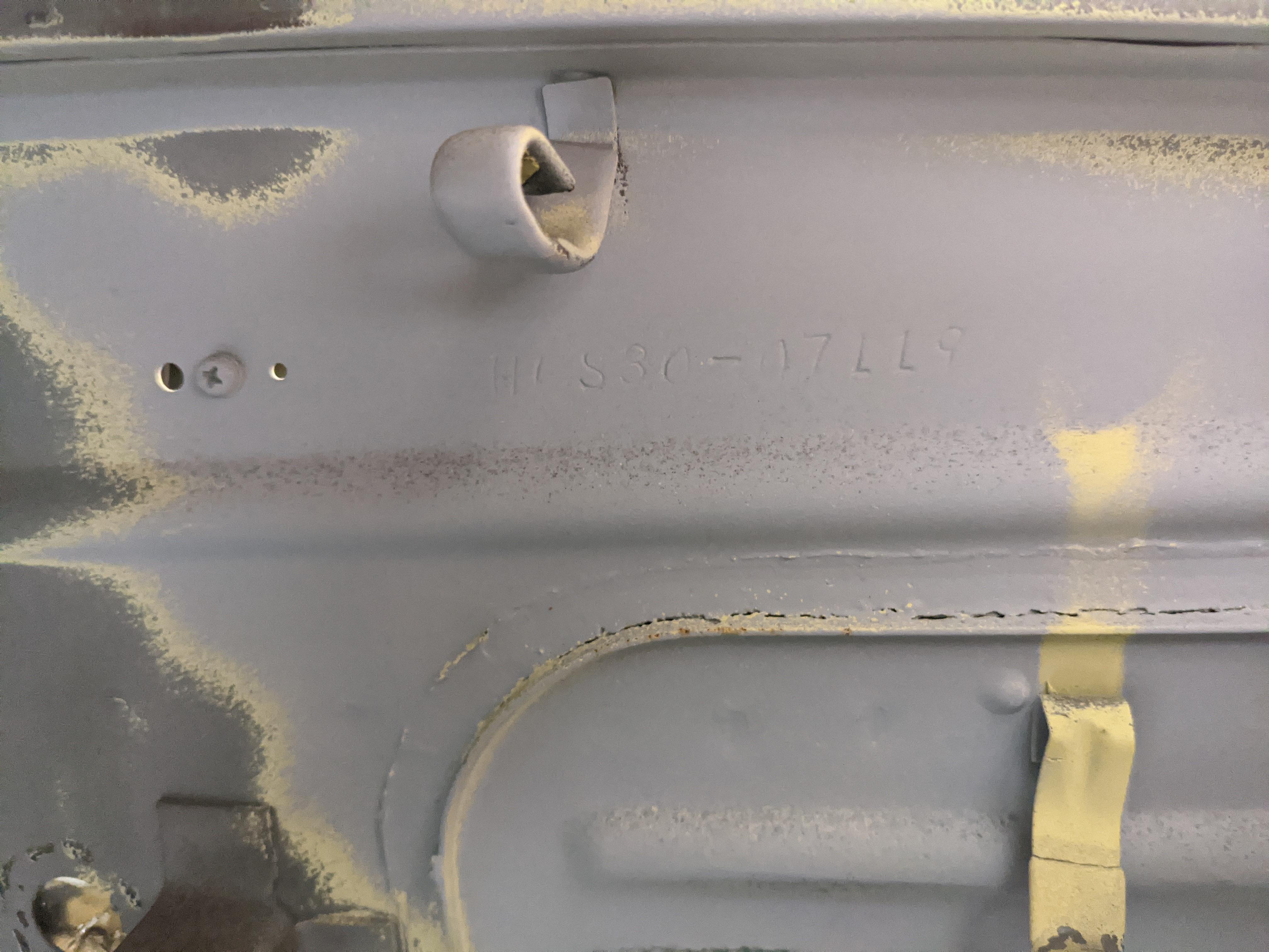

Also, what do you think about the car  being registered as a 71 with such a low vin number? Maybe it was delayed? It even has the "cruise control".
What is the build date on the door jamb tag?

On 10/18/2020 at 9:16 PM, 7m-gtte said:
I found where to get new ones but, I don't know the "correct" month/year to put on the build date. I think eventually i will just make a best guess.
Haven't made much head way recently. Just buying parts and getting ready to build a frame jig.
Any thoughts on sunshine yellow? I think i will end up painting it Lime Green since that's my favorite Datsun color.
I have owned 8 240Zs in my adult lifetime and I currently have two 1971 240Zs today. I used to own HLS30-07184, built in 7/70, just as your 240Z was. #7184 was also an East Coast delivery car and was licensed and registered as a 1971. Both of our cars are 1970 model year 240Zs. It makes no difference if they were registered and licensed as 1971 cars. My understanding is that it took a long time for the 240Zs destined for the East Coast of the U.S. to arrive from Japan. So there were a number of late 7/70 and 8/70 240Zs that were registered and licensed as 1971 cars. 240Zs built in September were officially designated as 1971 model year cars.  So with all of this in mind, as I mentioned before, your car was built in 7/70, just as my former 7/70 was and they are both 1970 model year 240Zs. There are other members here on ClassicZcars.com that have the same story as you and I do.
