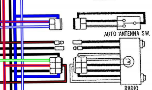

October 18, 20204 yr Author comment_608405 WOW First Class Posts Bob S.! BIGGGGG THANKSSSSS Here is Schematic... (not exact match but they are known to have differences) Edited October 18, 20204 yr by 240260280 Link to comment https://www.classiczcars.com/forums/topic/64573-280z-radio-pinout/?&page=2#findComment-608405 Share on other sites More sharing options...
October 18, 20204 yr comment_608412 Thanks for the compliment...I also saw that same schematic in my FSM....but I was somewhat confused since the schematic didn't exactly match the actual configuration in my car...and I know my car hasn't been altered from original...so I thought it would just be more useful if I posted what was in the car. Specifically, notice how that schematic shows the connections at the radio as a 6 + 2 plugin vs. the 5 + 3 config. in my car. I'm not sure why the difference....maybe the clarion radio setup was different? Anyway, hope all this helps...good luck!! Link to comment https://www.classiczcars.com/forums/topic/64573-280z-radio-pinout/?&page=2#findComment-608412 Share on other sites More sharing options...
October 19, 20204 yr comment_608432 I think the schematic matches the car fine. The connectors shown on the wiring diagram are a six position spade and a pair of bullets. On the car end of that sub-harness, you've got a six pin spade and a pair of bullets. Just like the diagram. The confusion comes from the fact that the connectors built into the back of the radio are not shown on the diagram at all. The diagram shows it as if the wires were hard-wired coming out of the back of the radio (just like they did on previous years). So if you plug that little sub-harness into the back of the radio and pretend it's all one piece, then the wiring diagram is spot on. The problem you're having with 6+2 or 5+3 is that the 5+3 is completely ignored on the diagram. Link to comment https://www.classiczcars.com/forums/topic/64573-280z-radio-pinout/?&page=2#findComment-608432 Share on other sites More sharing options...

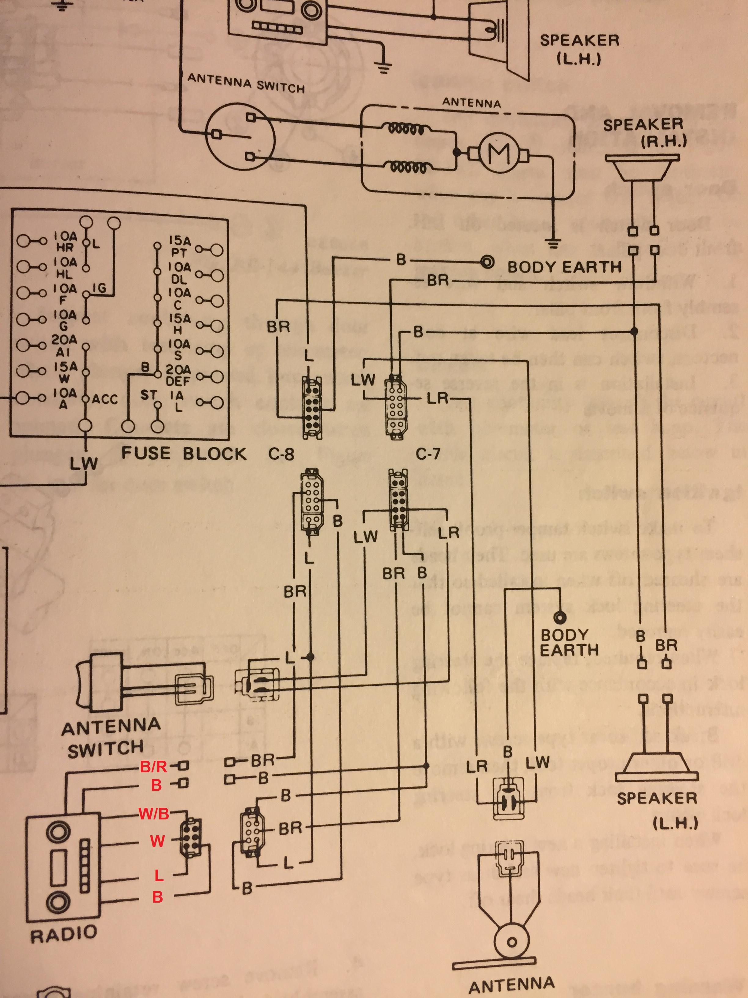

October 19, 20204 yr comment_608479 So White is right side speaker out and Black/Red is left side speaker out. Thats interesting. And it would make sense I guess that each speaker would need its own wire driving it for a stereo system. However, that setup doesn't match the FSM wiring diagram description. The 78 FSM wiring diagram shows both speakers being driven by the Black/Red bullet connector wire. In fact, it doesn't even show the White wire. I'm guessing this is another example of a diagram not being updated to reflect system upgrades from the original configuration. Link to comment https://www.classiczcars.com/forums/topic/64573-280z-radio-pinout/?&page=2#findComment-608479 Share on other sites More sharing options...
October 20, 20204 yr comment_608570 That diagram is correct. It's just more of the same issue as before where they didn't show the stub harness on the diagrams. The documentation just assumes the wires coming out of the back of the radio are hard-wired. I added the colors to your diagram to show what I'm talking about. I stand by my previous identifications of the wire colors (IN THE SUB HARNESS). They change some of the wire colors at the six position spade connector, so on the CAR SIDE of that connector the colors are different: Note that they don't show the illumination wires on this diagram because they are shown on the dash lighting page instead. But the rest of the colors all work out. Edited October 20, 20204 yr by Captain Obvious Added some detail Link to comment https://www.classiczcars.com/forums/topic/64573-280z-radio-pinout/?&page=2#findComment-608570 Share on other sites More sharing options...
