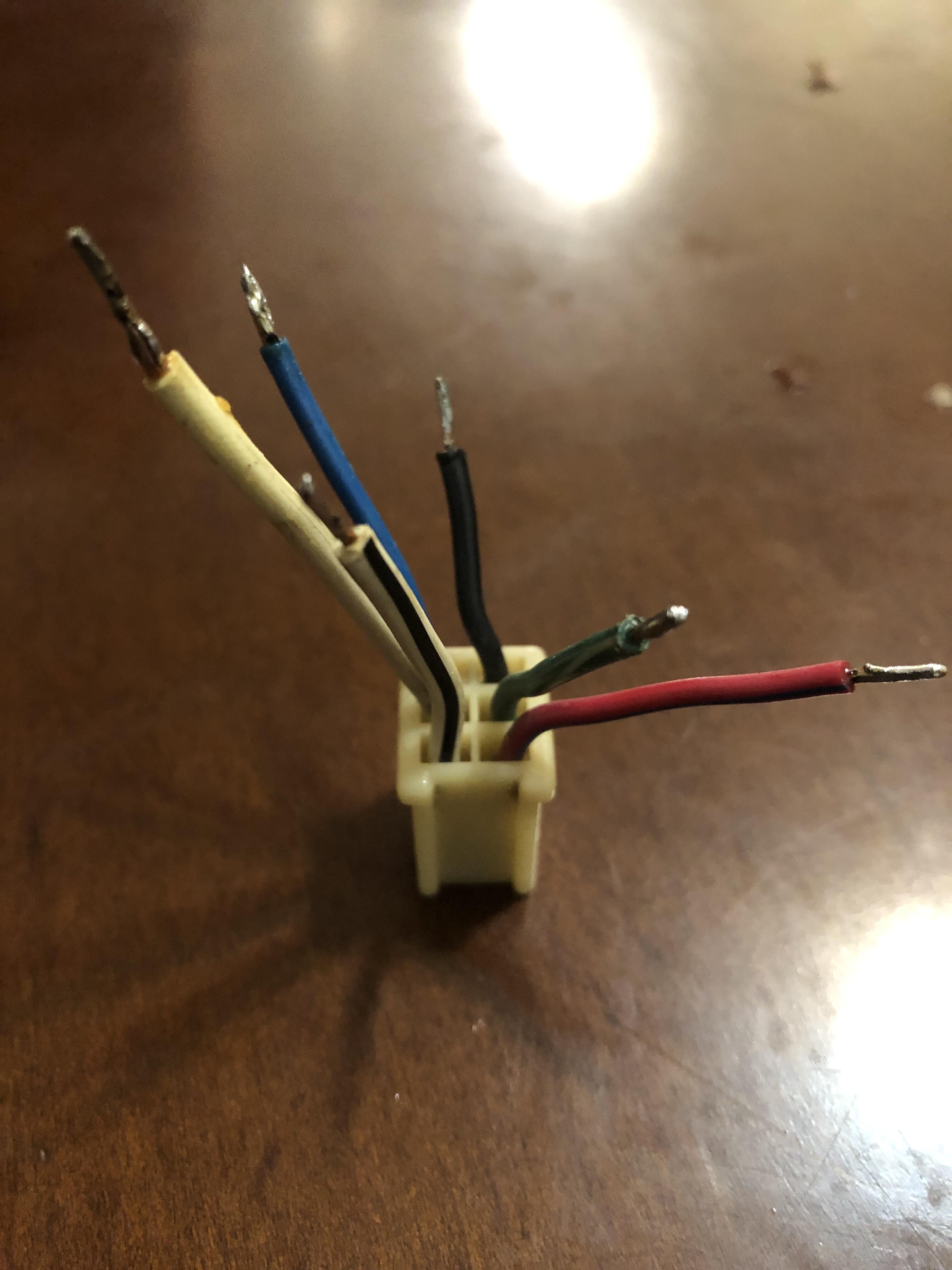

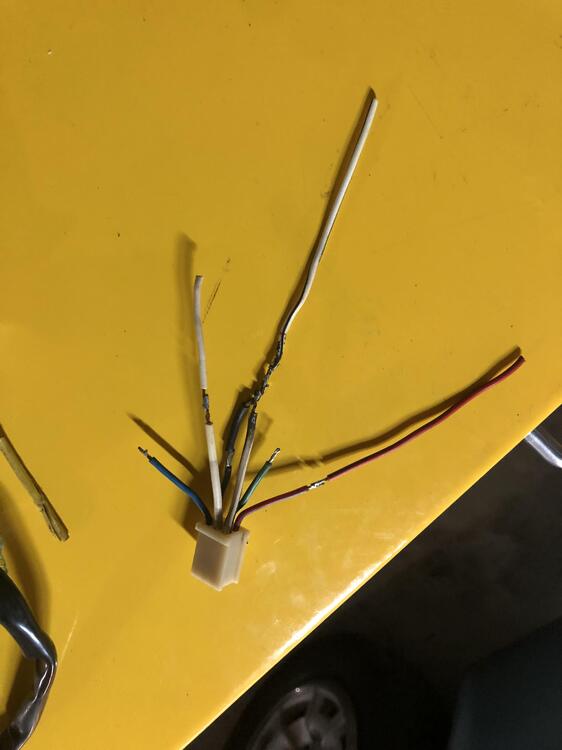

@Captain Obvious old thread I am installing a Clarion radio and I do not have the BLACK/RED. It only has 5 wires:
Blue
Green/White
Red/Blue
White and White/Black
My original 280z harness has the 6 pin back connector which does have a Black/Red but this Clarion do not have this wire so I am assuming Radios on 240z/280z were always mono. I am not sure if the original may be the Hitachi radio is a two speaker stereo setup.
For now I tried getting sound via White/Black wire with external ground but no use. At this time planning to just connect the white wire with an external AMP and use the two speakers in parallel.
16 minutes ago, Yarb said:
Be careful grounding out a lead that is unknown can be quite risky. Very easy to blow the speaker outputs.
So what is the best way to proceed here? just connect the two speaker wires to the White and White/Black wires from the Radio?
56 minutes ago, Captain Obvious said:
I believe the 240-280 radios were all mono.
Can you take a pic of the connector on the back of the Clarion?
It’s in the post link in my previous reply. But here it is…
it shows 6 pins but one of the white wire from the radio was split Y going into 2 of this connector pins.
