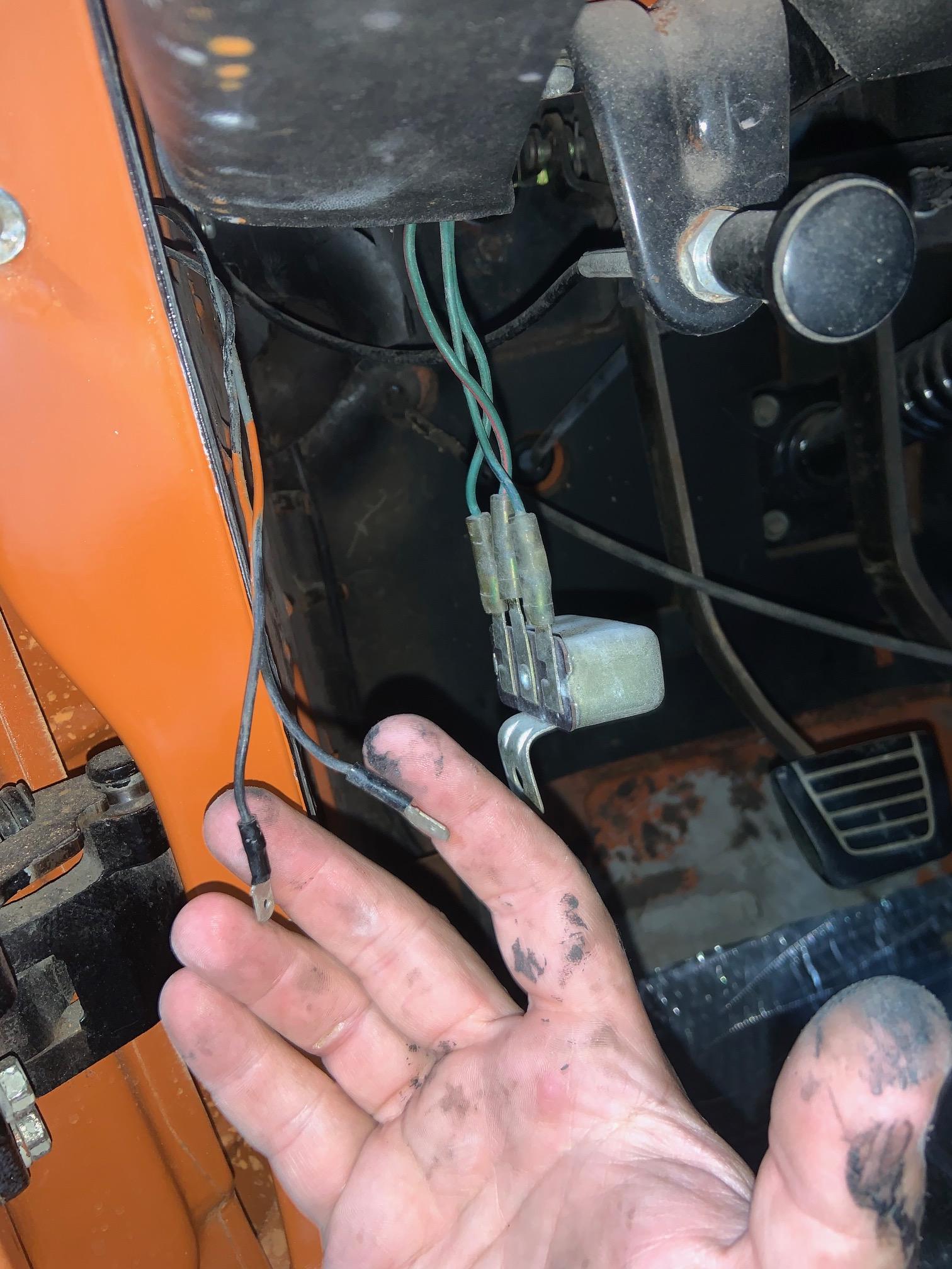

what are these wires?
Wally
So you have probably realized that with these cars there is hardly ever one answer to these questions. We know those two wire go to the door switch. As ZT said the 71 manual shows the driver side should have a Y and a B and connects the compartment over head light and to buzzer  for the key lock switch.  Most buzzers is located under the dash near the steering column and brake light switch and are usually disconnected.
