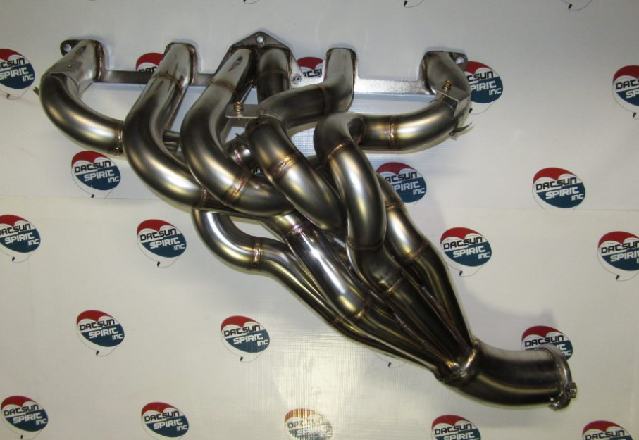

February 12, 20214 yr comment_616009 On 2/8/2021 at 2:47 PM, Dadsun said:  The one that you have looks like it has the thick flange and is the square port that you want. The raised edge on the inside will actually create more sealing pressure, it's not necessarily a bad thing, if it's straight and even all the way around each port. I'd take it to a speed shop and see what they think. A bit of hammer work and a twist, followed by a surface grind might get it where you want it for not much. Make sure you get a quote first though, sometimes those guys will keep working til it's done and charge you by the hour. Or, there's this. https://datsunspirit.com/shop/hand-made-6-1-true-equal-length-stainless-steel-header-with-merge-collector/ Edited February 12, 20214 yr by Zed Head Link to comment https://www.classiczcars.com/forums/topic/64602-starting-carb-conversion-flat-tops-to-paltechs/?&page=11#findComment-616009 Share on other sites More sharing options...

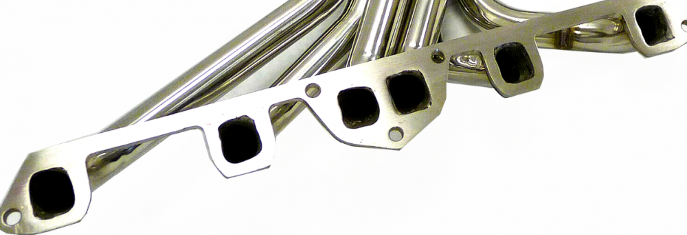

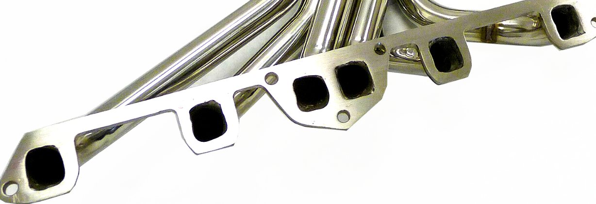

February 12, 20214 yr comment_616015 On 2/10/2021 at 9:19 AM, Dadsun said:  I've been looking through eBay, but don't trust a lot of what I see. Does this (see pic) make sense as a "square port style?":   Is your picture from eBay or is it from ZCarDepot? You didn't provide an eBay link. https://zcardepot.com/collections/exhaust/products/header-exhaust-ceramic-coated-240z-260z-280z-70-76 Link to comment https://www.classiczcars.com/forums/topic/64602-starting-carb-conversion-flat-tops-to-paltechs/?&page=11#findComment-616015 Share on other sites More sharing options...
February 12, 20214 yr comment_616019 There a lot of people making headers for theL6 but none of them are very impressive. Looks like a person would buy something close then do some grinding and maybe some filling to get them right. There's a whole separate eBay page for them. Many of these cheap headers rust out at the intersection of the tubes or are never completely welded up from the beginning. Plus, look at the cuts on the flange. Terrible. Looks like the center ports aren't even centered over the mounting holes. https://www.ebay.com/b/Exhaust-Manifolds-Headers-for-Datsun-240Z/33632/bn_20176001 https://www.ebay.com/itm/OBX-Racing-3-2-1-Long-Tube-Header-For-1969-1983-Datsun-240-260-280Z-ZX/133176095712?fits=Model%3A240Z|Make%3ADatsun&hash=item1f01e9f3e0:g:ajcAAOSwkydfYS69 Link to comment https://www.classiczcars.com/forums/topic/64602-starting-carb-conversion-flat-tops-to-paltechs/?&page=11#findComment-616019 Share on other sites More sharing options...
February 14, 20214 yr Author comment_616130 On 2/12/2021 at 1:17 PM, Zed Head said: Is your picture from eBay or is it from ZCarDepot? You didn't provide an eBay link. https://zcardepot.com/collections/exhaust/products/header-exhaust-ceramic-coated-240z-260z-280z-70-76 My pic was from eBay. Can't find the listing at the moment, but yes, it's the same pic as the ZCarDepot link. As for eBay, the only decent listings there seem to be the ones from California Datsun. But, apparently he has a bad rep here. Is it bad product or bad customer service? On 2/12/2021 at 12:43 PM, Zed Head said: Or, there's this. https://datsunspirit.com/shop/hand-made-6-1-true-equal-length-stainless-steel-header-with-merge-collector/ Wow! Beauitful. High end for sure. I spent some time yesterday trying to grind down the lips around the ports, and further inspecting. Even ground down, the two ports on the ends have eroded flange at the top of the ports... to the point where they will not seal properly no matter how much I tighten them. Time to scrap them. So, reading through the other responses and clicking some links, looks like I need to avoid ZStory for now. And Summit has only one option listed and it has the strange round/square port combo in the pics. https://www.summitracing.com/parts/psm-72c1037/make/nissan/model/240z/year/1973  My best options right now seem to be: 1. Order MSA 6-to-1 uncoated and pay to have them coated. -- probably at least $530 out the door 2. Order from MSDS guy. Will follow up with him for details on what they have. The website doesn't tell me much.  Link to comment https://www.classiczcars.com/forums/topic/64602-starting-carb-conversion-flat-tops-to-paltechs/?&page=11#findComment-616130 Share on other sites More sharing options...
