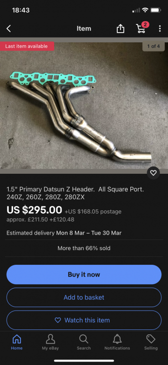

February 19, 20214 yr comment_616359 Spotted this earlier - looks tasty but no real history I’m aware of, hopefully someone in the US can comment ....https://www.ebay.co.uk/itm/1-5-Primary-Datsun-Z-Header-All-Square-Port-240Z-260Z-280Z-280ZX-/313386185058?_trksid=p2349624.m46890.l49292 Link to comment https://www.classiczcars.com/forums/topic/64602-starting-carb-conversion-flat-tops-to-paltechs/?&page=12#findComment-616359 Share on other sites More sharing options...
February 20, 20214 yr Author comment_616407 5 hours ago, AK260 said: Spotted this earlier - looks tasty but no real history I’m aware of, hopefully someone in the US can comment .... That one on eBay shown as coming from Top End is the MSDSinc.com product (aka Marty mentioned earlier in this thread). Go to Marty's site instead if you want that one. You'll save $60-70 buying directly from him. He has a good reputation on here. I wound up going MSA's product over his but only because they have the exhaust-to-tail connection ready to go. Marty's part number related to that eBay item is HO-241, I think. Link to comment https://www.classiczcars.com/forums/topic/64602-starting-carb-conversion-flat-tops-to-paltechs/?&page=12#findComment-616407 Share on other sites More sharing options...

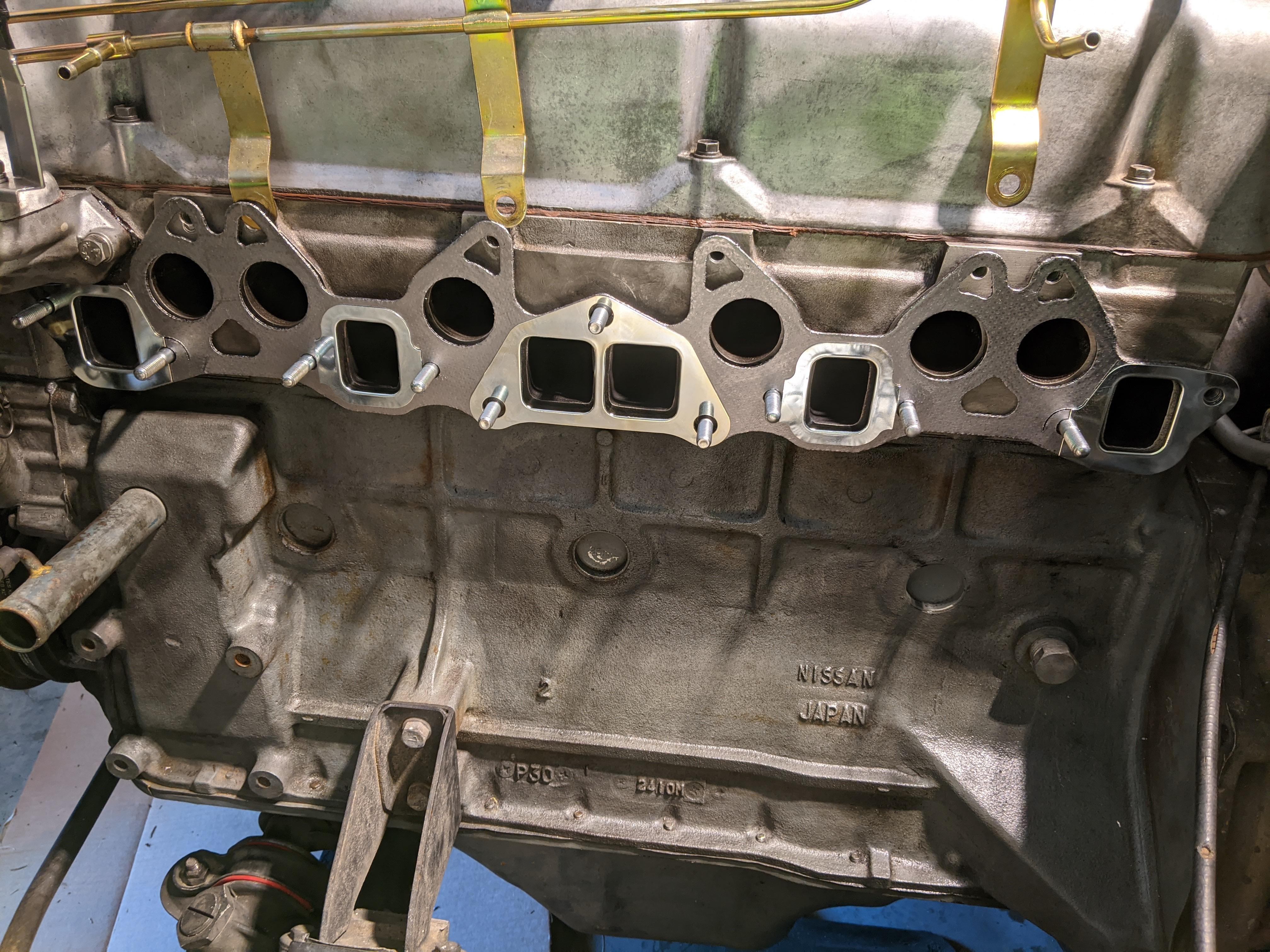

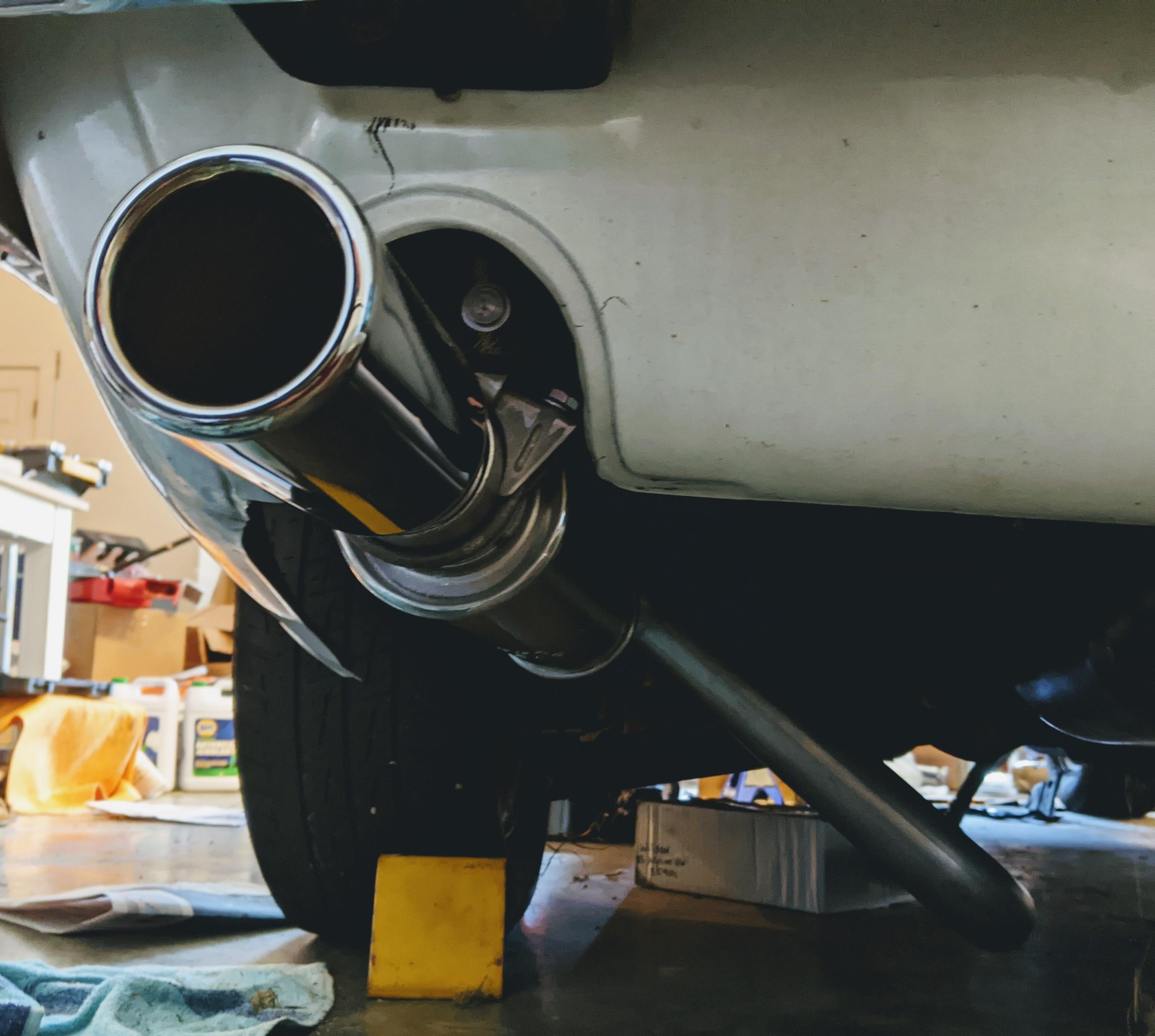

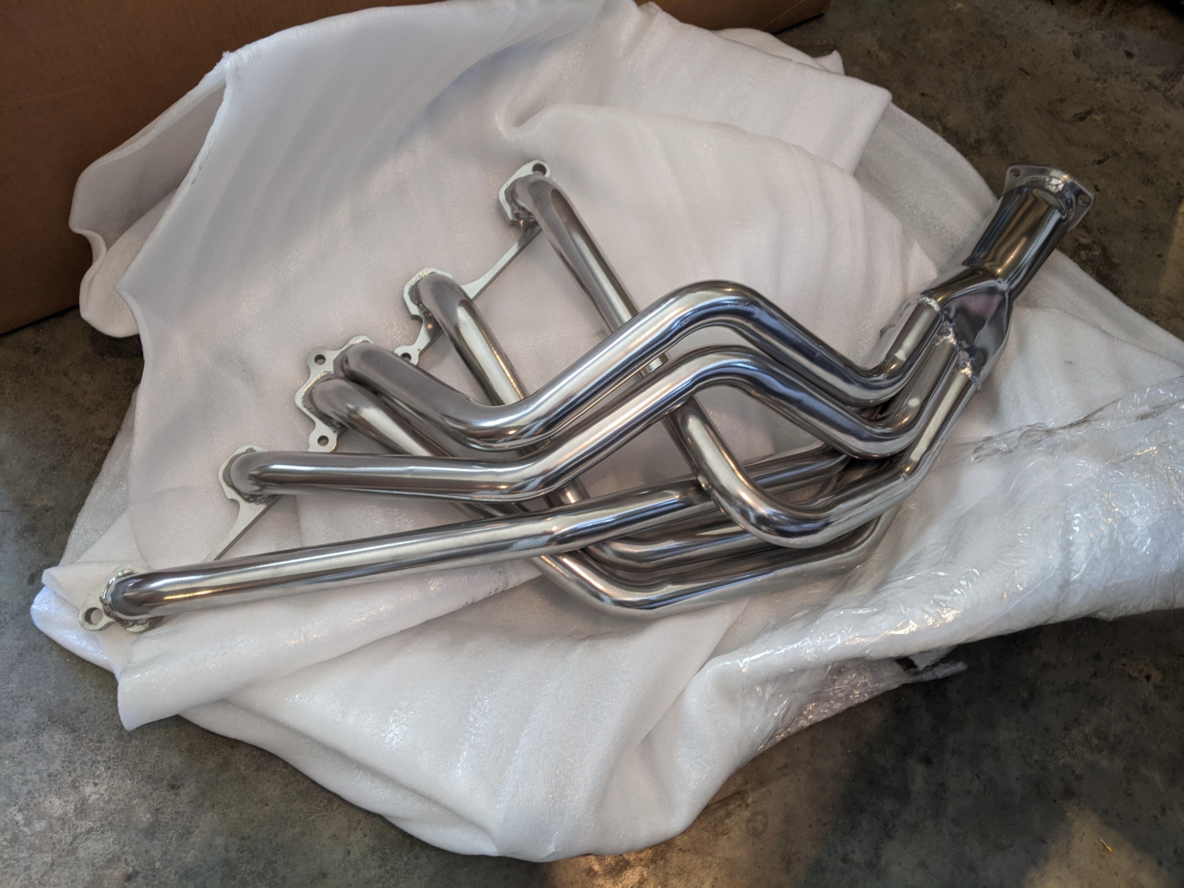

April 2, 20214 yr Author comment_619091 Ok, I'm back. Got the MSA header, then had Jet-Hot coat it, and also have the MSA performance exhaust system to tie it into. The thing I'm most giddy about today is successfully getting off all of the old mount studs. Spent time here and there over the last few weeks with PB Blaster, hammer taps, and good old vice grips. So, I'm ready to reassemble. My previous efforts here have used the bolts at the intake manifold, not all studs. Any tricks to assembling? I'm thinking I should start only with the studs shown to get the header and bottom of intake manifold in place and a little snug before adding the top studs. Edit: ok, I learned the hard way... Set all the studs then get after it. Looks like a good seal across the header. Will crank tomorrow. Edited April 3, 20214 yr by Dadsun Link to comment https://www.classiczcars.com/forums/topic/64602-starting-carb-conversion-flat-tops-to-paltechs/?&page=12#findComment-619091 Share on other sites More sharing options...

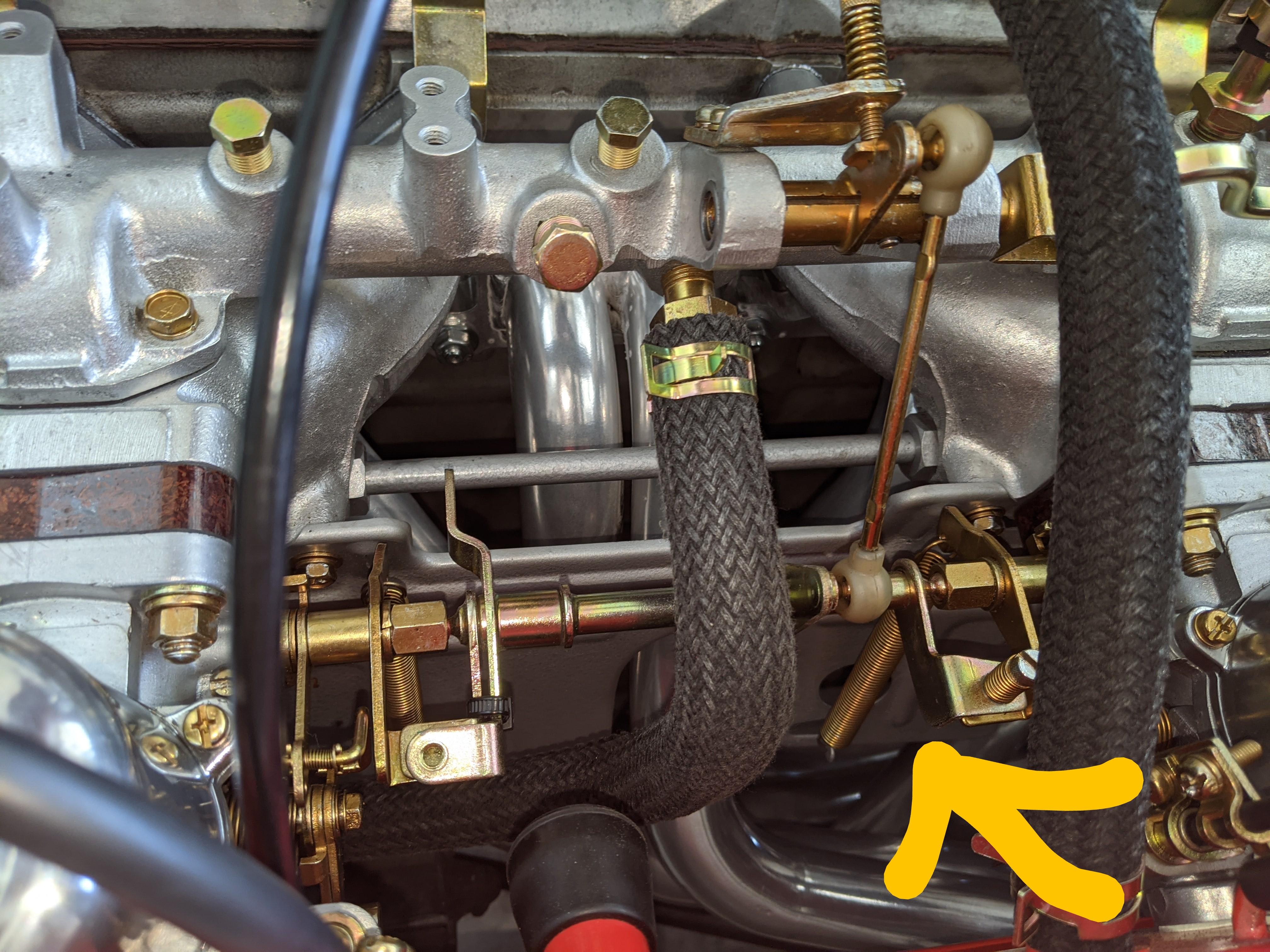

April 6, 20213 yr Author comment_619311 Need some insight... So, the header and new exhaust are in. No leaks as far as I can detect! Sounds pretty good although I still have some carb tuning to get back to. But, I have an issue with the accelerator/throttle linkage. It is tight and requires me to push down fairly hard to get it moving. Which results in a big rev and jerking. I think it's that the two springs connected to the heat shield are too tight. See yellow arrow on pic. Any suggestions? And how do the carbs stay in idle if there is no heat shield and springs? Also, that connecting rod between the carbs linkage and the top idle screw seems at a less than optimal angle when trying to generate movement downward on the linkage. It'd be better if it were longer, but then the idle would be very high unless I made adjustments elsewhere. Any help appreciated. Edited April 6, 20213 yr by Dadsun Link to comment https://www.classiczcars.com/forums/topic/64602-starting-carb-conversion-flat-tops-to-paltechs/?&page=12#findComment-619311 Share on other sites More sharing options...

April 7, 20213 yr comment_619346 I see that the rod coming off the bell crank is pretty well extended on its adjustment threads. This is increasing the mechanical advantage and adding to the "jerk". You can adjust that rod shorter and soften the response a bit. Softer return springs at the heat shield will also improve the problem, just not so soft that the carbs will not shut down when you lift from the accelerator pedal. Link to comment https://www.classiczcars.com/forums/topic/64602-starting-carb-conversion-flat-tops-to-paltechs/?&page=12#findComment-619346 Share on other sites More sharing options...
