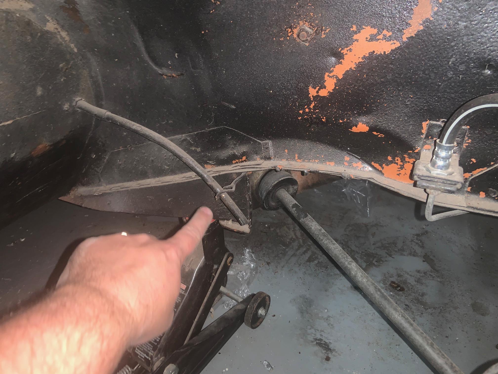

Posted October 27, 20204 yr comment_609056 This tube has been cut and not attached anywhere....any idea what its supposed to be doing? At right front. Edited October 27, 20204 yr by Wally Link to comment https://www.classiczcars.com/forums/topic/64621-is-this-something-brake-related/ Share on other sites More sharing options...
October 27, 20204 yr comment_609058 Could be the drain for the cowl panel before the windshield? They drain on passenger's side. Link to comment https://www.classiczcars.com/forums/topic/64621-is-this-something-brake-related/#findComment-609058 Share on other sites More sharing options...
October 27, 20204 yr comment_609059 That's the drain for the aftermarket A/C, note how the floorboard metal is pushed out crudely. The cowl drain is hidden behind the fender just forward of the door hinges, is a large tube. Link to comment https://www.classiczcars.com/forums/topic/64621-is-this-something-brake-related/#findComment-609059 Share on other sites More sharing options...
October 27, 20204 yr Author comment_609062 Ah.... thanks! Link to comment https://www.classiczcars.com/forums/topic/64621-is-this-something-brake-related/#findComment-609062 Share on other sites More sharing options...
