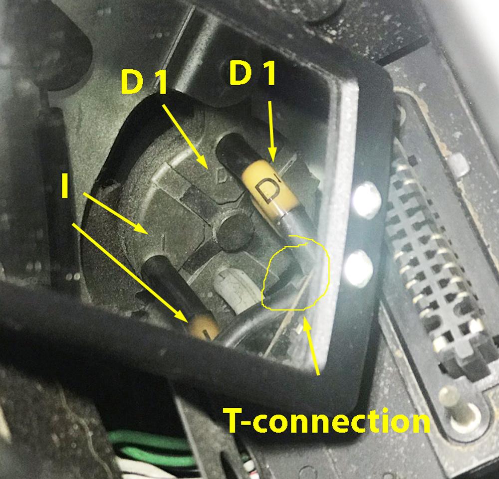

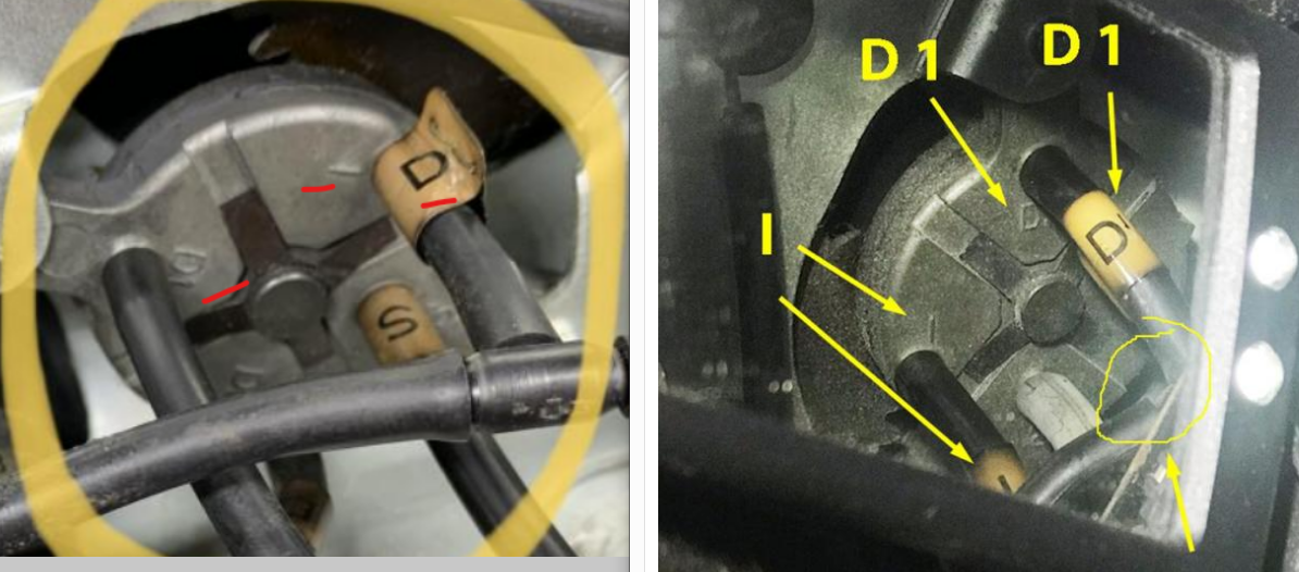

Good catch Zed...

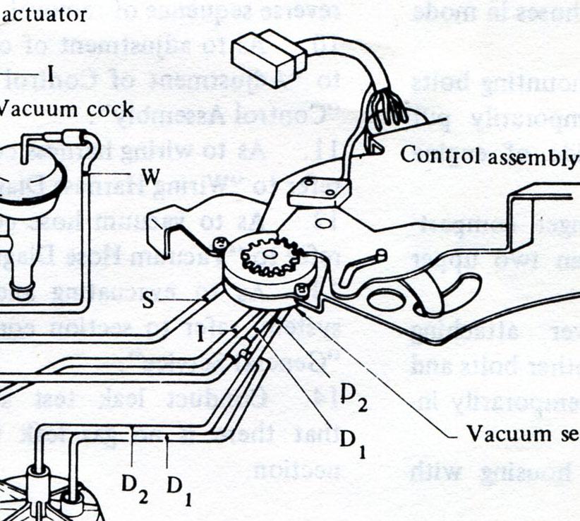

I have a 75 and this is what the manuals says . The "T" in the vacuum line  should be connected to the D1 on the vac switch , but is connected to I.
That is exactly how mine is connected. I is connected to D1.  1976 280Z manufactured 9/1975.
1 hour ago, zclocks said:
I did get a photo after mega contortions, but my 75( 1/75) is connected as per the manual.  D1 hose to D1 on valve  and "I "hose to " I "on valve. "T" connection is from D1
Thanks for your time in doing that to help me. It was super hard to get down there twisted to even take the picture I know. I’m 66 and once I got down there it was hard to get out!!!
