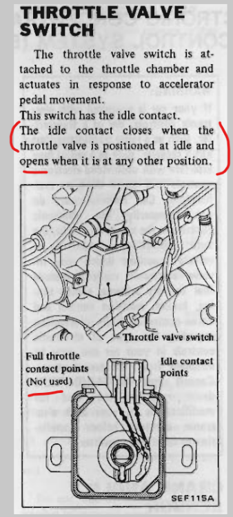

June 15, 20213 yr Author comment_623522 31 minutes ago, Patcon said: I would leave the thread as it is and not start a new thread. That way the final solution is with the initial symptoms Fair enough.. since this is a Turbo model, i based my testing on ECCS section of the FSM ( pages EF & EC 2~ 38). Am i correct? a recap of the issue: 1) Car starts up quick. there is a little hiccup in idle for the first few min, then idle gets rougher and rougher to a point it struggles to stay on 2) car wont go past 30 mph even if tired to accelerate gradually. if i try to boost, it will chock immediately i started off by using electric cleaner on ECU, harness, TPS pins, and AFM resister housing but no change in performance Temp fix: unplugging the TPS dramatically improved the idle situation (blip remained but engine doesn't die nor idles rough) and resolved the drivability issues. i can rev, boost and get up to 90 mph in few sec with no issues anymore here is what im getting.... ***************************************  ** TPS testing... FSM Manual, Page EF & EC - 29 on 20-pin connector and 16-pin connector                Pin 18 + 25 release = .5                 (Suppose to be 0 ohm)                Pin 18 + 25 depressed= with slightest move I get infinity                (Suppose to be infinity ohm at 30 degree if im not mistaken) TPS Terminals..                Pin 25 + 18 =0                                   (Suppose to be 0 ohm)                Ping 25 + 24= when depressed almost half way I get closed circuit                Pin 18 + Ground              =infinite                              (Suppose to be infinity ohm)                Pin 25 + Ground              =infinite                              (Suppose to be infinity ohm)  ** Starter Switch...FSM Manual, Page EF & EC - 31 on 20-Pin connector                pin 9=11.5v                                   (Suppose to be Battery voltage)  ** AFM testing.... FSM Manual, Page EF & EC -36  On 16-pin Connector                pin27 to body ground = 11.5V    (Suppose to be Battery voltage) Pin 33-26 reads OL                          (suppose to be 280~400ohm)                pin 33-31 reads 96.7 ohm            (Suppose to be Except 0 or infinity) Testing AFM on the 16-pin side (ECU plug side).                pin 26 to ground= 0.6 ohm            (Suppose to be infinity)                pin 31 to ground= 135.2 ohm       (Suppose to be infinity)                pin 33 to ground = OL                       (Suppose to be infinity)   On AFM pins Directly                Pin 33 + 26 = 201 ohm                   (supposed to be between 280 ~400)                Pin33 + 31 = 97ohm                       (Suppose to be except 0 and infinity)                     pin 26 to ground OL                pin 31 to ground OL                pin 33 to ground OL  i dint open the TPS yet, i dont see a need i opened the AFM side cover, it really looks very clean. the carbon track looks like its brand new. adjustments appear to be in line with the marking    Link to comment https://www.classiczcars.com/forums/topic/64656-loose-distributor-cap-perfect-idle/?&page=15#findComment-623522 Share on other sites More sharing options...
June 15, 20213 yr comment_623523 10 minutes ago, ira said: Temp fix: unplugging the TPS dramatically improved the idle situation (blip remained but engine doesn't die nor idles rough) and resolved the drivability issues. i can rev, boost and get up to 90 mph in few sec with no issues anymore Unplugging the TVS would tell the computer that the engine is not at idle. That is all. This causes certain things to happen. I'm not sure exactly what happens but the dramatic effect that you see suggests that your TVS is short-circuited or the wiring harness is, showing the engine at idle all the time when it is plugged in. Link to comment https://www.classiczcars.com/forums/topic/64656-loose-distributor-cap-perfect-idle/?&page=15#findComment-623523 Share on other sites More sharing options...
June 15, 20213 yr Author comment_623524 14 minutes ago, Zed Head said: Unplugging the TVS would tell the computer that the engine is not at idle. That is all. This causes certain things to happen. I'm not sure exactly what happens but the dramatic effect that you see suggests that your TVS is short-circuited or the wiring harness is, showing the engine at idle all the time when it is plugged in. Good to hear from you Zed,  when i saw TPS test results conform with FSM, i tested the wires back to the ECU end. all appear healthy, i get continuity with very low resistance similar to touching leads on the Ohmmeter. i tried to wiggle harness and connectors to see if anything is loose or shorted but all was fine. What are ur thoughts on the numbers im getting on the AFM? Link to comment https://www.classiczcars.com/forums/topic/64656-loose-distributor-cap-perfect-idle/?&page=15#findComment-623524 Share on other sites More sharing options...
June 15, 20213 yr comment_623525 Your test results don't seem to match what happens when the engine is running. Why focus on the AFM when the TVS has the biggest effect? I don't know that the AFM numbers are as critical on the ECCS systems since they have closed loop control. That's why they give a wide range in the specs. Can't offer much help.  Your car seems to be haunted. Weirdness abounds. Lifting the distributor cap to fix a rough idle...unplugging the TVS makes it run right even though it tests correctly... Mystery.  Link to comment https://www.classiczcars.com/forums/topic/64656-loose-distributor-cap-perfect-idle/?&page=15#findComment-623525 Share on other sites More sharing options...
