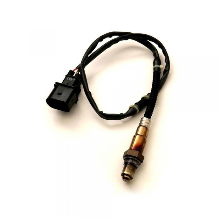

The LM-1 (and it's successor the LM-2) are designed to be used that way and not tied to any specific vehicle. The analog gauge I bought is intended to be installed in one vehicle and left there. I'm just wondering if things like the heater control are robust enough to be able to deal with being so far downstream from the engine heat source. That kind of thing?
I ended up returning the AEM wideband that I got and got a LM-2 because of the RPM data that can also be collected. They both share the Bosch LMU 4.9 sensor, I’m not sure if the LM-2 has a different mode selection to change the heating characteristics of the o2 sensor if you use the tail pipe tool.
The only thing that the lm-2 manual says about the exhaust clamp is that you can get false lean warnings on light loads.
With the AEM unit it warmed up in a couple of seconds and was giving a reading.
Perhaps it’s not recommended by the manufacturer, the exhaust tailpipe tool sections are omitted from the MTX-AL manual.

So I never looked real closely at the business end of your sniffer. What does the sensor look like? Just your normal threaded O2 sensor mounted on that bracket? Or is it a different style sensor that was never intended to be threaded into a bung?

I just used copper pipe.  (Not good as the solder melts in the heat 😞 )
Here is a bad drawing.  The longer 1/2" pipe is open on the left and the exhaust gas enters there.
It goes though 4 90 degree elbows (hard to draw)  to turn the gas 180 degrees and also to allow the two long pipes to squeeze together.
The gas then enters the T, travels up the 2nd 1/2" pipe (capped) and scavenging pulls the exhaust out through a hole in the side.
The T has a thick copper adapter inside. I could thread this with a tap. The O2 sensor goes in.  I believe I used a spark plug thread cleaner as the tap as it was the same thread.
If I were to do it again, I'd make it out of aluminum and thread the pipe joints.  The U turn/ sensor mount would be a drilled block.
I'd also dill a hole where you could safety-wire it to the hatch mechanism.
