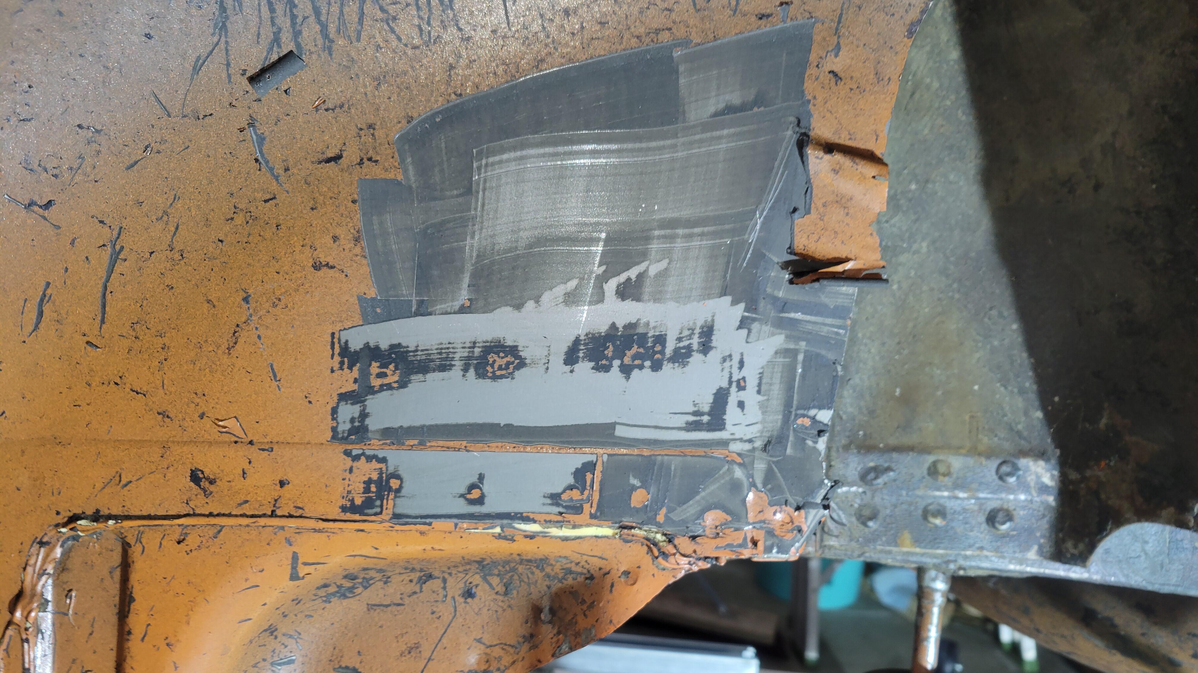

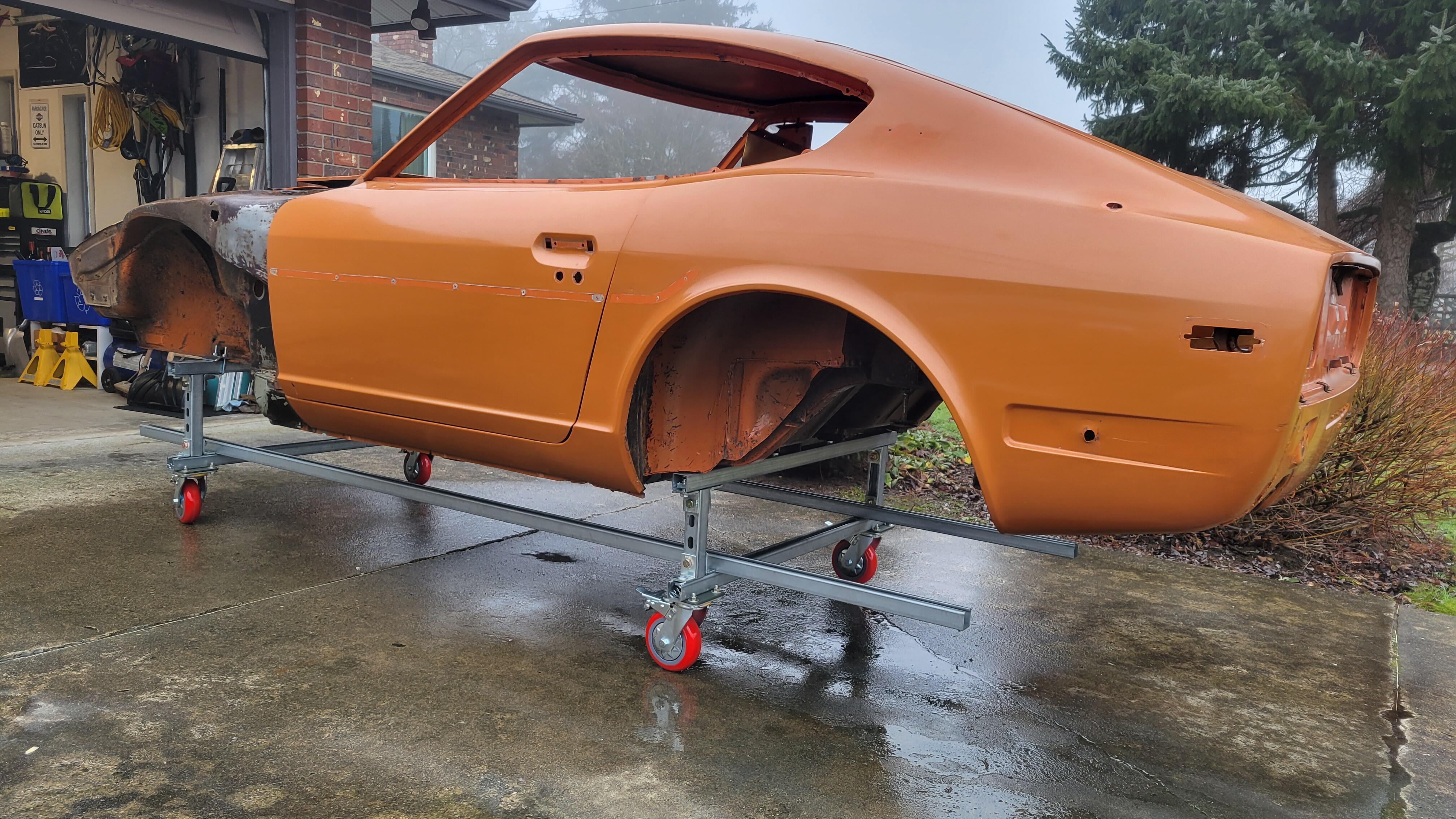

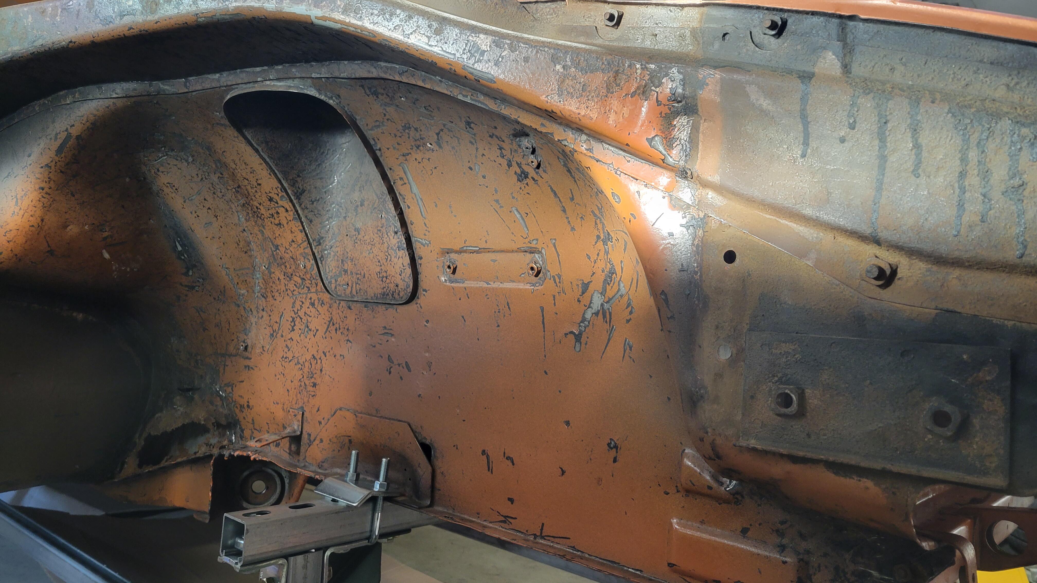

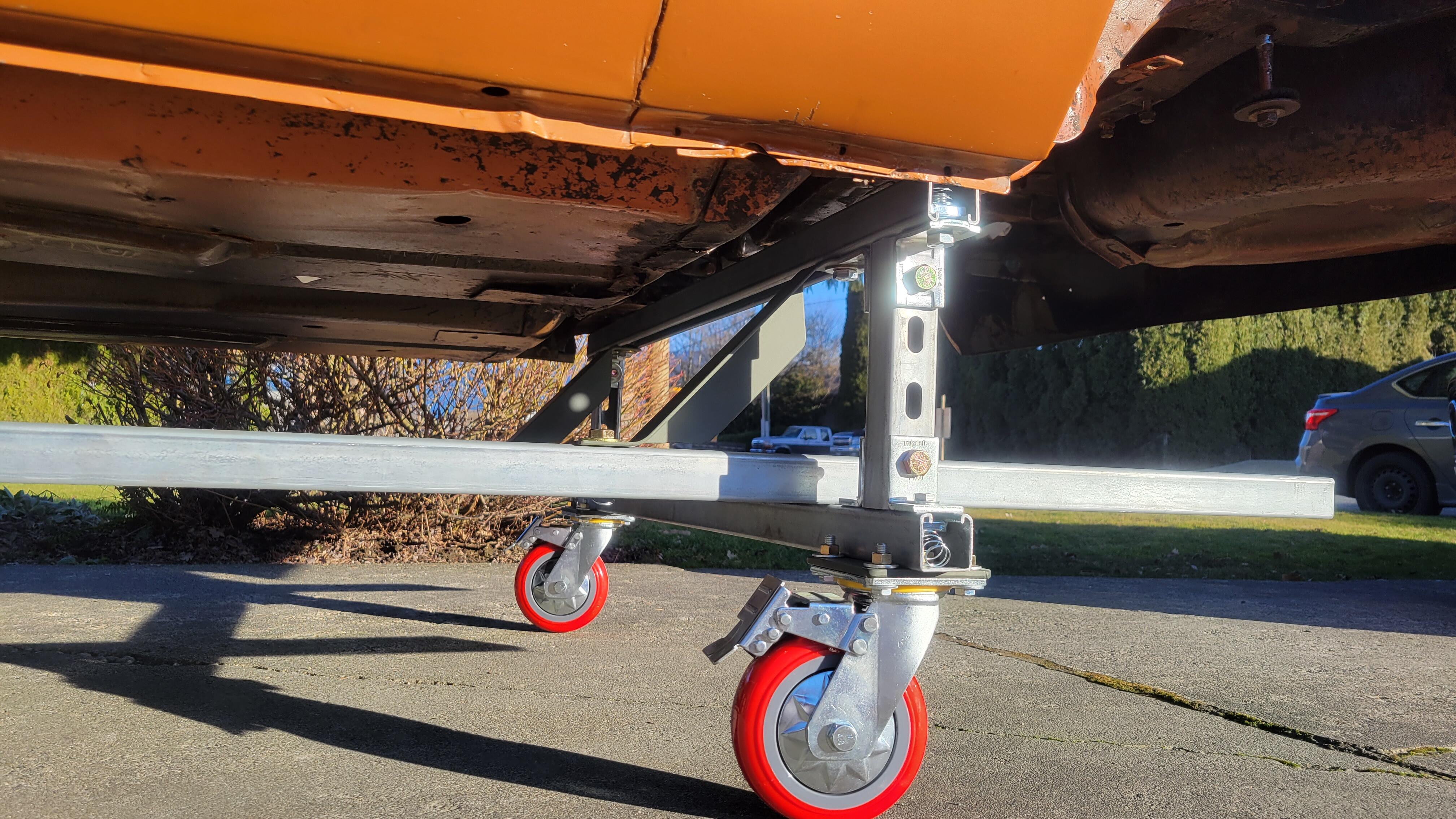

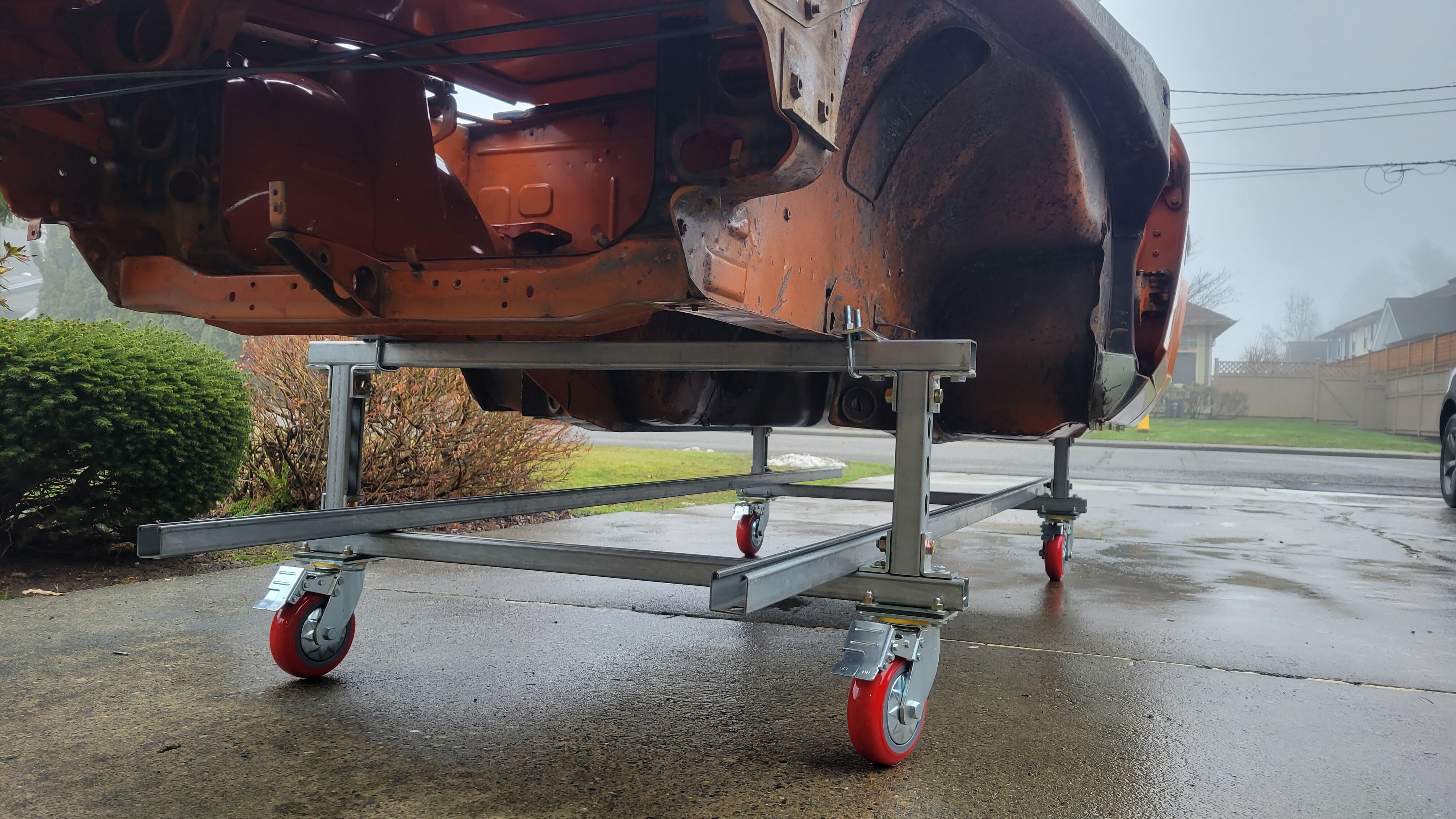

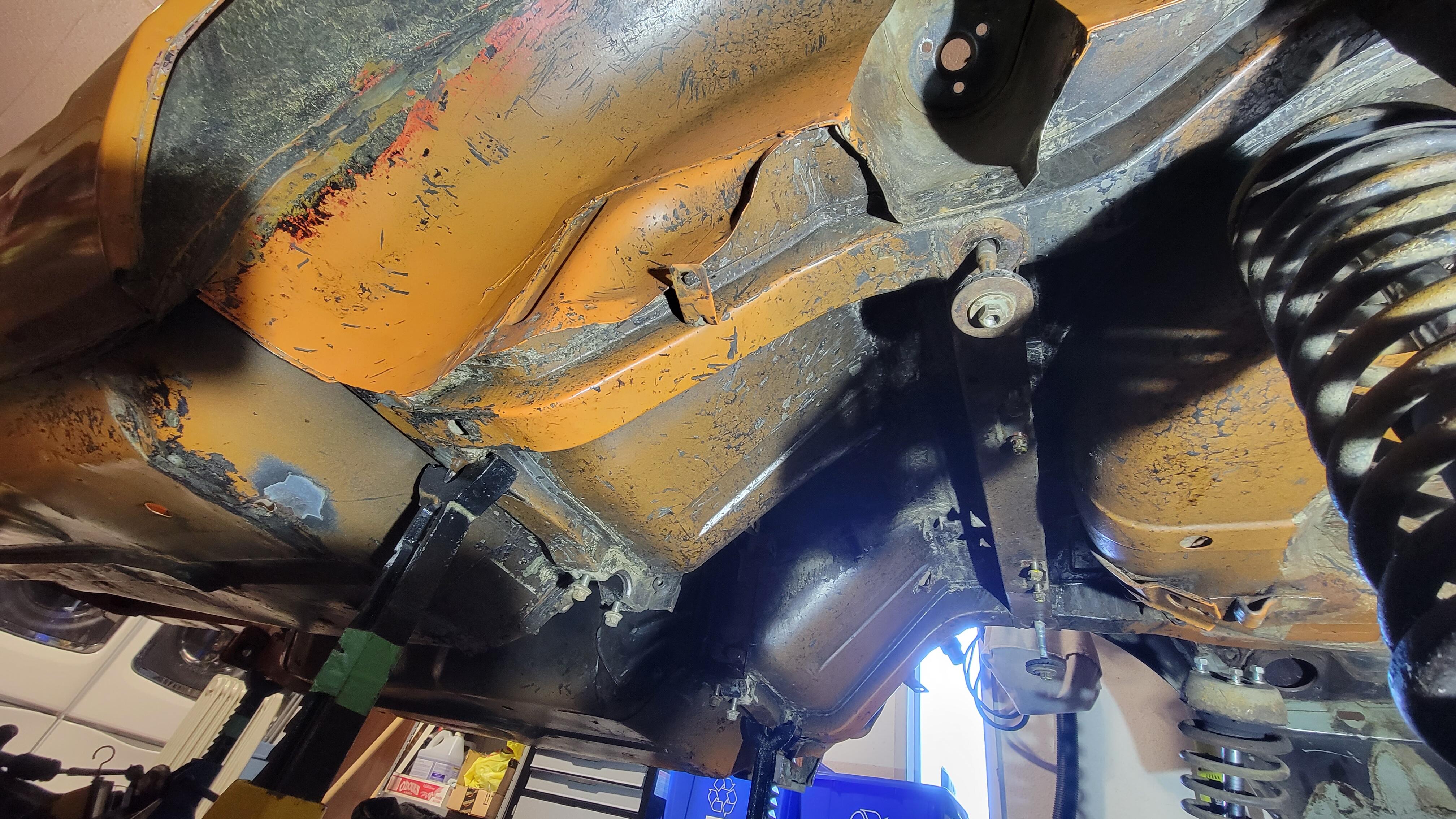

Early 240Z's did come from the factory with body color paint on the underside. Most in my area got dealer applied black undercoating of some type. My 7/70 car #6521 got the very thick tar like undercoating which I have removed during my restoration exposing original 918 orange paint throughout. On my car I found that under the 918 paint the front wheel wells and the transmission tunnel, front to rear, plus between and including the underfloor frame rails, got a very heavy dark charcoal grey primer. The top coat of paint in these areas is very thin and the dark grey color shows through, especially in the transmission tunnel. The area under the floors and the rear wheel wells had a lighter blueish grey primer and the top orange coat was much closer to the upper exposed surfaces. Here are some pics of mine.
