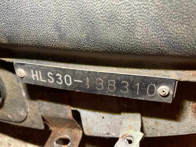

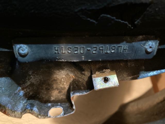

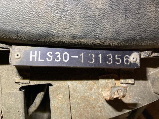

28 minutes ago, Terrapin Z said:
From my collection, pics of 73 240's 6 digit vin plates, and a 75-76 280 which is embossed not engraved.
It looks like a 280 washer bottle too. There is no mount surface for the ID plate. Odd
138310 is a re vin'ed 70 as a 73 rivets show the re tag

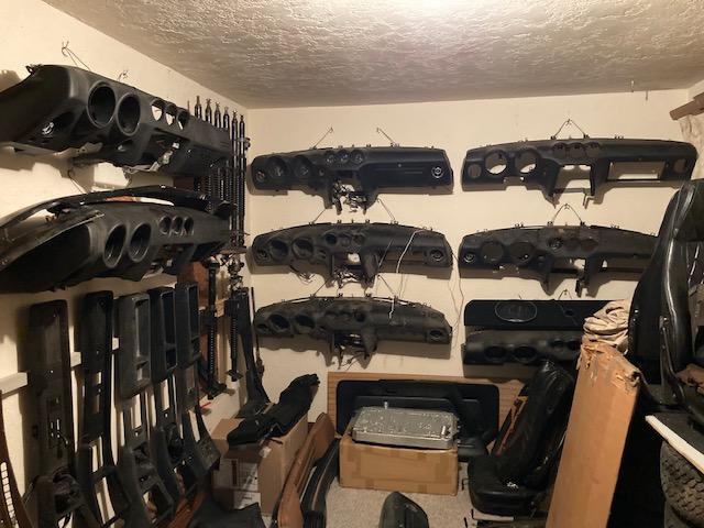

See, I thought I had a problem because I have SO many Datsun parts...
I am so relieved now! ROFLROFL

Wow. OK, so now it has moved from "clearly wrong" into "illegal". I believe it's exactly as you suggested... Someone decided they would rather own a 72 than a 76, so they took the plates off a 76 and stuck the 72 plates on in their place. That 72 dash plate clearly does not fit in the spot in the dash.
So what is there to do if the VIN on the firewall DOES somehow match the VIN on the dash and door jamb? Based on the work someone put into the fraud, I suspect the firewall WILL match. At this point, t would seem unlikely to me that someone going to that level of thoroughness would not have left the firewall unmolested. I bet they cut out the original VIN area and welded the other one in instead? Or maybe they just welded over it?
Woof. Comes back to the philosophical question of "So what is it that 'defines' a car?"
Ha Ha, I just put this room together, not a problem if you have the space for it. All a worthy cause. I could collect Magic the Gathering cards.....Not 💤
