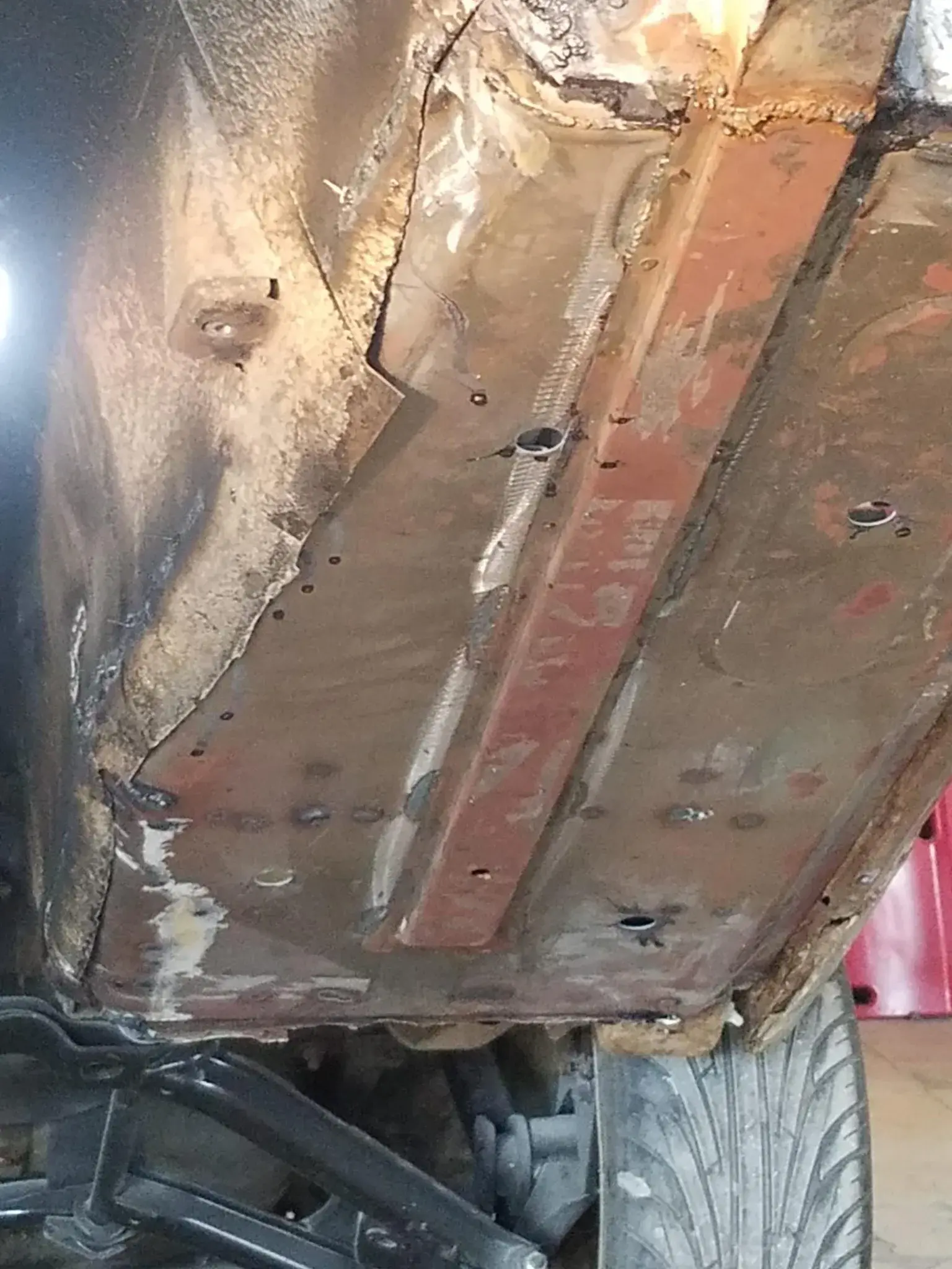

First - the body he started with was way to far gone for that shop to handle. Lots and lots of rust damage everywhere, but few pictures showing how it was “all” addressed. My fear would have been a lot of bondo filling small holes everywhere.
Second the killer was the quality of the metal work done on the floor pan replacement.  Pictures 812, 813, 815…  That shop really did not know what they were doing,  I wouldn’t touch that car...

I didn't see those pictures!  I actually quit looking at the car when I saw the seats and vinyl work.  Now that I'm looking at "full disclosure", I can understand.  That guy was upside down in the car.  That's why he wanted so much for it.  The disclosure didn't kill the sale.  He did.  He should have taken the money and run.
