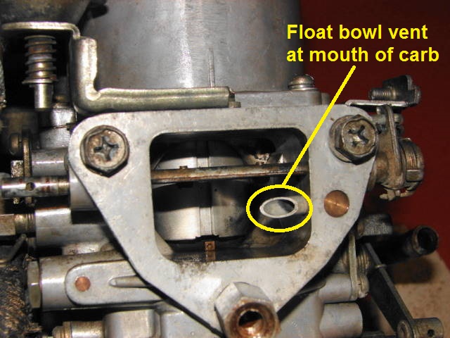

On 12/9/2022 at 11:21 PM, zspert said:
The 1969-1972 240s vented the carb float bowls into the atmosphere through the air filter housing. The 73s and 74s couldn't do that anymore because of tightened emissions regulations. Those years vented the float bowl, now mounted in a confined and hot space,  directly into the venturi. Now you had hot fuel vapors, unmetered, entering the venturi resulting in a very rich condition and LOUSY performance.
I do, however, want to suggest that the bowl vents do not exit into the venturi, but in fact vent to the surface where the air cleaner bolts to the carbs. It essentially vents to the clean side of the air cleaner just like the round tops do. It's piped in upstream of the reduced area (the venturi section) of the carb.
Here's a pic detailing the bowl vent, and the venturi is located a couple inches away at the bottom center of the piston.:

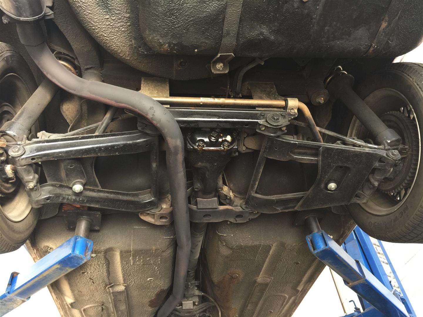

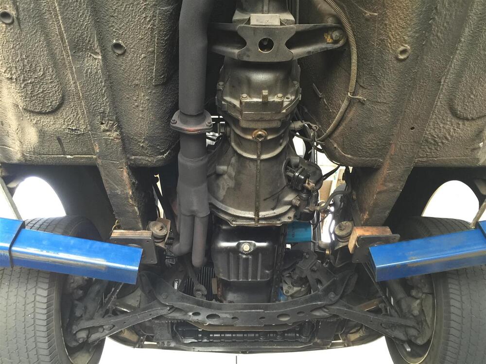

On 12/11/2022 at 1:42 AM, gundee said:
That is the correct position to put a Z on a lift.
There is no other way.
Its better like this, the front could be acceptable ,but the further you go under the floorboard, weaker it gets. Some wood under it would be MUCH better.
The floors are a weak point sadly so many people put a jack under there in the early days pushing the floors in.
