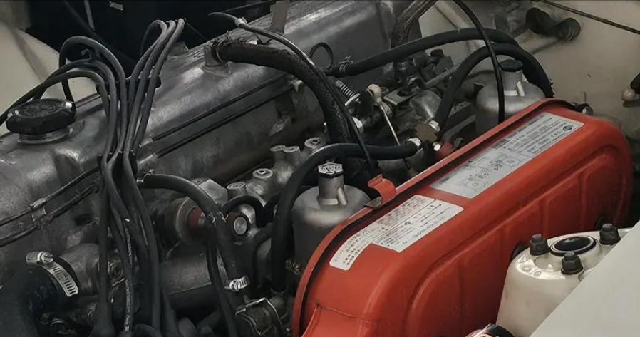

Very clean car but shouldn't it have flat-tops?
I think that there's a long discussion on the forum somewhere about switching to round tops, and when it often happens.  Not sure.  I'm definitely not a carb guy.  The text says that they were rebuilt.
"Service in 2023 is said to have included rebuilding the carburetors, replacing the ignition switch and spark plug wires, flushing the fuel and cooling systems, and performing a valve adjustment and an oil change."
If one wanted to keep it perfectly "as it left the factory”;  yes it would have the Flat Tops. Back in 73/74 if one wanted to drive it in a more reliable fashion, they switched the Flat Top’s out for the SU’s as used on the 70-72 model years.
To comply with the EPA Emission standards for 1973, Nissan had to redesign the original SU’s, the result was what we call the Flat Tops. They passed the emissions tests/standard, but the engines suffered from Percolation and/or Vapor Lock. In higher temp. area’s the cars would just die, or when shut off with a warm engine the cars would not restart until the engine was cold again.

Flat tops, boat anchors. That's what the nomenclature on Z Therapy website is

My general impression has been that the vapor lock problems caused people to make changes.  And swapping to round tops from flat tops was a common change.  Going back to what was known.  Kind of like removing "emmissions junk", or going back to carbs from EFI.  The past always seems more comfortable.
3 hours ago, grannyknot said:
I think @Captain Obvious conclusively proved that wrong.
Not familiar with his work on them. I was to understand that there were no adjustments to get them tuned correctly. They either ran really good at operating temp, but suffered hard starting, or they ran terrible but was easy to start.
I'm not totally sure, but I think there are actually a bunch of adjustments available on flat tops which is what makes them hard to get tuned properly.
